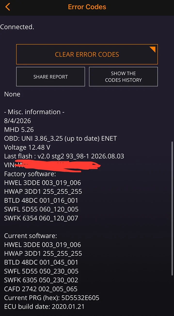

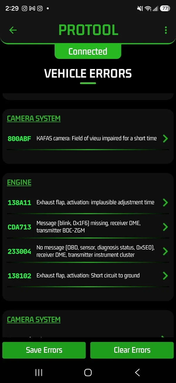

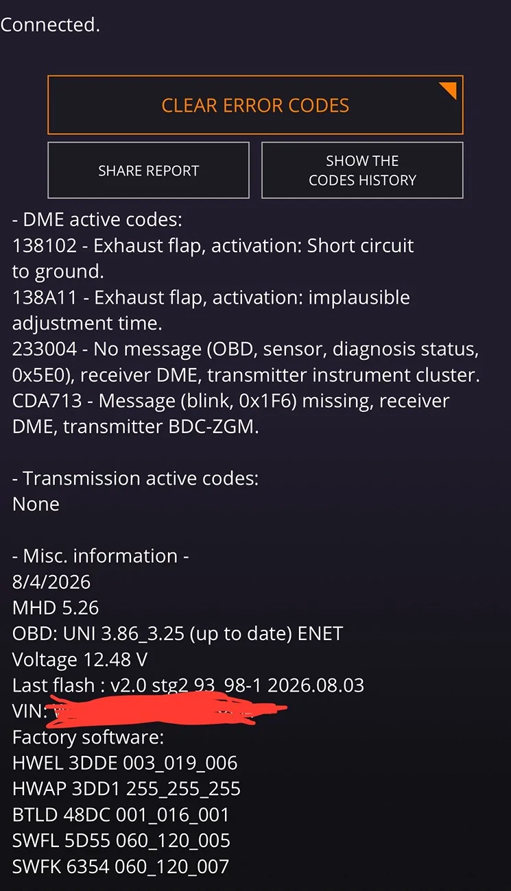

I decided to restore one of my backup DME to my 2020 without the remote start coding. After driving with it a few days with just a 93 map from MHD and no MHD+ features and the exhaust flap staying open 24/7, it wasn't worth the effort to keep it.
My butt dyno felt the car wasn't running properly after the 93 map flash. I've already emailed MHD the screenshots of the codes, etc - I guess they're still looking into it, maybe they will put out a update for it.
These are the codes you will be getting from protools and MHD if you got the remote start coding done. Again, my OEM exhaust flap works normally and these codes were never present before the remote start coding so hopefully bimmer remote figures it out why some of us are experiencing this issue.
The car runs like it should after restoring my backup DME, reflashing MHD+ and XHP, exhaust flap returned back to normal like it should.
