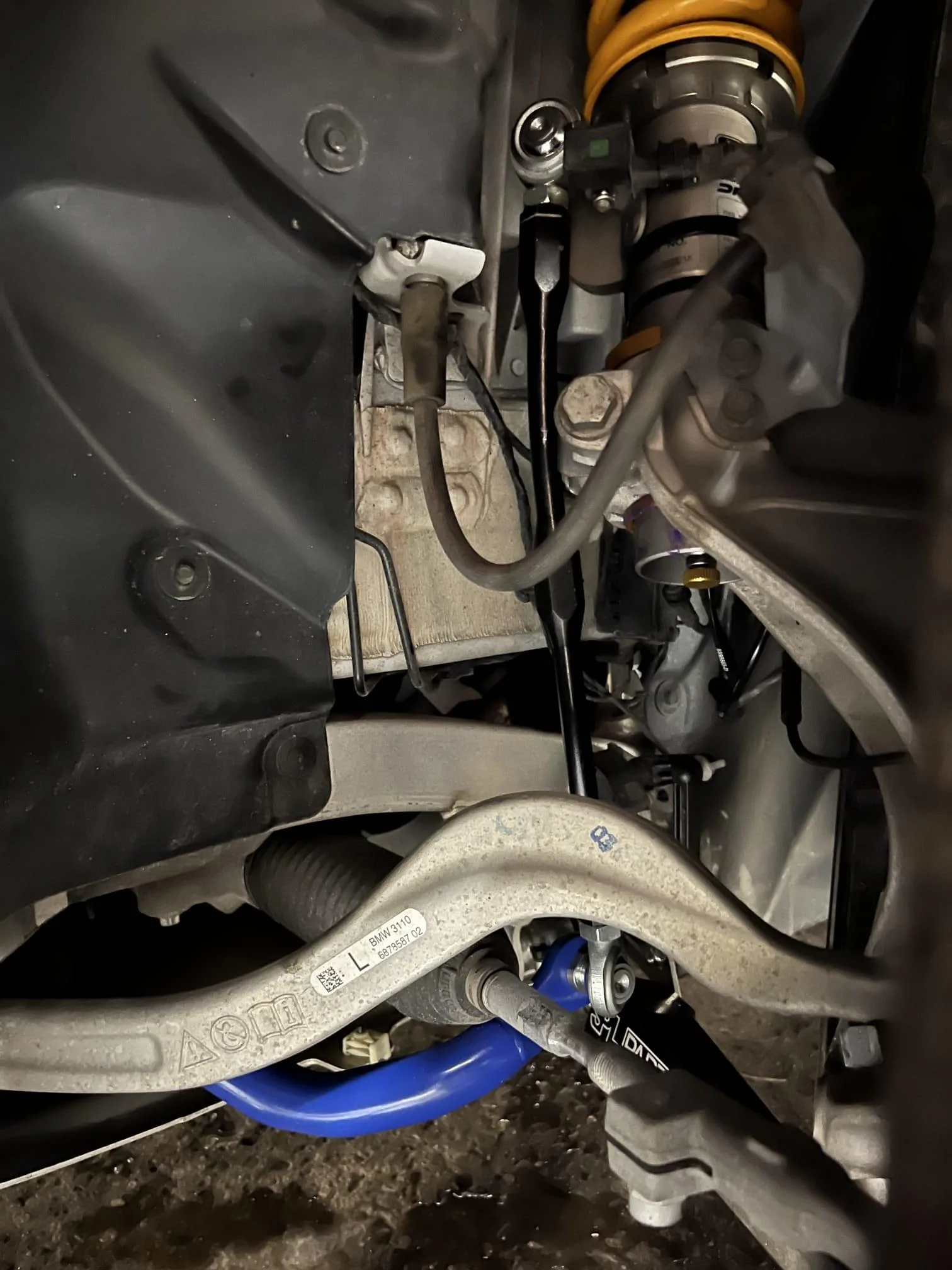

I am going to have to verify this next time I pop a wheel off my car (should be in a few days) but it does look like you need to rotate the shock bodies. Your bracket looks like its sitting at the 12 o'clock position and I believe mine are at the 10 and 2 spots (depending on what side of the car).
The shock body is part of the problem but i installed as per Ohlins requirements. I did have another look the other day and believe if you are using a sway bar link that has a thicker shaft then stock you need to rotate the shock body further around to allow more clearance for the thicker link. Having said this i don't believe it will completely remedy the issue as the adjustable part of the link is just to thick for the elongated "J" shaped mount for the sway bar link. I plan to get under the car again sometime next week to install Front lower control arms and tie rod ends so i will have a better gander then.
Unfortunately im not able to use my SPL links any more as one is very bent now and to get them in Australia is very expensive compared to the US, the shipping bends me over and has its way with me.

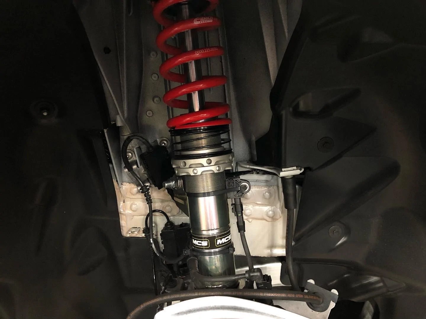

So the picture he sent was actually from me a while back but I do have more pictures if you want to take a look haha. This was before I had helper springs installed. Let me know if you notice anything wrong!
Yes cobber i did use your photo cause im lazy and it showed the same issue but for different reason
cheers bloke for your photography prowess

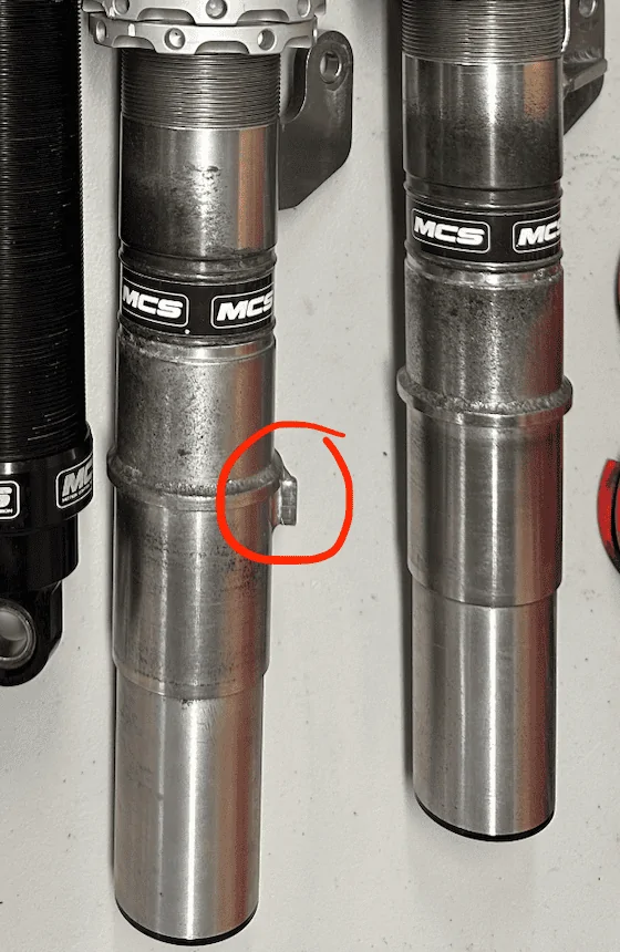

I honestly think the issue is that most people/shops dont really give the clocking a second thought. Yes, it will look fine with the steering wheel straight but with it clocked wrong, they do hit. There is no clocking tab like on the factory struts so it takes a bit of trial and error to get it right, especially with thicker links.
@razorlab do the MCS have a clocking tab? Yours seem to be clocked about the same as mine.
8,776
17,216
Yup, they do. I had no idea the Ohlins do not. This issue makes more sense now.
Yep, I can see a lot of people over looking the clocking step....
Kinda sucks that your cant independently adjust ride height and preload on yours though.
I figured it had to be an install thing. Mine is SPL loaded and no troubles. I was 3-5 seconds faster on track just screwing around having fun. I’m really really enjoying these Ohlins! I don’t doubt MCS superiority btw. They were just so much more expensive. I couldn’t justify it for me ?

The problem is ohlins want you to have the sticker facing the brake callipers so you do that, everything looks good, you put car on the ground and check clearances and it doesn't look to bad but it is very hard to see up into the link shock mount and thats where the issue is if they had a locating lug it would be so much better. If i had my time again i most likely would have gone with MCS but i could not justify the extra cash to the minister of war and finance as it was ohlins cost $5500 AUD. Front sway bar end links landed from US cost about $500 AUD
