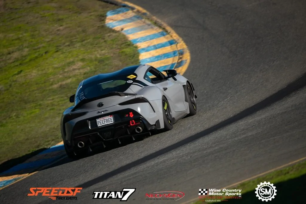

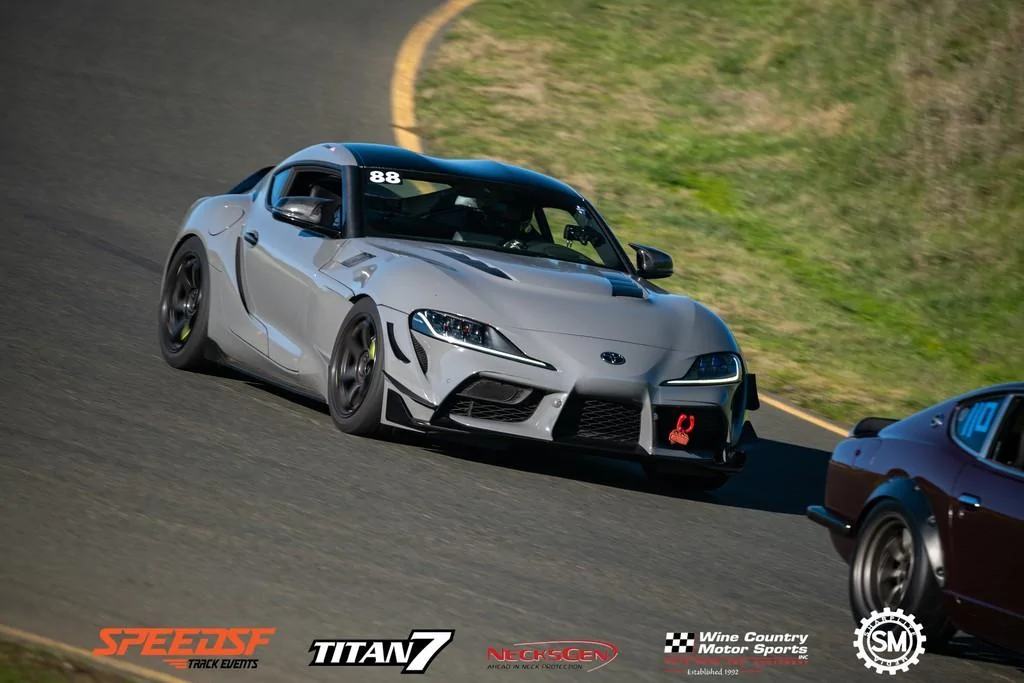

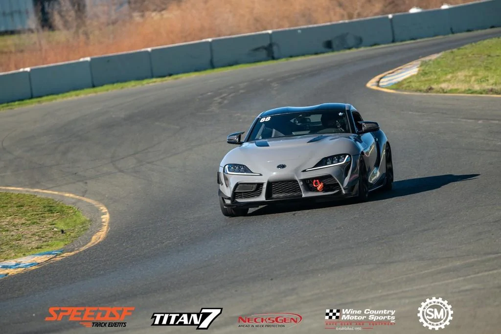

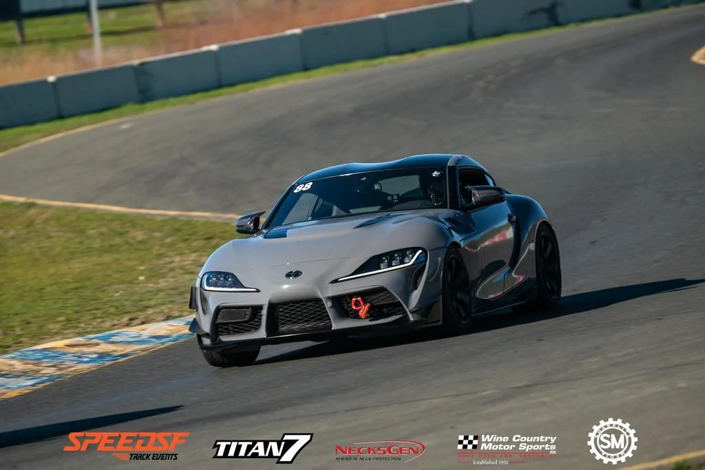

Went to the track on 2/6/2021 at Sonoma Raceway. I was registered in both the OP2 and mixed group. Slow advanced and intermediate respectively. Attended the track day with a few of my buddies (a group of CTR's, a GT4, and another Supra).
The Supra has had nothing done to it since our last outing to T-hill. Tires have about 20 sessions on them beginning of the day and the rotors have almost 6-7 track days. So the consumables were a bit worn. Despite all that, the Supra took it like a champ. Ended up besting my Supra pb by about ~ 4 seconds as we went from a 1.56 to a 1.52.
In it's current state, I think the car has plenty left in it. I'm still adjusting to a RWD platform so it's more about the driver than it is the car. haha.
Next up:
I'm still waiting on the aero to come in from Spage. Once we get that in, we can finally start dialing in the suspension. Also hoping to free up some more time in the coming months to get out there and drive more. Both work and home life has been a bit hectic so it's been a bit hard these days to find time to indulge in hobbies. haha.

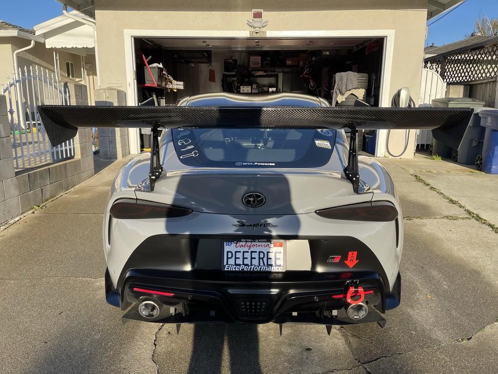

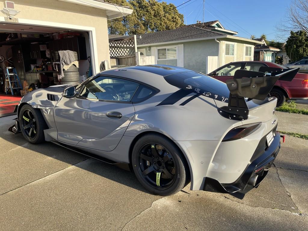

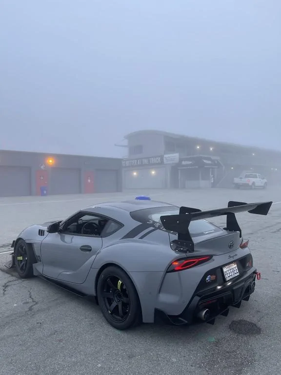

3/29/2021: AT LONG LAST... ANOTHER TRACK DAY - Laguna Seca
Been way too long. What was that? 2 months? Anyways.... FINALLY got to go to another track day. The Lord Almighty knows I needed this one. Way too much work / stress not to go.
Joined in on a Laguna Seca track day hosted by Golden Gate Lotus Club. I ran in both Novice and Advanced.
Since the last track day we've installed:
- Spage Front Lip / Splitter Combo
- Spage Rear Wing
- Stiffened up the rear springs from 850 to 1200
- New alignment
- AP / Essex Racing Rear BBK
- Antigravity H7 60AH battery
Let me again thank the guys at Elite Performance for getting my car ready. You guys are the best. Despite being swamped, you guys made time to make sure to accommodate my crazy tendencies and I. Thank you thank you thank you.
Also shout out to Jackie Ding for helping my clueless ass on this build. Your assistance has been instrumental.
Ok. Here we go:

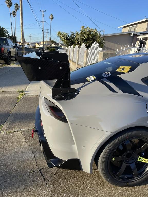

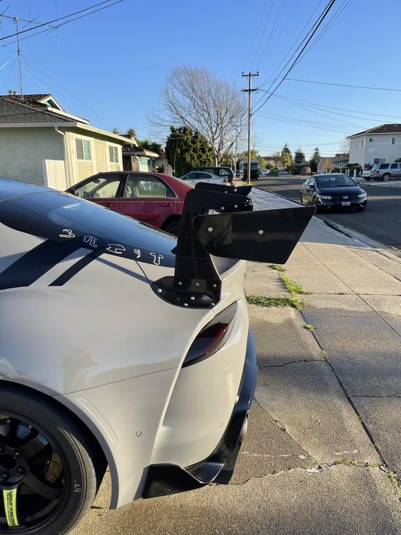

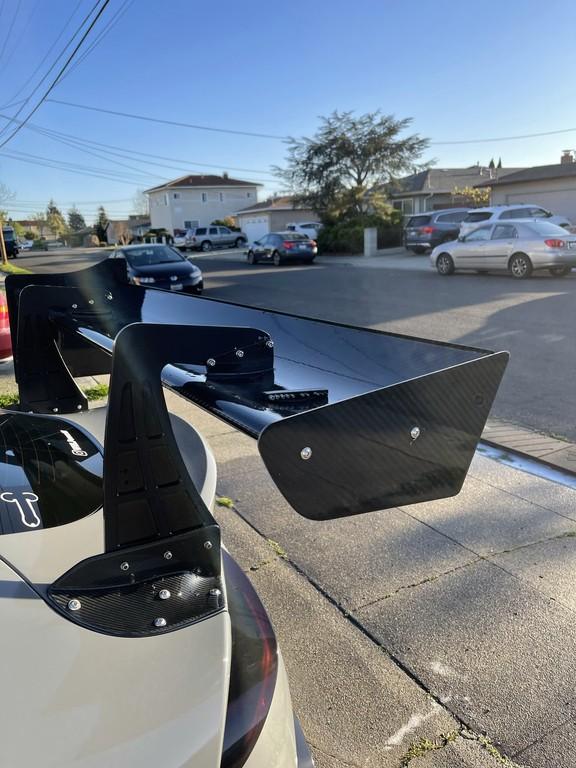

1. Spage Aero - The wait was a bit long. I ordered this aero package from Spage back in October I think...? So it took about 5-6 months from ordering to receiving the product. All in all, I guess it wasn't bad considering the swan neck from Voltex is backordered for a year. Product is totally worth it though. Completely transforms the drive ability of this car and the quality of the product is amazing. My mechanic and friends were totally blown away.
I couldn't even get the car to spin. In fact the only place it got loose a bit was on Turn 2 during the slow-medium speed turns (where aero doesn't have an affect). Just completely planted throughout the course.
Completely in love with this car now.
Note: These pictures of the wing is with the "street" style end plates. For the track ones, please refer to Jackie Ding's build.
2. AP Racing Rear BBK - If you guys are thinking about just doing the front brakes, I implore you to add the rear as well. Before we added the rear bbk, the car would get all jittery after a couple of hard braking points. I suspect this was due to the fact that only changing the front BBK messed up the brake bias of the car.
Well, that problem is no more. Was smashing on it all day and the car just braked harder and harder. It seems that by adding the rear BBK, balance has been restored.

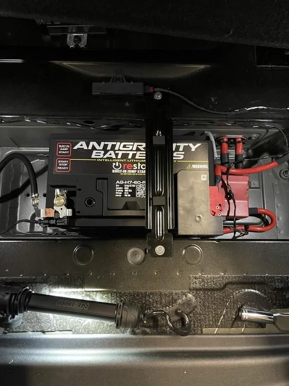

3. Antigravity H7 60 AH battery - More than 40 lbs savings? F*** yes. Kind of a no brainer to do this mod because we all know what a pig our cars are. Add in the fact that it has a restart function built into the battery and it's just perfect.
Important note though: It's been brought to my attention that switching the battery to an aftermarket one would need some kind of reprogramming. I still haven't figured out how to do this but the car drove fine without the reprogramming.

You keeping the spoiler a decklid mount or will you also try for a chassis mounting solution like Jackie?
ipeefreely
ipeefreely
Will
Mar 5, 2019
214
292
Alameda, CA
2021 Toyota Supra, 2021 Toyota Sienna
We're going to keep it a deck lid. The chassis mount isn't necessary if you use both "layers" of the trunk to hold the wing. Jackie cut away a layer so his wing needs the chassis reinforcement.
Nor cal tracks are also not as fast. Our straights are fairly short.
