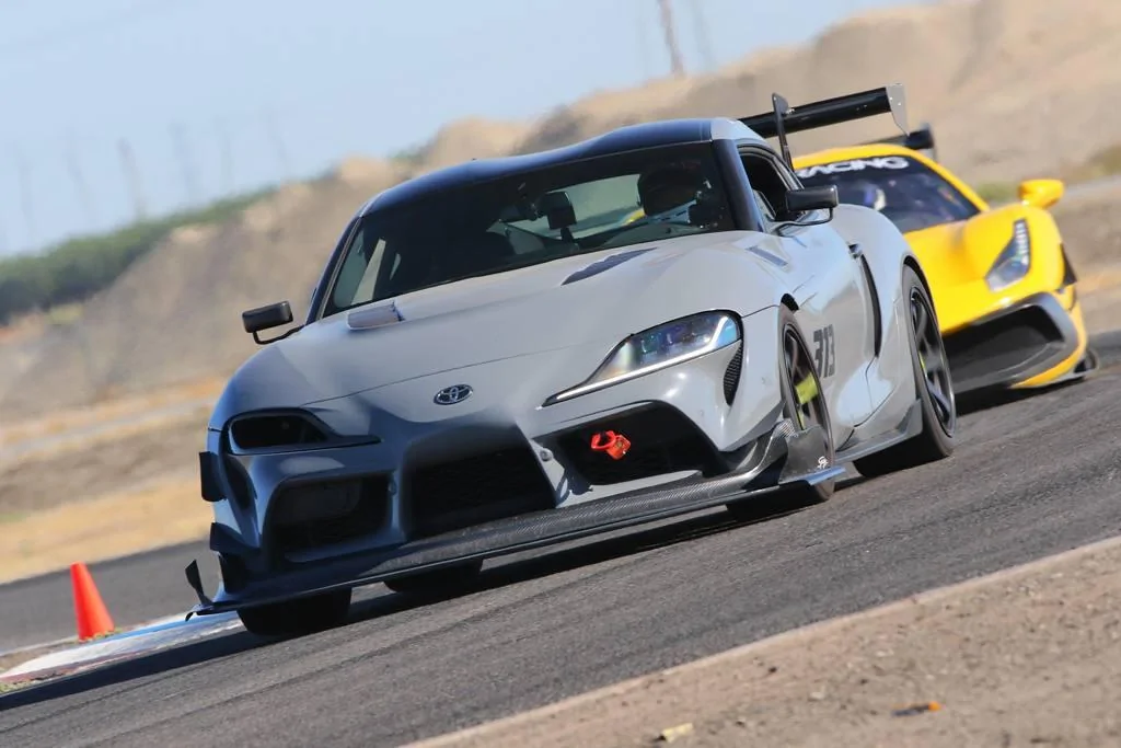

7/6/2021 - Just an update...
So I have once again been swamped with work.... What's new right? *sigh*
On the bright side, the Supra has been hitting track days almost every weekend since March.
Earlier this year, my friend had blown out the diff on his S2k so he's been taking my Supra out to random track events. He's a much better driver than me and it's honestly been a benefit to both of us that he takes my car out to these track days. This way, he's got a car to track and I've got someone to dial the car in for me.
Although the car looks basically the same, we've made some pretty big adjustments. With the PHD x Spage aero package, the car has a huge tendency to understeer. We've been able to mitigate most of the understeer by playing around with the spring rates and switching out the rear sway bar. This is on top of adjusting the wing angle to be at its least aggressive setting.
With things being dialed in more, we've been able to make some pretty good headway in lap times.
Beginning with laguna back in April, we did a 1.36 (which was about a 2-3 second drop from our previous best):
Next up, the car did a 1.45 at Sonoma. This was about a 5 sec improvement from our previous pb.

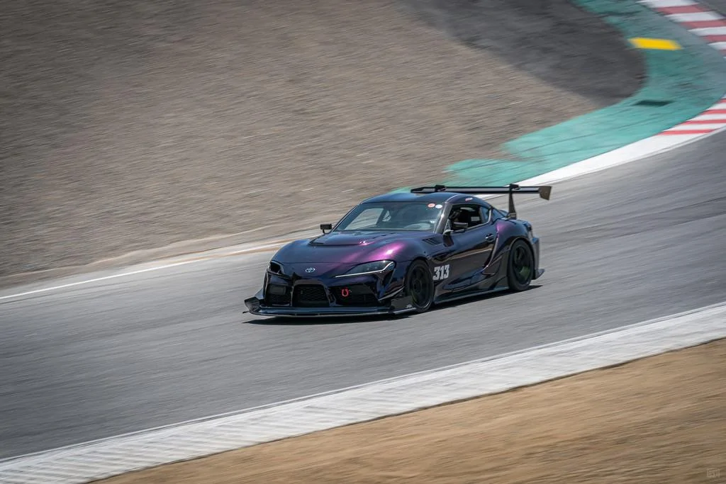

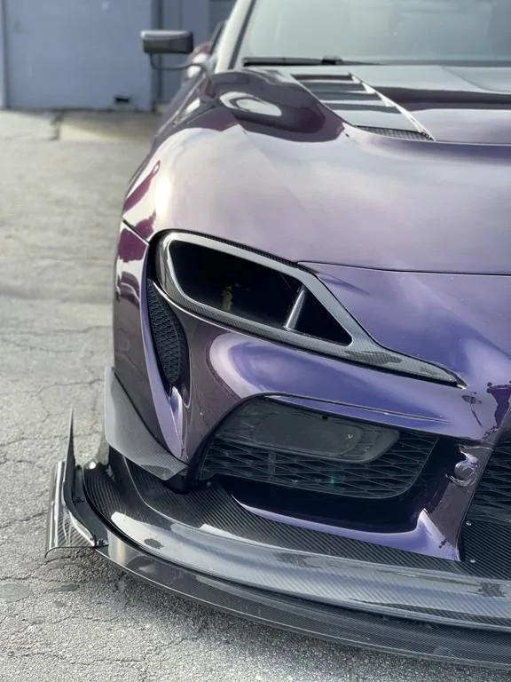

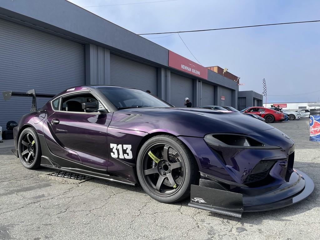

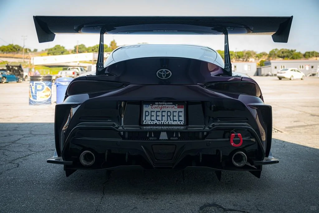

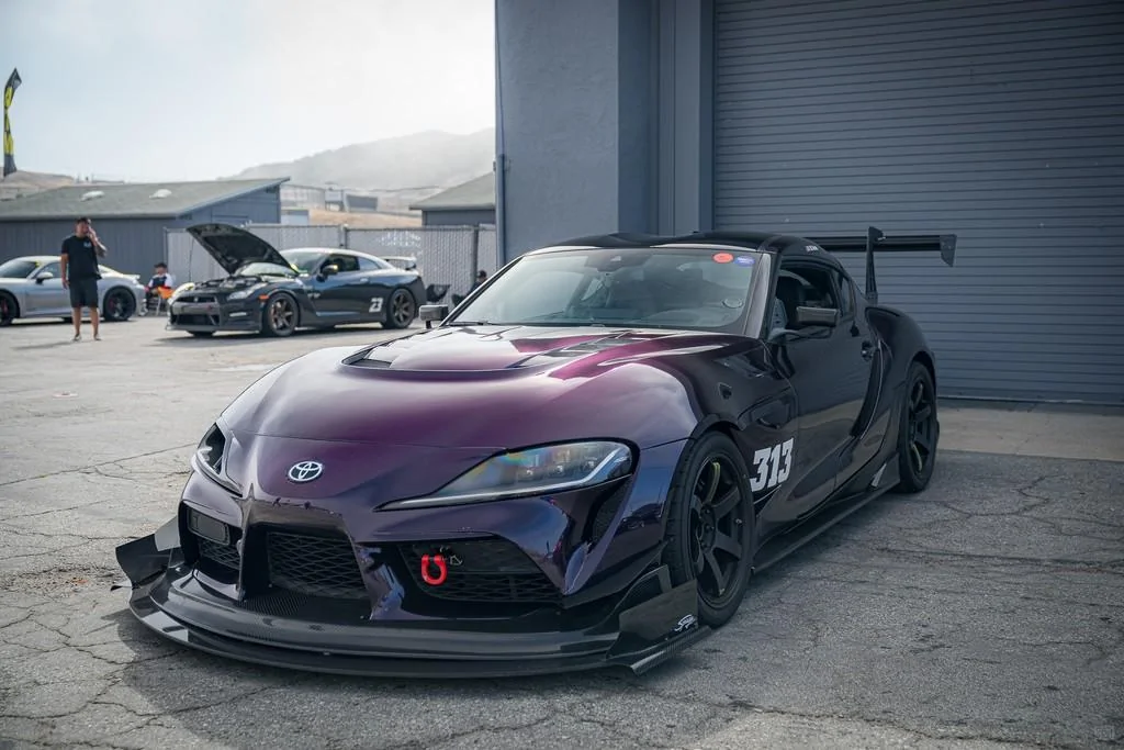

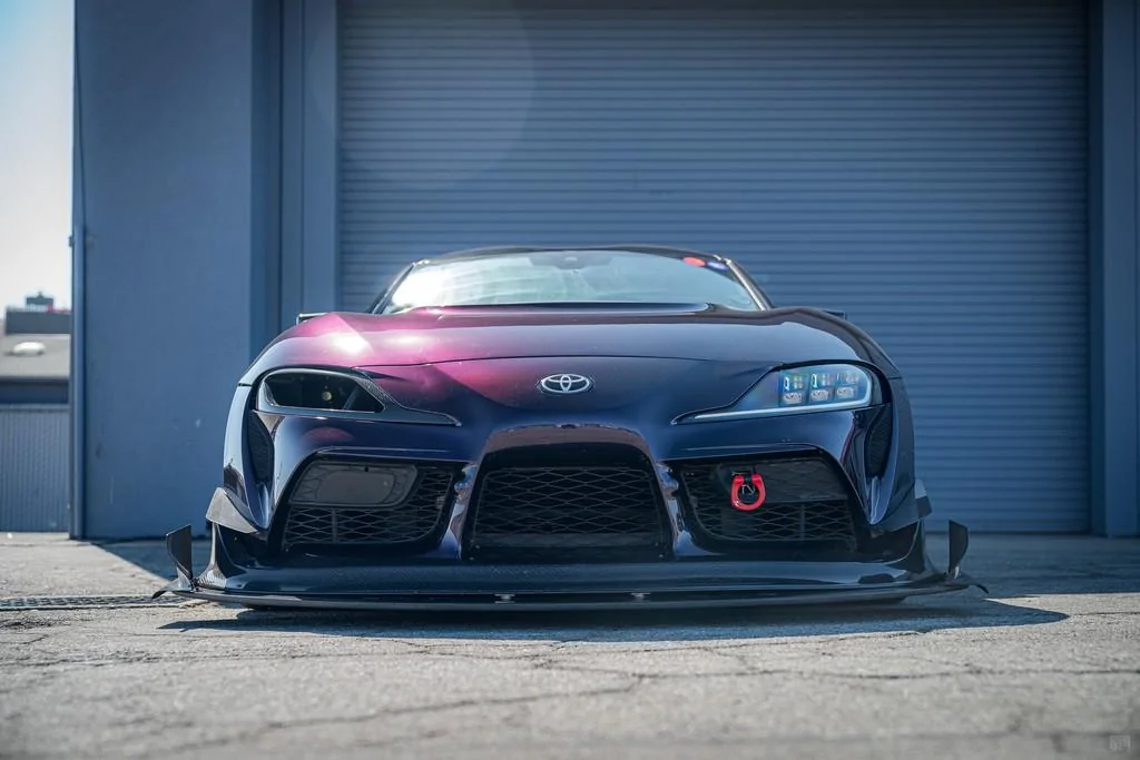

7/21/2021:
Spent the last 5 days unwrapping and rewrapping the car.
Just to give a little context here but I never intended to wrap the car grey. Every vehicle I own is some shade some grey and it's honestly getting quite boring. (I say that but I assure you another grey colored car is in my future)
So when the opportunity arose for me to wrap it another color, I jumped at it.
I present to you. Midnight purple.
While we were at it, we also installed the INGS+ rear bumper and side valence.
For those of you who might be curious about fitment... The kit actually fit very well. lol. We didn't have to trim anything and it came together quite nicely. Also found out that the verus diffuser fits perfectly between the bumper's side diffusers.
Also thanks gcmak for the pictures!!! haha.

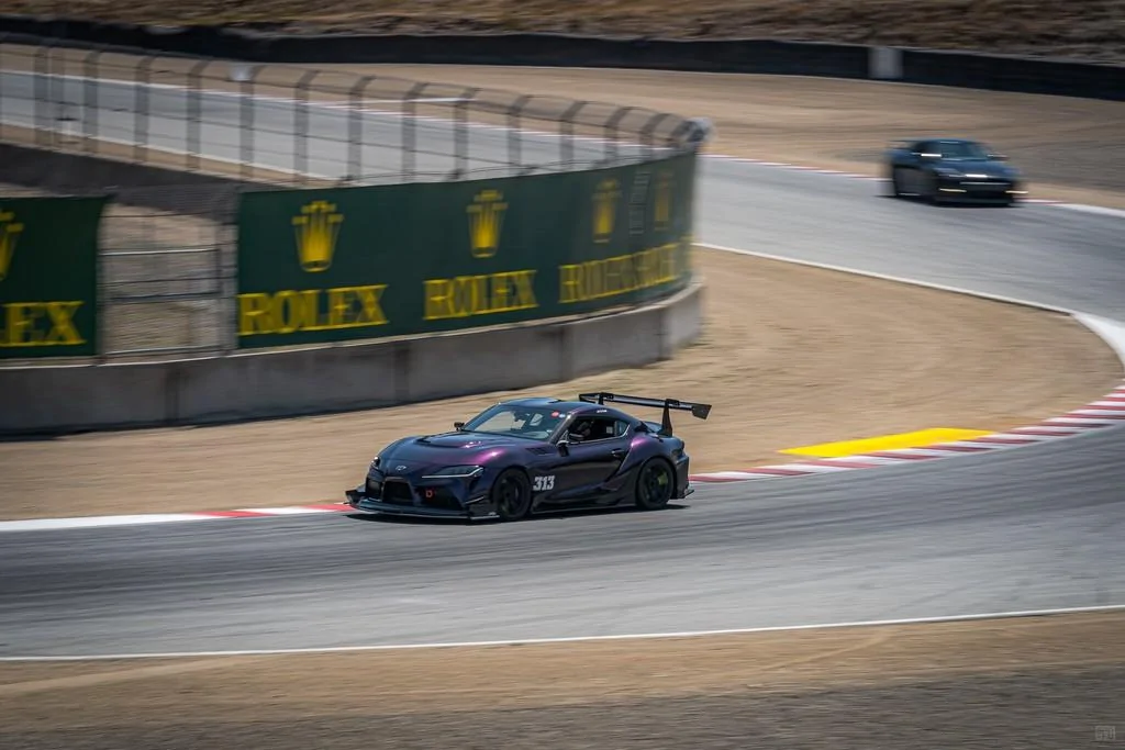

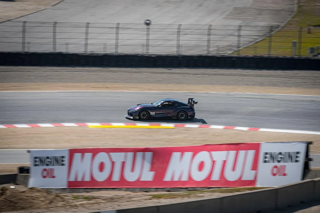

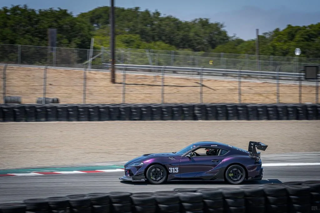

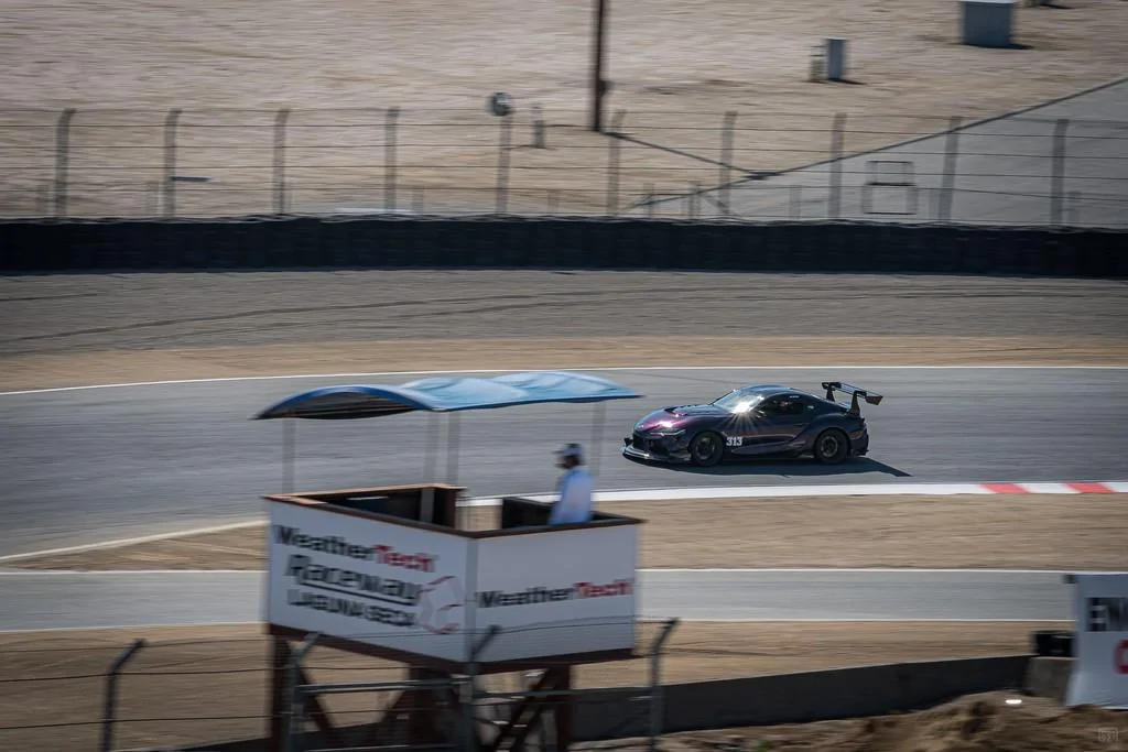

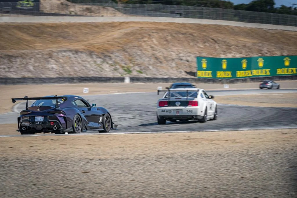

Then we took her to Laguna Seca....
We installed a Jb4 unit but I think it was causing some issues as the car was pulling power quite heavily (and it wasn't even hot). Tried to turn everything off but my stupid app wasn't working. Since we couldn't turn it off via the app, we tried unplugging things but stopped because we couldn't reach one of the connectors. After all that, we plugged everything back in and just ran it in neutered mode.
Ended the day with a 1.40 flat. Quite upsetting as I've been stuck at this time for awhile. The Laguna gods just don't want me to go sub 40's... lol. Till next time I guess...
Are you still running 295/35/18 a052? I need a tire thats not too short but with enough width..
