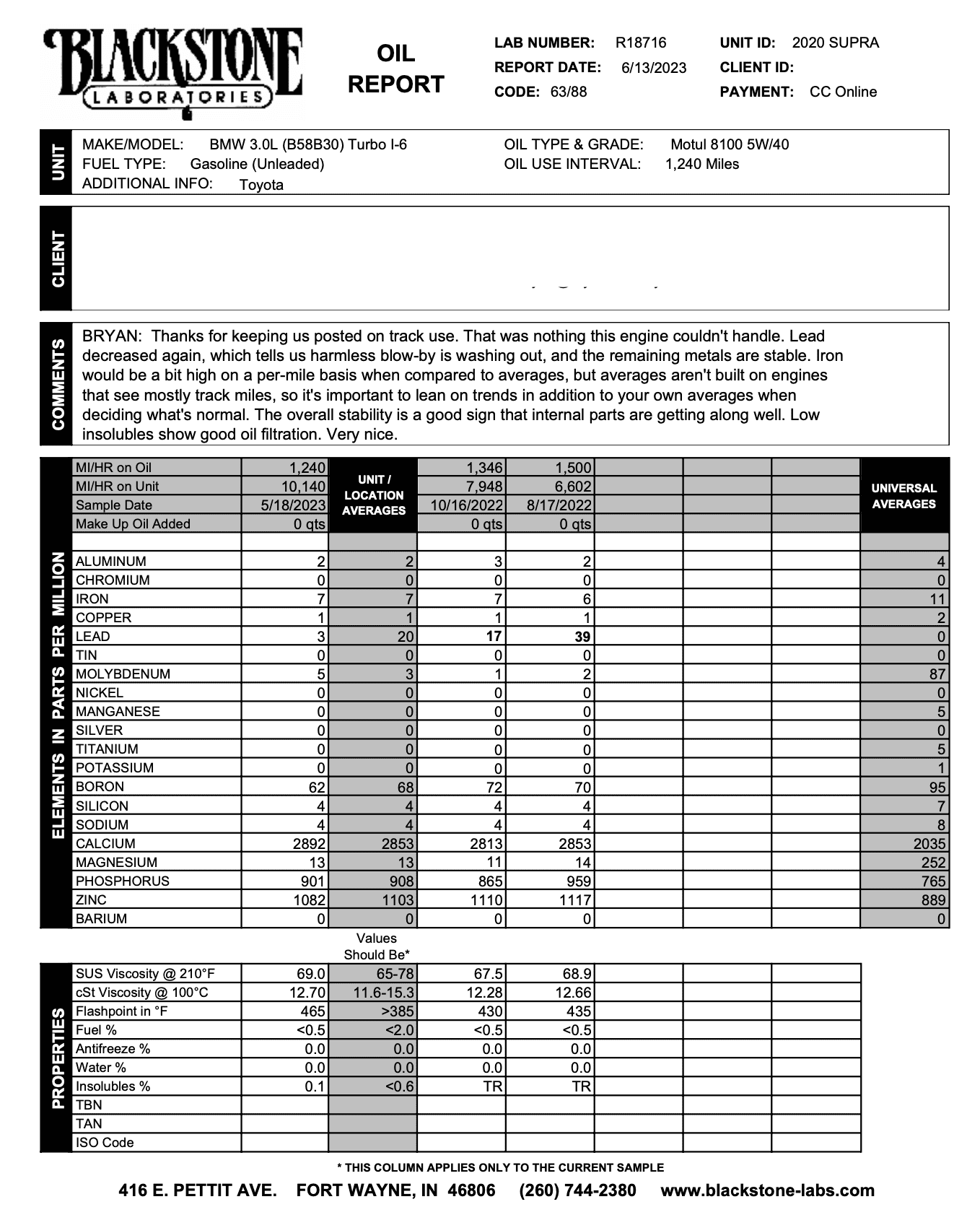

Oil report after 23 track days, the last three of them being with the Pure 700 turbo and tune. 10,140 total miles.
Motul 8100 XCESS 5w/40 since 1500 miles.

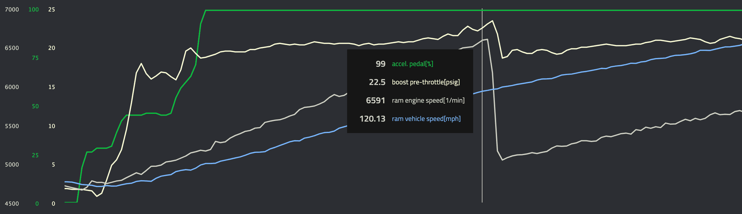

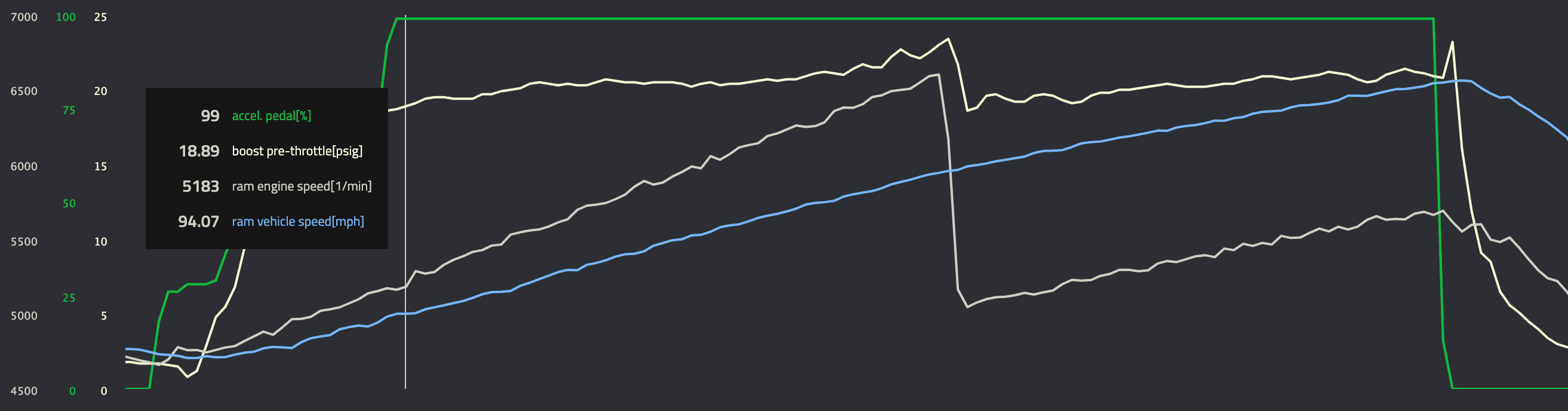

As I mentioned in this post, my power goal with my Supra was to match or surpass a Porsche GT3/RS. Since that post, the tune I ended up with and have been using has a little less horsepower and a little more torque. It's very linear, I am able to go WOT out of corners without traction issues and it has good top end. The car is up approx. 11mph in the straights at both Lime Rock and Palmer.
I got to do a nice acceleration comparison with a 991 Porsche GT3RS last weekend and it looks like my goal has been achieved! The great thing is this turbo isn't even getting pushed, this is still on "low boost"!
