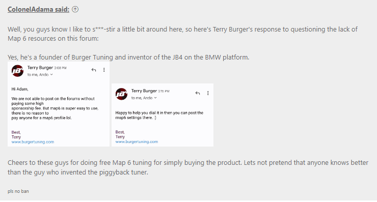

Look man, you know very well that I have referred people to you who have no interest in learning to do it themselves. It's not like I'm trying to take your business, I'm a hobbyist.
My beef is with the lack of knowledge resources to DIY. You are withholding that information from BMS themselves, whereas I am trying to work with them providing feedback so they can help the MT community.

Terry's words, not mine. ?‍♂
You can't seriously believe you understand the JB4 better than its inventor right? You understand the quirks related to this single platform, and withhold that info for an easy buck.
Not sure why I'll even bother sharing because no one is gonna give positive feedback.

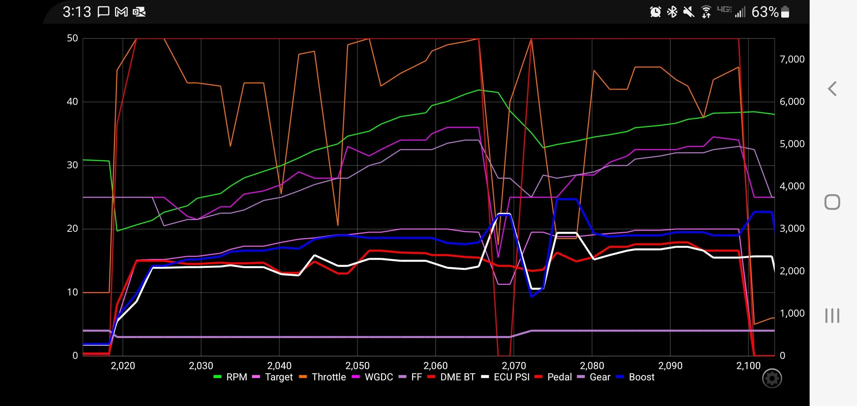

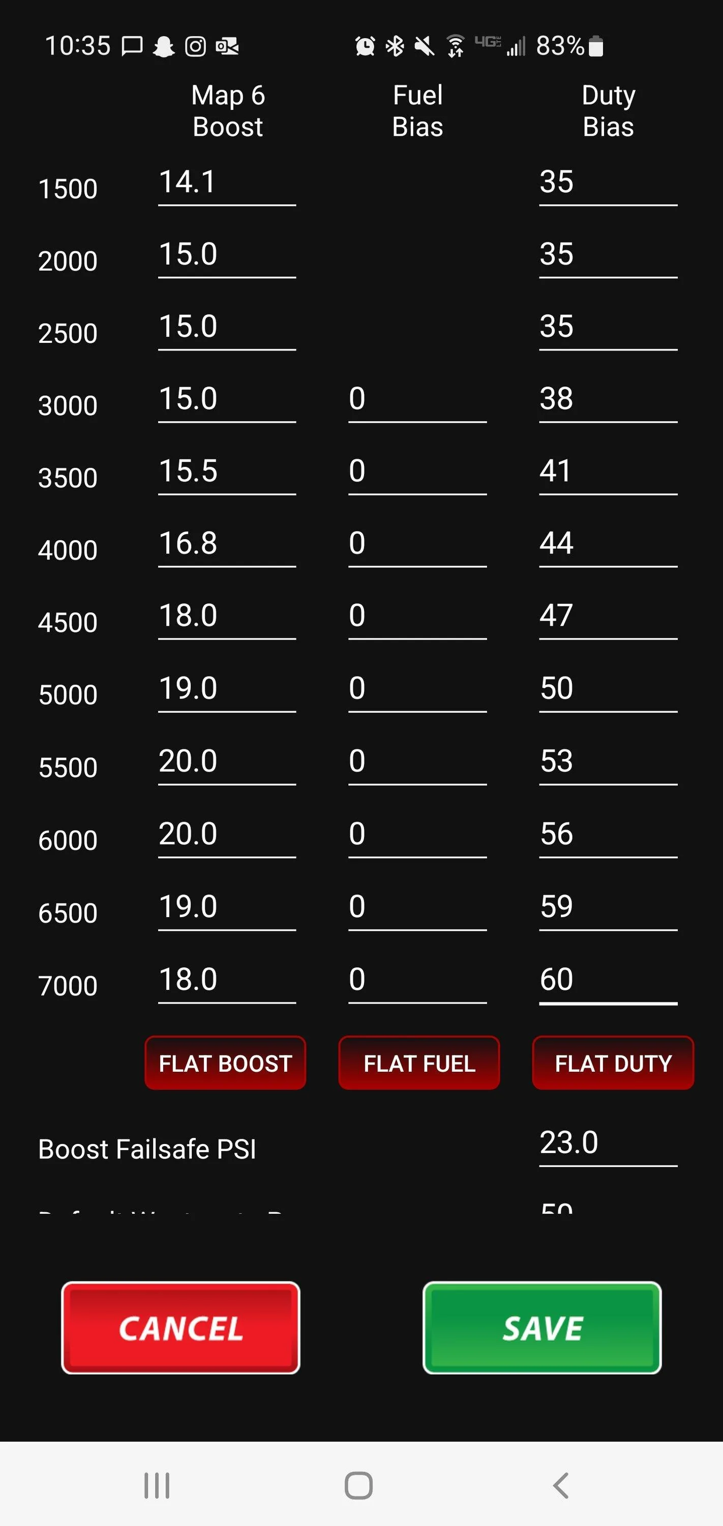

2023 Supra MT Catless/E30 - Low torque map for 93
FF adapted to something like 54. PID = 20
You can see DME_BT dips at 4k causing a WGDC and Throttle drop - current issue working on.
