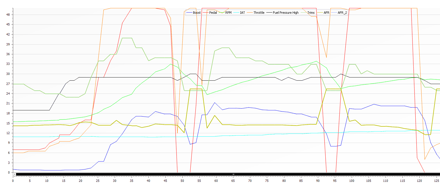

Update: unfortunately, I experience the surging issue again like the JB+. At least I have the JB4 to datalog. It is throttle closing, DME pulling boost. These MT cars really hate added boost under 4500 rpm... At least I can dial down the torque and keep the peak power as is.

Can you post a picture of one of your data log pulls? In graph mode? Curious to see what it's actually doing.
Unfortunately, the throttle was surging again this AM, just like it did with my JB+. Not very happy about that, seeing as yesterday's first JB4 drive was smooth as butter (but so was the JB+)
Here's my log. It definitely needs some work. Remember this is just the previous owner's map 6 - similar to Map 4.
https://datazap.me/u/coloneladama/me-map-6-e30-20psi?log=0&data=1-4-9
I'm not hitting my boost targets, FF is not well matched to WGDC, trims are a bit high (not sure why at only 18-20 psi on 2.5 gal of E), and of course the throttle keeps slamming shut for whatever reason. I wonder if my PID gain is insufficient to modulate the boost and its using throttle to do it instead...
I'm going to turn on wastegate adaptation and see if FF learns up and smooths things out. Sent Terry the data as well to see what he thinks.
I'll also just do a Map 0 log for reference and share later today.
Really starting to think MT cars have an aggressive torque limiter, so I may have to pull some boost below 4.5k.
Ya MTs are nightmares. Let me know when you are ready to get it sorted out. There is not a tq limiter down low ill tell you that much. This goes again with my statement of there will never be a 1 size fits all custom map lol.
Heres one I just finished up last week. 0 Throttle closures (excluding when he has to press clutch to shift) Trims are fine. Hold 18-20 PSI. because its only on 93. I typically will push an MT to 22-23 PSI on a Eblend.
I asked BMS for help with the issues with throttle closures when these first came out but they didnt have an answer at the time. After doing several of these I sorted the issues.
I typically only take on MTs by a case by case basis as these take a lot of work to make happy.
HAVE FUN!
