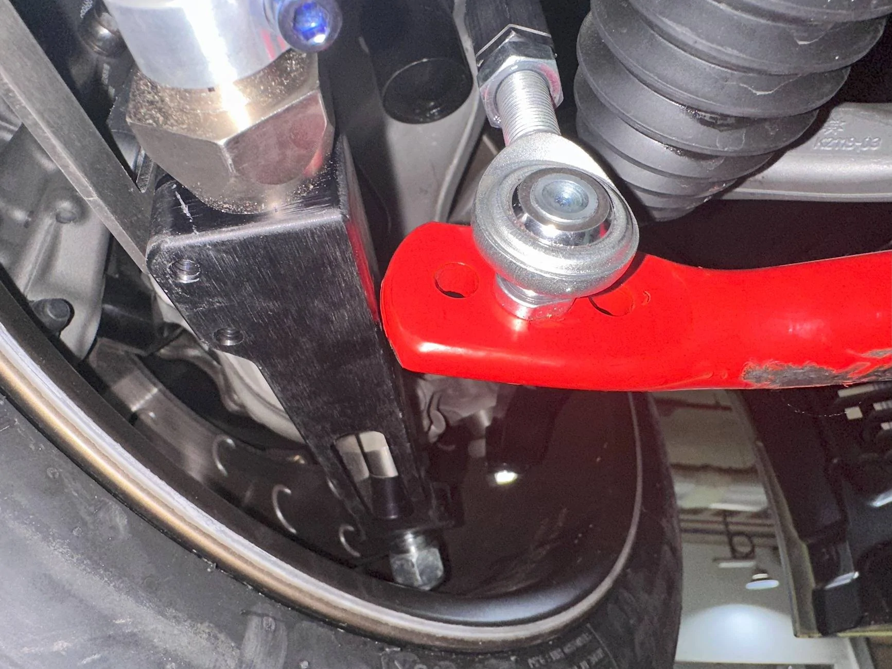

I just finished installing the geometry parts for my supra build , Could someone guide me why the front swaybar is rubbing on the SPL lower control arm ?
That is what they do unfortunatly. You either have to cut off the 3rd hole on the sway bar for clearance or go back to OEM LCA. Verkline LCA has a bit more clearance compared to the SPL LCA's.
Also, be careful with your endlink, you look like you have the threads wayyyyy too far extended.
Take your adjustable end links to full short, then adjust swaybar pre-load to neutral.
