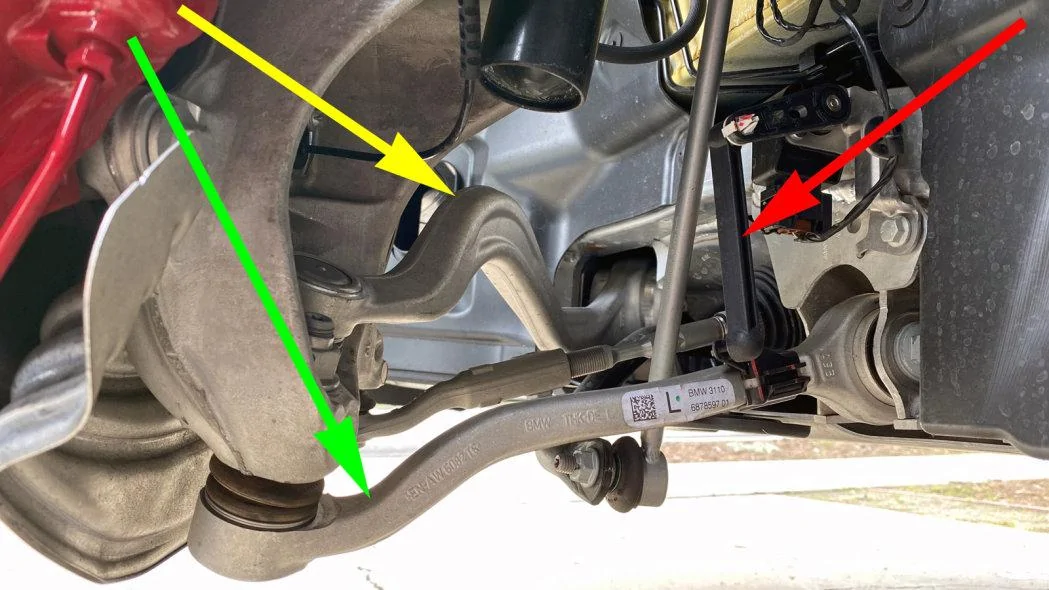

Front LCAs:
The installation was pretty straight forward, nothing jumped out to me as missing from SPL's docs, but I did find that separating the leveling sensor on the driver's side from the stock arm SUCKED ASS. Nothing I did worked, the plastic bracket on the factory LCA snapped almost immediately when I started trying to separate them (no biggie, I wasn't planning on reinstalling the factory arm anyway), and every time I tried to use something to pry or pull the ball out of the socket it just broke more. What finally worked for me was to zip-tie the factory arm to a 13mm wrench for reinforcement with the open end of the wrench positioned carefully to support the opening on the arm while still letting the ball pull free, use a set of locking pliers to grab onto the ball, position the arm behind the strut to hold it steady, and then pull full force on the pliers. When the ball finally pulled out of the arm I tumbled backward into the wall, but it came out and the arm was still in one piece! See the pics below for more clarity.
The new leveling sensor bracket on the SPL arm is kind of janky as well. It doesn't bolt to the arm anymore, instead it just kind of loosely fits over the threaded portion of the arm to hold it in place. It positions the sensor well, I haven't had any error codes yet, but it's very loose and rattles around. I zip-tied it down to keep it still, but I'm curious if anyone else has other suggestions.
Also as many people have pointed out, the clearance between the LCAs and the sway bar is very small. Using adjustable endlinks set as short as they can will help buy some extra room, and in my case I also decided to cut off the 3rd adjustment hole, so now I only have 2-way adjustable front sways. Cutting it off was pretty straight forward, just a hackzall to cut through the center of the hole, then an angle grinder to take off the remaining 1/8" or so and round/smooth it out, then some rustoleum paint to clean it up.
It's impossible to get these set exactly the same as OEM, so just ballpark it and then get an alignment ASAP.
SPL provides multiple spacers to adjust the roll center, but doesn't provide any guidance on how to set it. My car is on HKS adjustables at roughly the default height, so about a 1" drop. I used the thick spacer by itself, so about half of the total adjustment range. I don't have a ton of miles yet on them, but so far so good.

If you look at 21:50 of the youtube video, it shows the ball joint comes right out after he loosens the nut on top. I'm having a hard time following your wrench/ziptie/locking pliers solution. Is there something the video is not showing?
He's working on the LCA/spindle joint at 21:50, that popped right now for me, no issues. The wrench/ziptie madness was for the ride height sensor on the driver's side. It's a little plastic arm and ball, there are no bolts or nuts, you just have to try to pull the ball out of the socket without breaking the plastic arm. It doesn't look like he touches the front driver's side in that video, so the ride height sensor isn't covered there.
You can see it in this picture from the suspension deep dive thread, red arrow:

Front LCAs:

So about that God damn level sensor...??
I ended pulling the whole thing off of my car (2X T25 bolts and a plug) and using the vice on my bench and a vice grip. What a nightmare.
