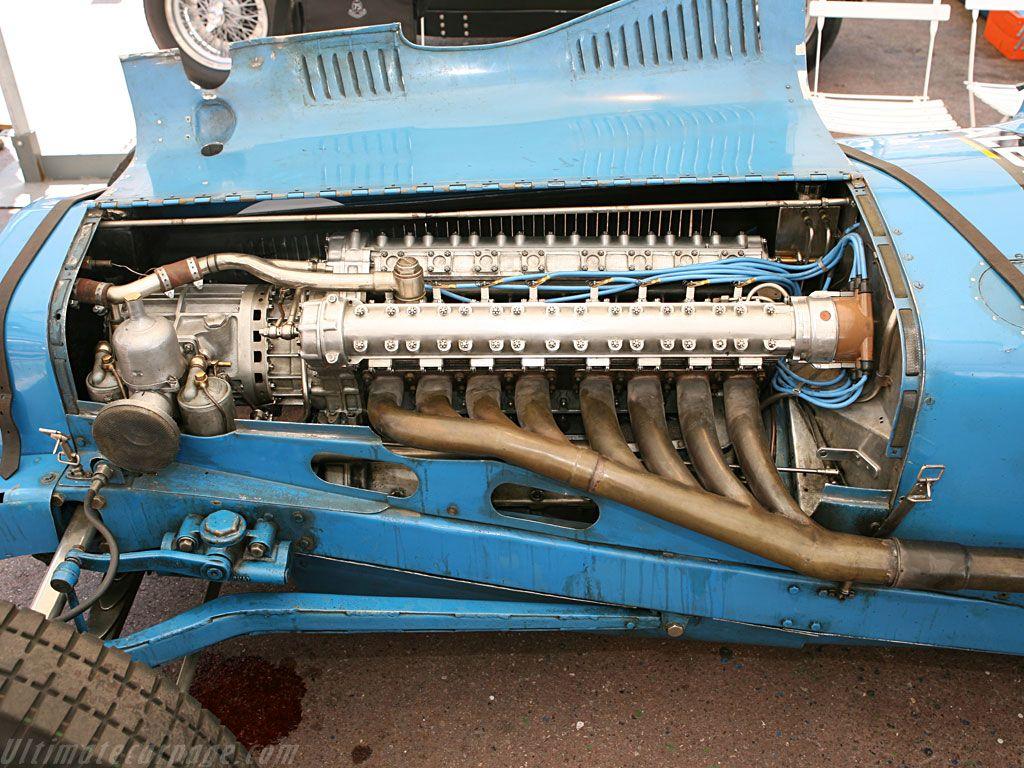

There is a reason why V engines are popular when the cylinder count rises - they are inherently shorter and thus better for front to rear balance. A longitudinally mounted V6 is half the length of a straight 6, which makes it easier to keep the weight of the engine closer to the centre of the car and away from the front or rear wheels (depending on front or rear engined).
Straight engines require a longer wheelbase (typically) to avoid putting the engine over the wheels, which in the case of a front engined car like the Supra, could give it a nose heavy feel. That is not to say it can’t be done - with the right engineering, you can make a straight 6 mid engined still, but it is harder, and by the time you get to 8 or 10 cylinders, it is simply impractical to have them inline in a sportscar. Simply too long. This is part of why so many more modern race engines are Vs rather than inline.
