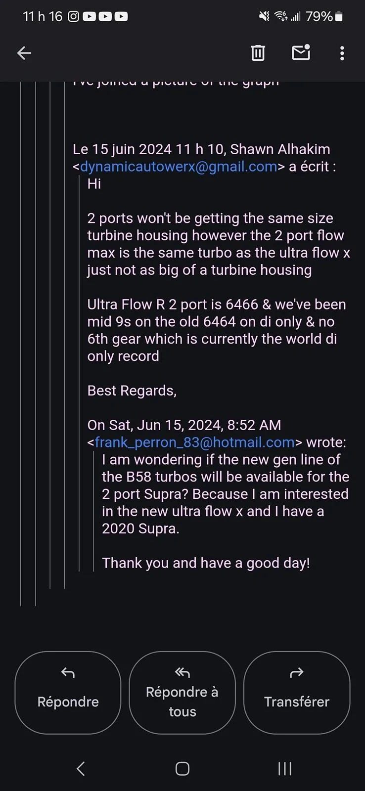

I have a 2 port Supra and I'm hesitating between the Daw flow max and the ultra flow R, I was told that the Ultra flow R is like a 6466. I want to have a 500-530whp car on 93 oct only. I would like to have a turbo that spools close to stock but I don't mind if it takes a little more time than stock to spool. I really want to have top end power and I don't want the power to fall off, I want power until red line and even 7k rpm. I know that the flow max spools really fast but I'm worried that I loose a little bit of power at the top end and I'm worried that the ultra flow R might take a little bit too much time to spool. Which turbo would be better to achieve my goals?

who told you that the ultra flow r is like the 6466?

Shawn from DAW
ok
i understand
its because of the diffrence from 2 to 6 port
i just ordered the new DAW 6466 , 6 port version
like you im looking for good power on 93
i dont care about spool so much, i dont think a few hundred rpm in spool will be noticeable
