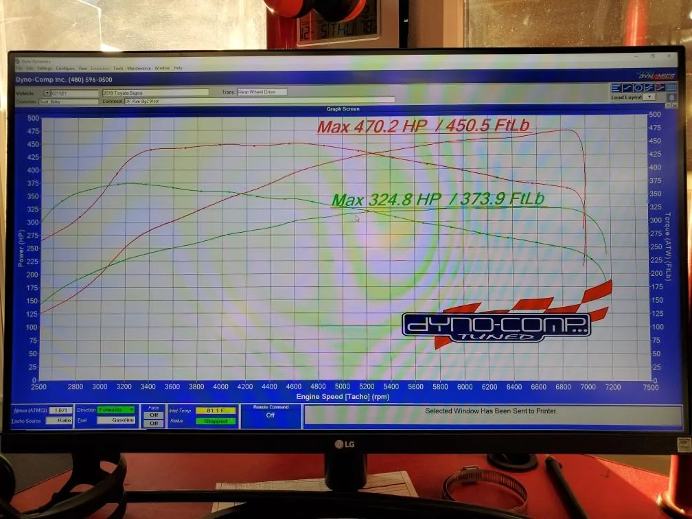

Dyno I made a few weeks back..
522whp 539wtq
Pure800 93 pump gas + 50/50 water meth for cooling + ECUTEK by Payn
Should receive a new improved map with latest Racerom
Jeff Payn made 566whp 585wtq running a Pure700 91 octane only on said updated map
Turbo has been absolutely great so far
