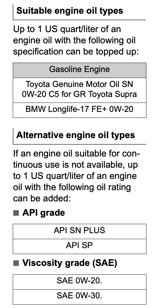

J29DB03
Dec 14, 2021
2,313
4,701
2021 3.0
A heads up, LL-01 is not what is called for in the Supra. You're looking for LL-17FE+. I put a screen shot from the manual in this thread previously.
