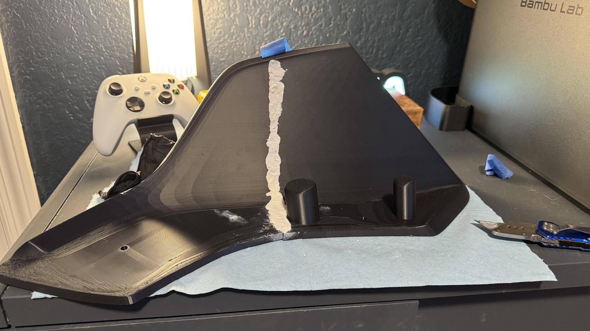

thank you! I printed one side but I have to figure out how to glue the pieces together.
I'm currently trying JB Weld Plastic Weld putty. Granted, I plan to sand it a bit and eventually vinyl wrap the part so any imperfections shouldn't be visible afterwards.
Will updated on how that goes.
