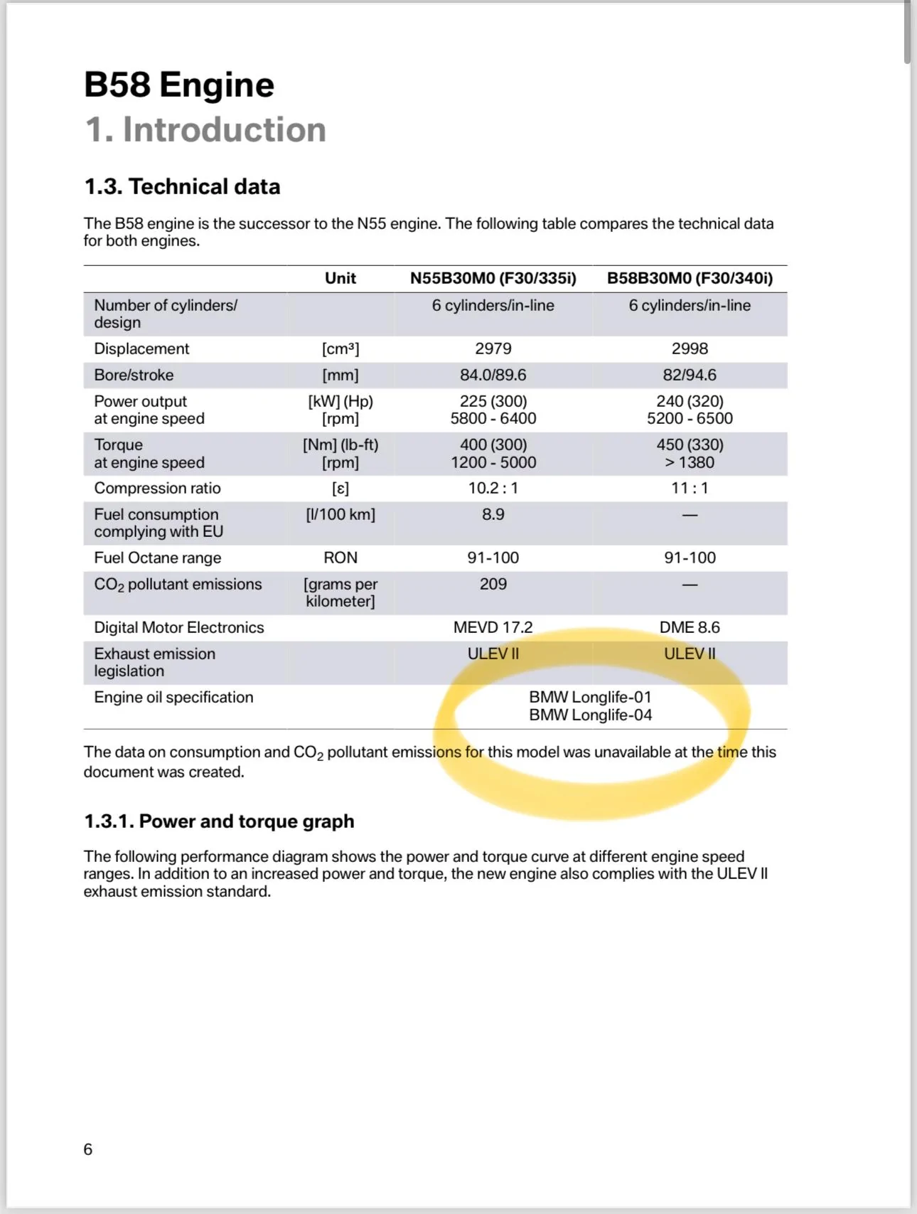

So, my other thoughts on this...We obviously know Toyota states we must use 0w20 in the owners manual, and it's clearly for CAFE reasons. But, using a different oil weight than the recommendation *could* cause warranty issues. Have we ever actually seen an example where someone was denied a warranty claim due to this?
FWIW, this is from the B58 Technical Reference Manual from BMW. It makes no mention of oil weight- just LL-01 or LL-04 approval.
