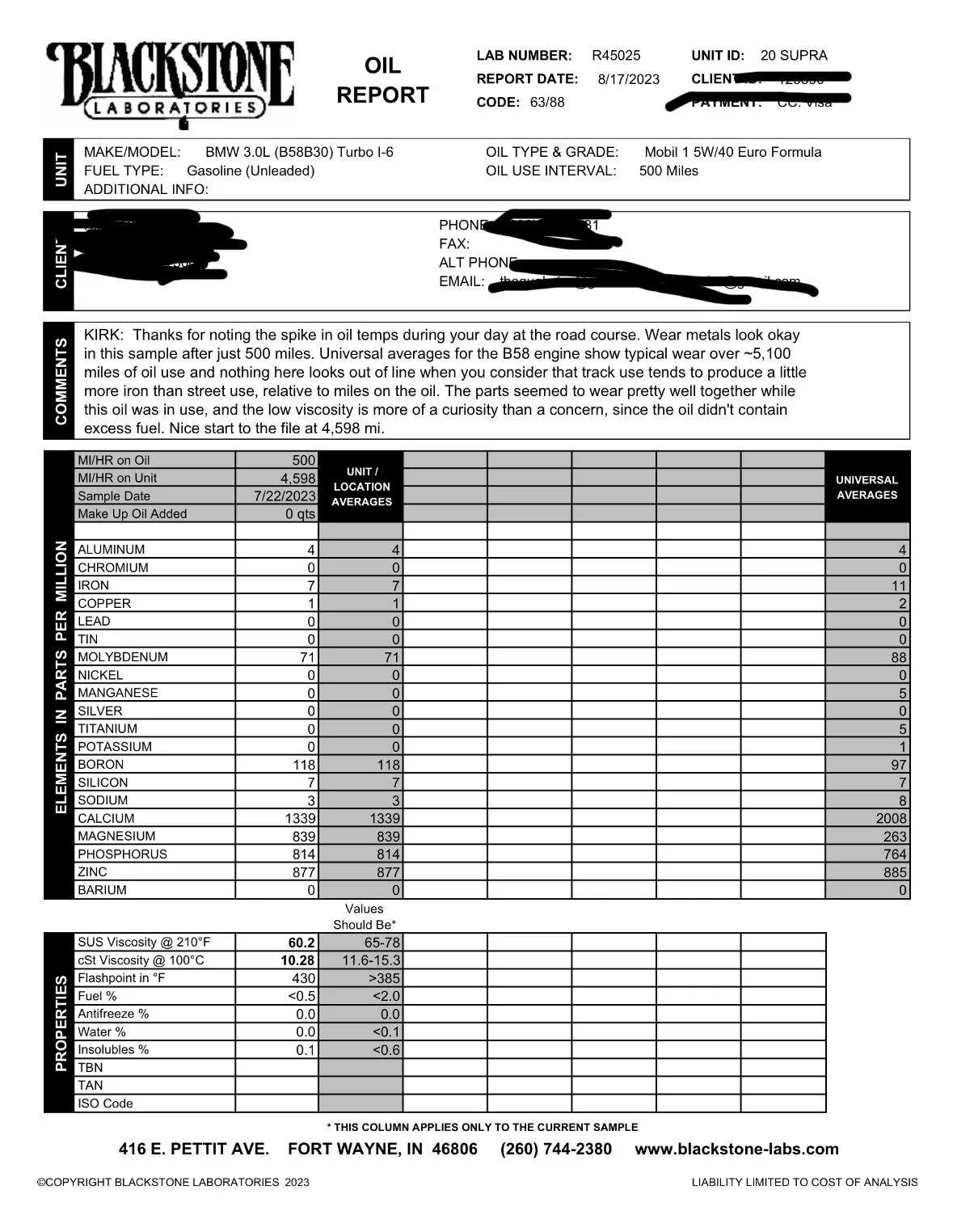

I have changed after every track day only because I’ve been over 300°F every track day and don’t know how the car handles it. Car is new to me so, 4 track days total, first day I didn’t have any vehicle logs.
I’ve been sending analysis off to Blackstone as well, and have one back, one still awaiting analysis, and am about to ship off one from this last weekend. Here’s my report from the first one. The viscosity is a “curioisity,” they say. Super curious to see if we find a trend once I get the 2nd and 3rd reports back, and if it looks different once I switch to the LL-01
No right or wrong but damn that’s a lot of oil changes. I start thinking about it every 5k miles. Done that for over 15 years of tracking. No issues yet. At least not with oil. Am I missing something with this B58 engine that’s different? And we’re cooking ? down here in FL as well.

I agree, but again, it's only because the oil has been getting so hot for me. If Blackstone says it looks good then I'll leave it for a few track days.
I came from a 2020 ZL1 1LE. It had an oil life tracker that accounted for hard driving / track use. It was regularly 280-290 F easy, and that's perfectly acceptable on those. I would pretty much change the oil when it told me to which ended up being around 2500 miles of mostly track use or 3-4 track days I'd say. I plan to do about the same in the Supra, but I need to see how the engine is doing with those temps first for peace of mind.

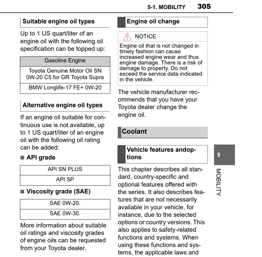

i'm going with Castrol Edge 5w30 (non-euro) because it meets API SP and ACEA C2 ratings. C5 is a mid SAP oil. C2 is the same as C5 but with higher HTHS ratings. This is why C5 oils are 0w20 and C2 are 5w30.
Directly from toyota US GR Supra owners manual:

Don't think it meets BMW LL01 or LL04 tho. You'll want that as I believe it's important for the timing chain.
Go with the Euro
