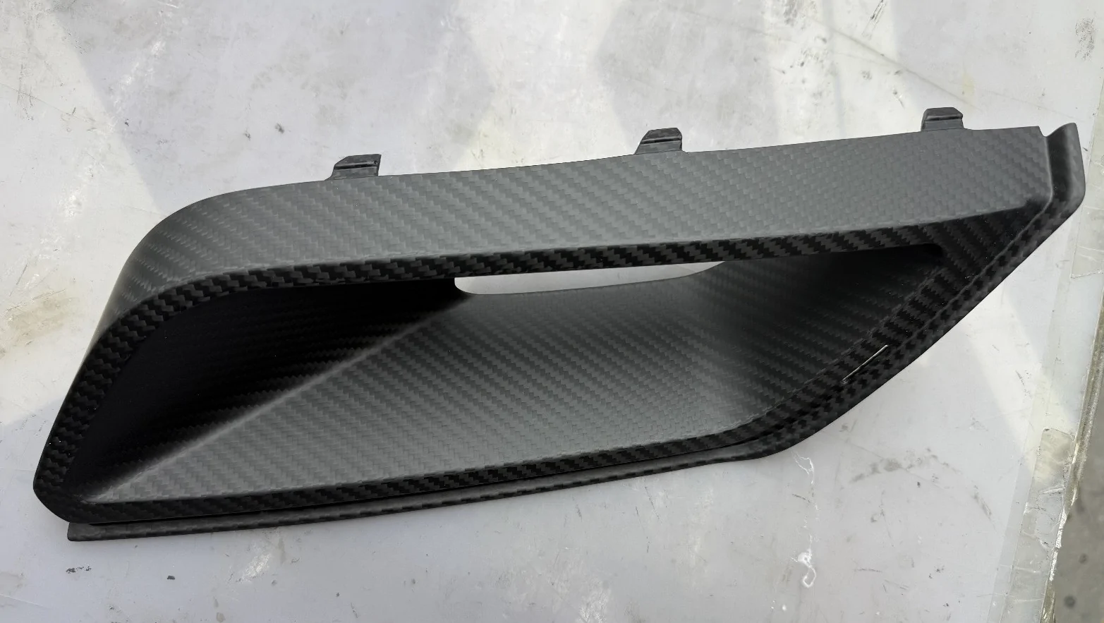

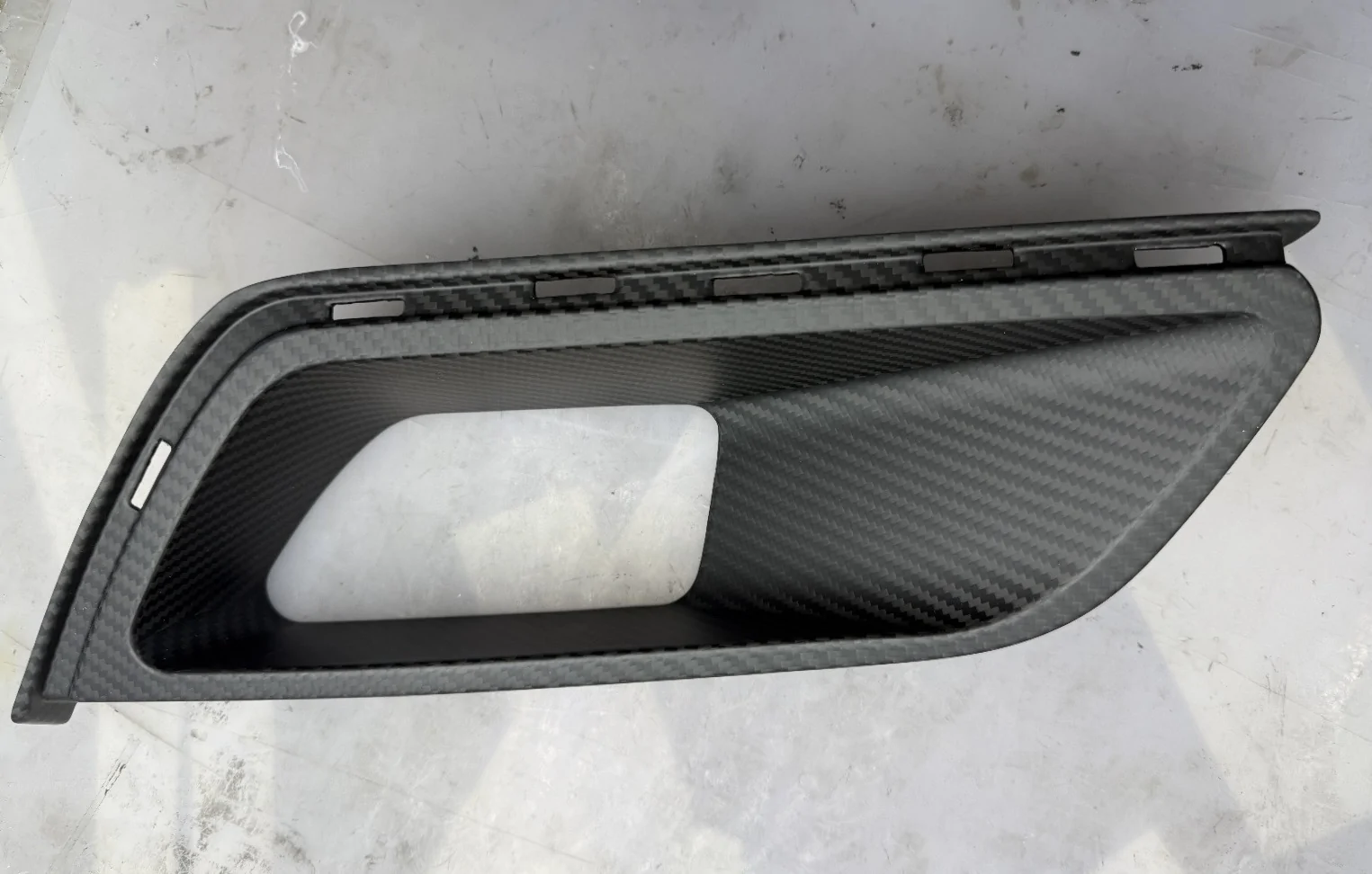

Sorry for the delay in updates. I am spending way too much time trying to get the inner duct surface quality acceptable. The goal was to have both the inner and outer surface of the ducts to have a nice smooth finish. Usually only the inner OR outer can be smooth when making carbon parts, but not both at the same time. I thought I would be able to do it using multi piece molds and hand sanding, but it is proving to be too complex.
I think I am going to cut my losses and offer the outside trim in carbon, with the inner duct in durable matte plastic like ASA-CF instead.
