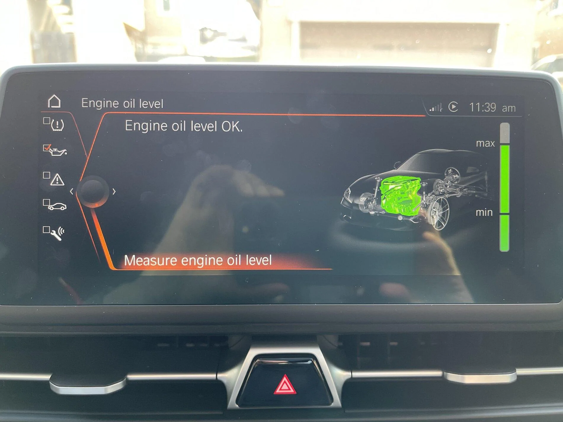

Be careful with this. Theres a few things to keep in mind when people say oil burning is normal.
BMW states that during the breakin period, the engine can sometimes burn up to 1 liter of oil (roughly 1.05 qts)every 1500 miles. Our cars hold roughly 7 qts. Low warnings generally come on when the car is around 2-3 qts of oil remaining. That would mean that if you are getting a low oil waarning at 1500 miles, you have burned 4+ qts of oil in 1500 miles. That is NOT normal.
Take a look at my picture below. This is my A91 2021 Supra after an oil change at 1100 miles, and then a full track day (so you know i drove it hard) and then another 1300 miles driven with a mix of sport mode and normal. Car sits at just below 2500 miles. Based on the measurement, my car has only burned about 1qt of oil in the past 1300 miles. (including the track day). THIS is NORMAL behavior. You generally burn more oil during a track day since you're in the upper RPM limit for a lot longer but as you can see, i'm still within spec. I dont expect to see a low oil warning till i'm close to 12000 miles, however i tend to do an oil change every 6 months out of habit.
If you are getting a low oil warning light at any mileage below 10,000, take a video. Record it, document it. And let toyota know. Even with the max oil being burned by BMW standards for the B58 engine, you shouldnt see a low oil warning till around 9000 miles driven.
My 2021 has 2,200 miles on it, 2,200 very hard driven miles, almost always in sport manual mode and always having fun. I've been putting it through it's paces since day 1. Never really worried about a break in period, call me stupid if you want, I know I know. Went for a 45 minute spirited drive yesterday morning and when I got back I did an oil measurement check and it shows the identical oil level that yours does. I've had 0 oil changes as well. Oil level right at the Max line but not above it and if what you say is accurate, that means it's only about 1qt low in 2,200 hard driven miles.
No. At the max line is full. Above it is overfilled. When it's at the bottom line, it's 1 quart low.
Ok thanks dude, well that's even better! I wish there was a percentage gauge somewhere on that screen. I still miss my old school dipsticks!
