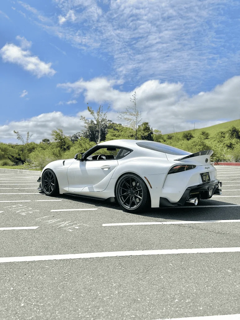

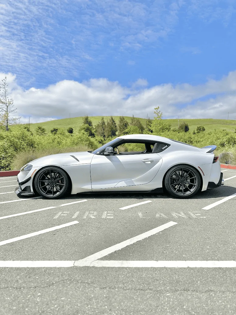

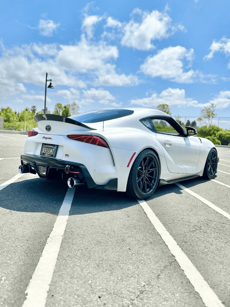

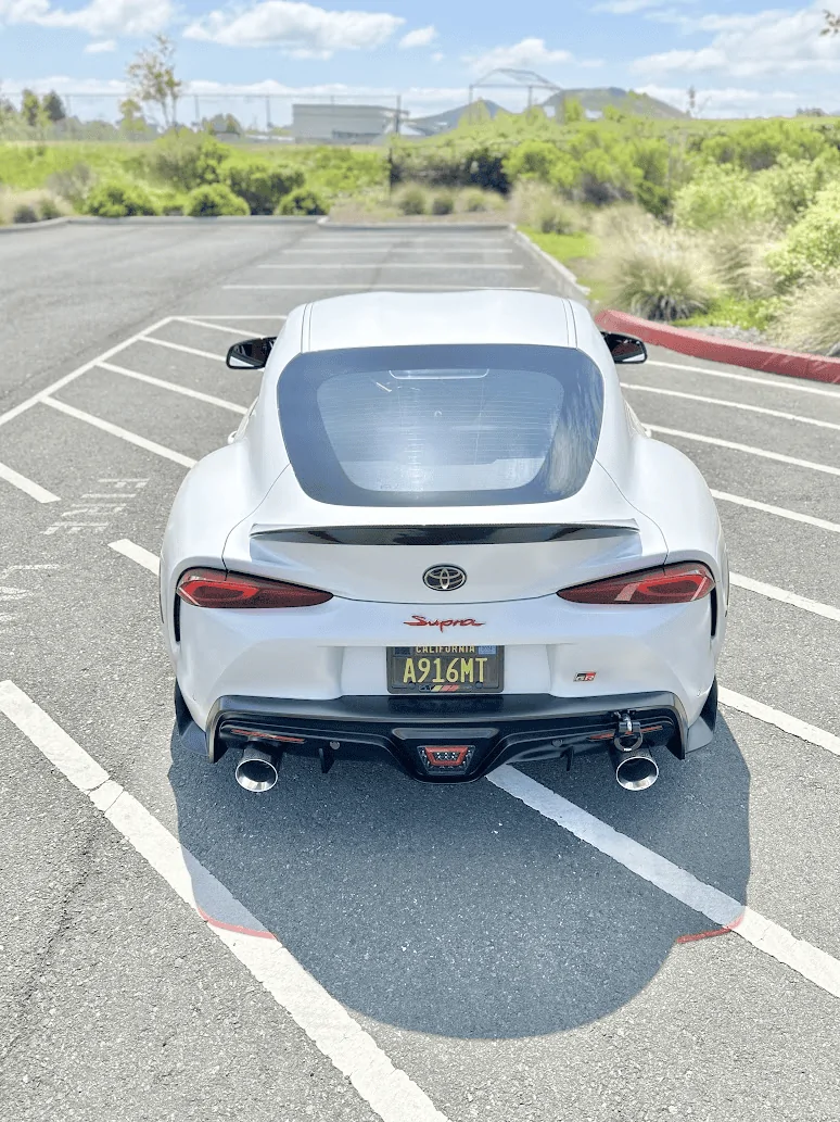

Here's some polished tip action that I recently added. I purchased this system originally with the black tips, the polished tips I ordered directly through Dinan and they're lightly longer.

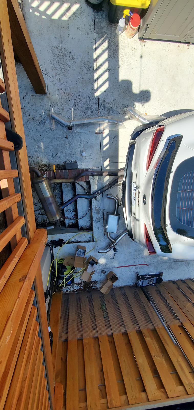

Installed mine yesterday. Sound is great. Cold start is a bit much, but I guess you have to make compromises. Quiets down pretty quick.
One weird thing is after I finished the install and went for a drive/listen I was getting a lot of smoke when I would come to a stop. I can't decide if it smells unusual (aka sweet?), as I never really sniffed the exhaust before. I hope its not a blown headgasket, just seems quite strange to be right after swapping the exhaust. My coolant is full, I guess I will have to keep an eye on it and see if I'm losing coolant. Maybe there is some kind of coating on the metal for storage/shipping that is burning off.....?

More than likely the smoke you are experiencing is just the muffler packing bags burning off. Romp on it for a half hour getting it very hot and they will totally burn away.
