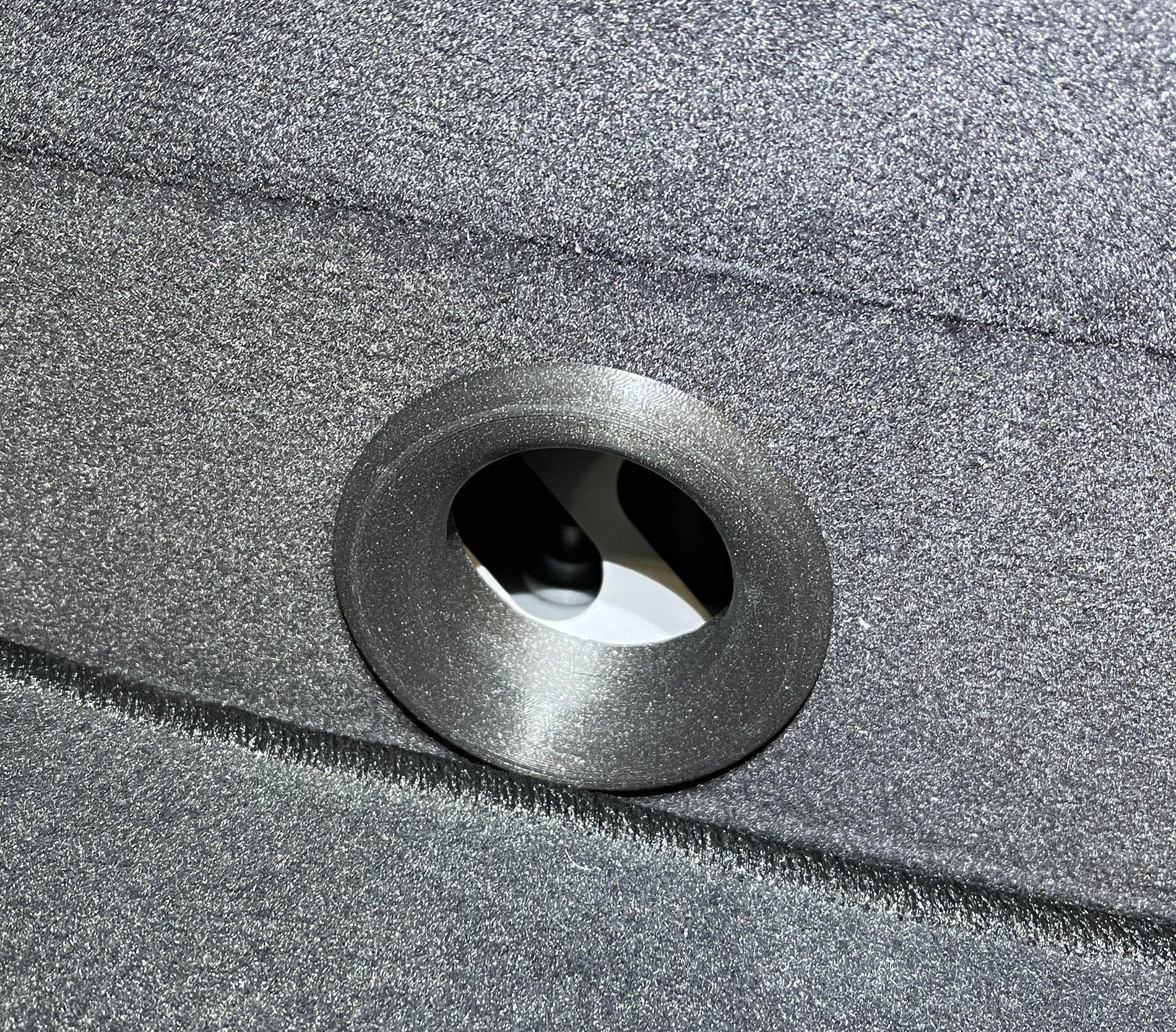

An alternative to purchasing the 2" bass ports would be to print them if you happen to have a 3D printer (as I do). You'll find many different styles on Thingiverse for bass ports. Here's a link to a simple one that replicates the ports you used.
https://www.thingiverse.com/thing:3461959
Again, great work.

Excellent Idea! I just ordered a basic entry level printer from black friday. I'm already looking for stuff to print once I get up and running. I will definitely put this on the list. Maybe etch Supra across the hole or something else.

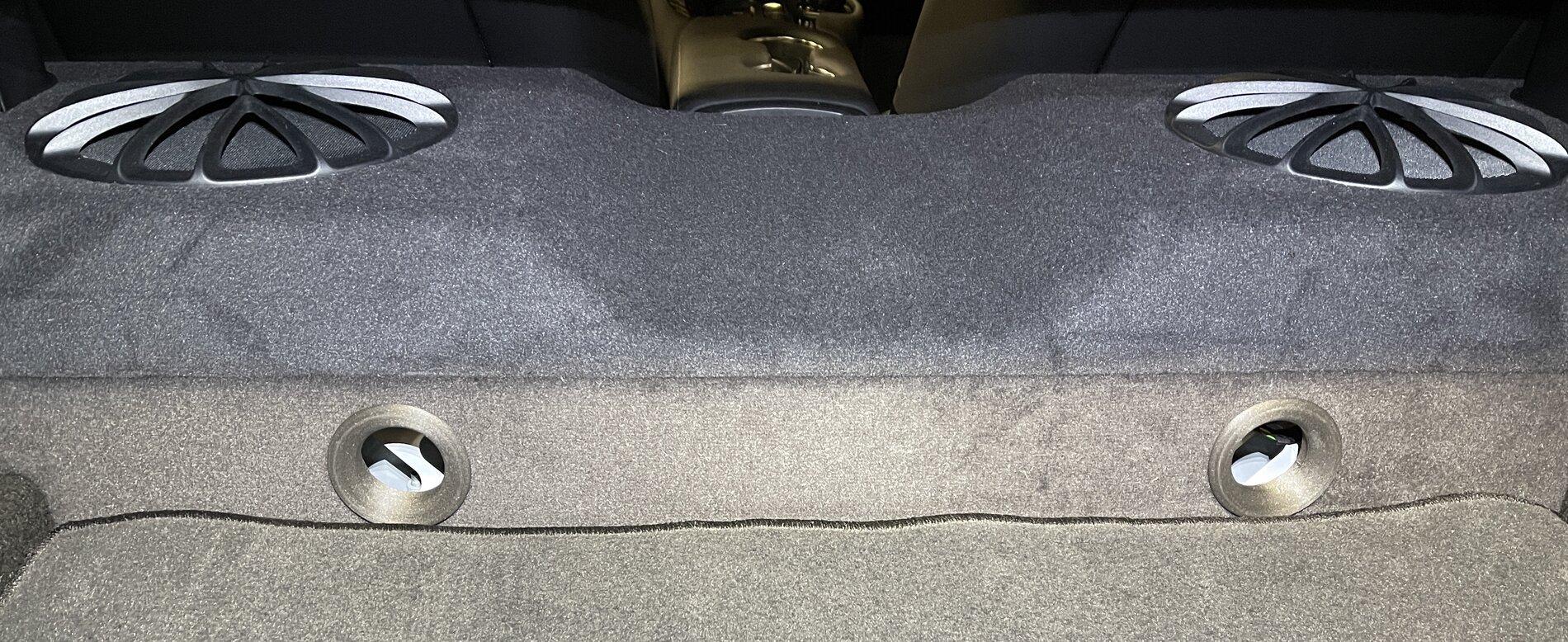

The 3D printed ports (from the file, above) worked great! As given, the outer diameter is 2.5"; the inner is 2". My 2.5" hole saw was perfect for this.
Great mod, really did clean up the bass very nicely.
