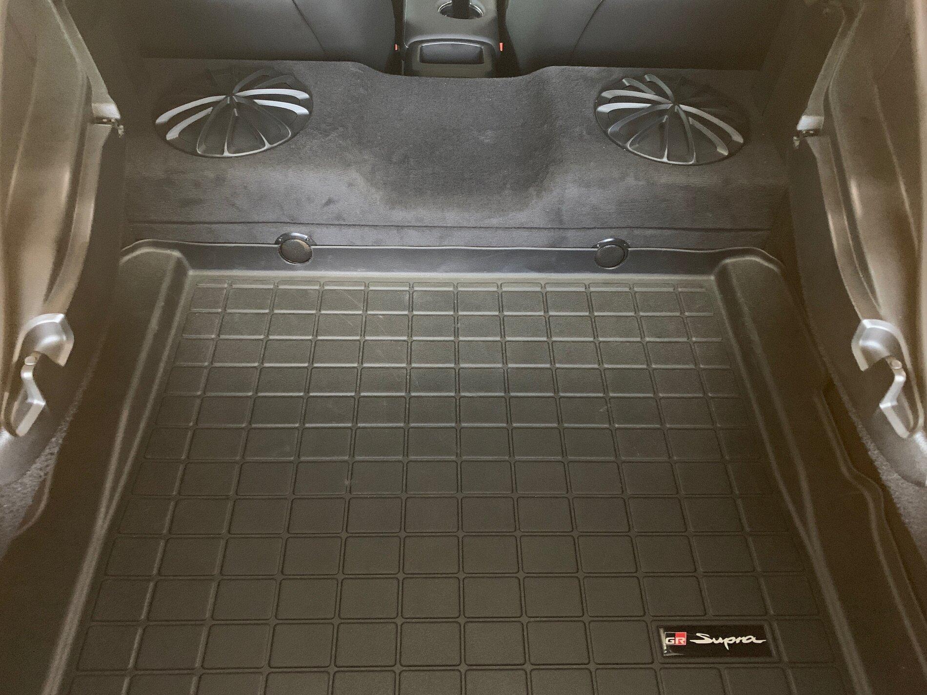

It would easily add 3~4x the time and effort...Not sure why everyone is struggling with the wadding...It was fairly straight forward for me....Quick question though. Has anyone tried taking the woofers out and adding the wadding through the big holes in the top rather than those tiny slats on the front? Seems like that would be much much easier and the extra room should make it easier to distribute it more evenly throughout the enclosure as well. Is there something I'm missing?
Also if you don't want to take the time to do the "fold / insert / unfold" technique through one of the 3 elongated front port holes you can always tear the wadding into small pieces and "loosely" stuff the cavity....do not overstuff the cavity as this will reduce bass response...
Here is a pic with woofer removed to give you an idea as to what it would still take in install wadding from the top (under the woofer)
