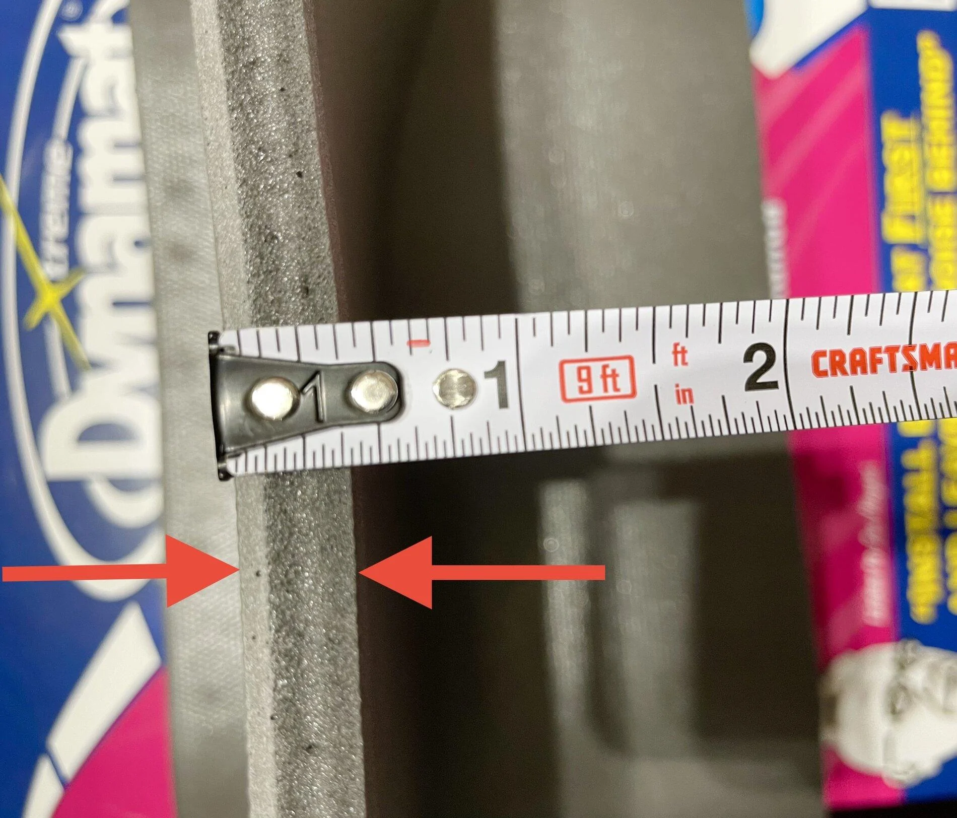

How did you cut and install? I'm guessing in precise panels so nothing that wasn't covered before became covered?
I used the trunk battery cover as the outline. Its the same size and shape. The 2 pieces of cheap insulation glued under cover will need to be removed. The bottom up stack is: Second Skin, Battery Cover then Supra mat.
It did raise the Supra mat but not enough to cover anything or misalign panels.

The Dynamat didn’t do much for road noise. I installed a sheet of Second Skin underneath the trunk mat. The material is thick and eliminated 90% of road noise from hatch area.
Did it reduce any of the exhaust symphony? Did you remove the Dynamat?

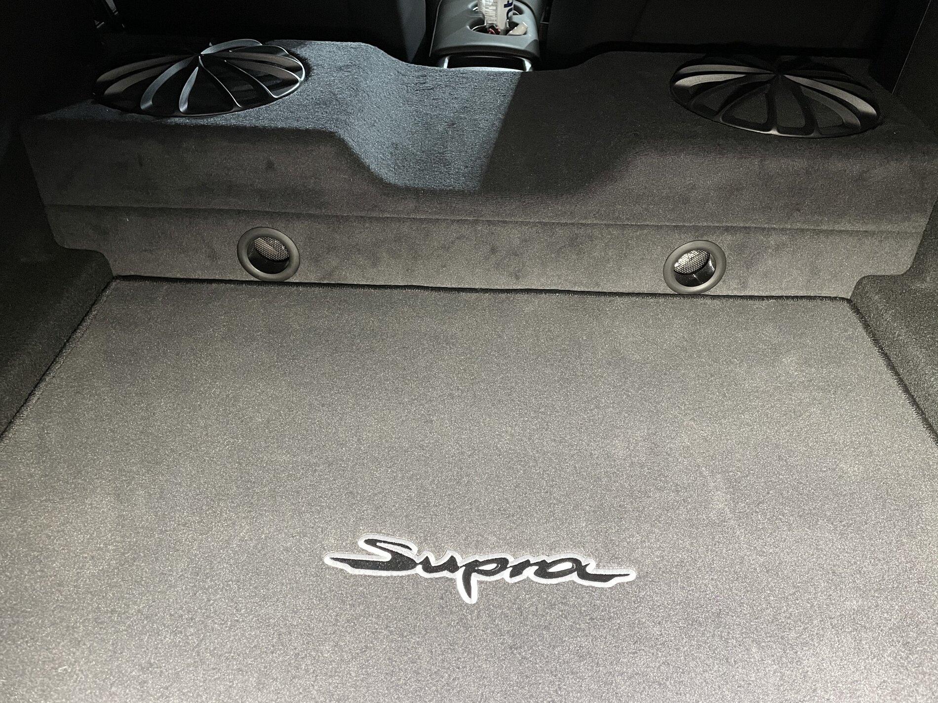

Here is yet another area that required attention for eliminating subwoofer grill rattle / vibrations...I did this awhile ago and thought it might be helpful to post while we're on this topic....

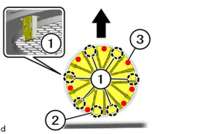

Quick question about this: is there any reason I might need to remove those covers in the future? I assume it isn't going to be easy to get them off once they are glued on.
Just make sure you secure the area between the spoked cover and circular plastic grill plate (which can be separated from one another) and not the area between the bottom of the grill plate and felt top woofer cover that I've seen some mistakenly do...It's the area between the spoked cover and grill plate where some vibrations can occur...Then the cover assembly (spoke and grill plate) can still be removed in the future to access the woofers...
You can use either small circular adhesive backed felt pads or apply small dollups of silicone adhesive which I found to be more effective...

Thanks for clarifying, makes sense!
