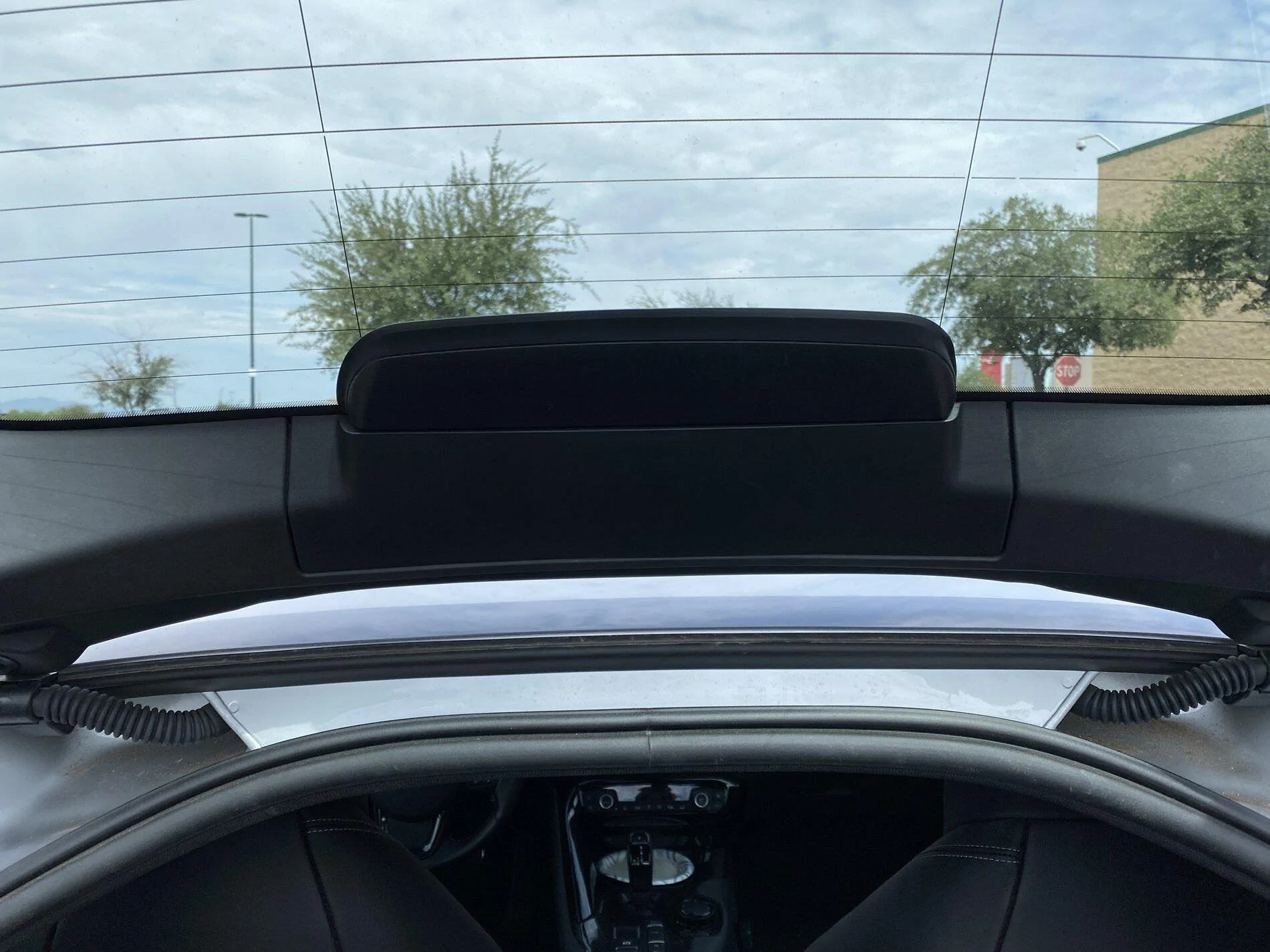

I have found a new vibration since my audio build.
The third brake light area. Not just the center piece but a majority of that plastic against the glass.
@tadda any ideas for a solution on that area?
Yes I that issue too. I used tessa tape line the plastic area where it touches the metal/glass and clipped it back into place. No issues anymore.

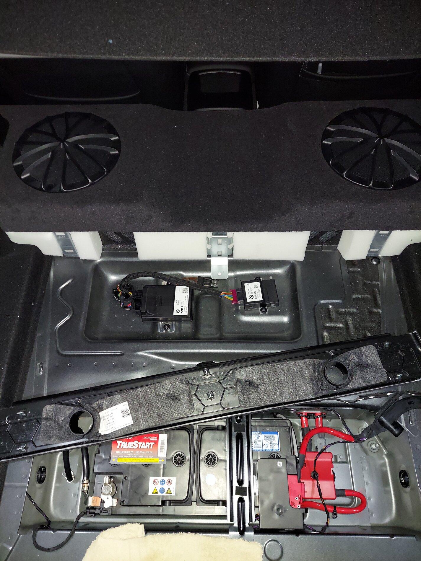

Did anyone write down measurements for the additional foam recommended behind the plastic in the rear of the car?
The road triangle area.

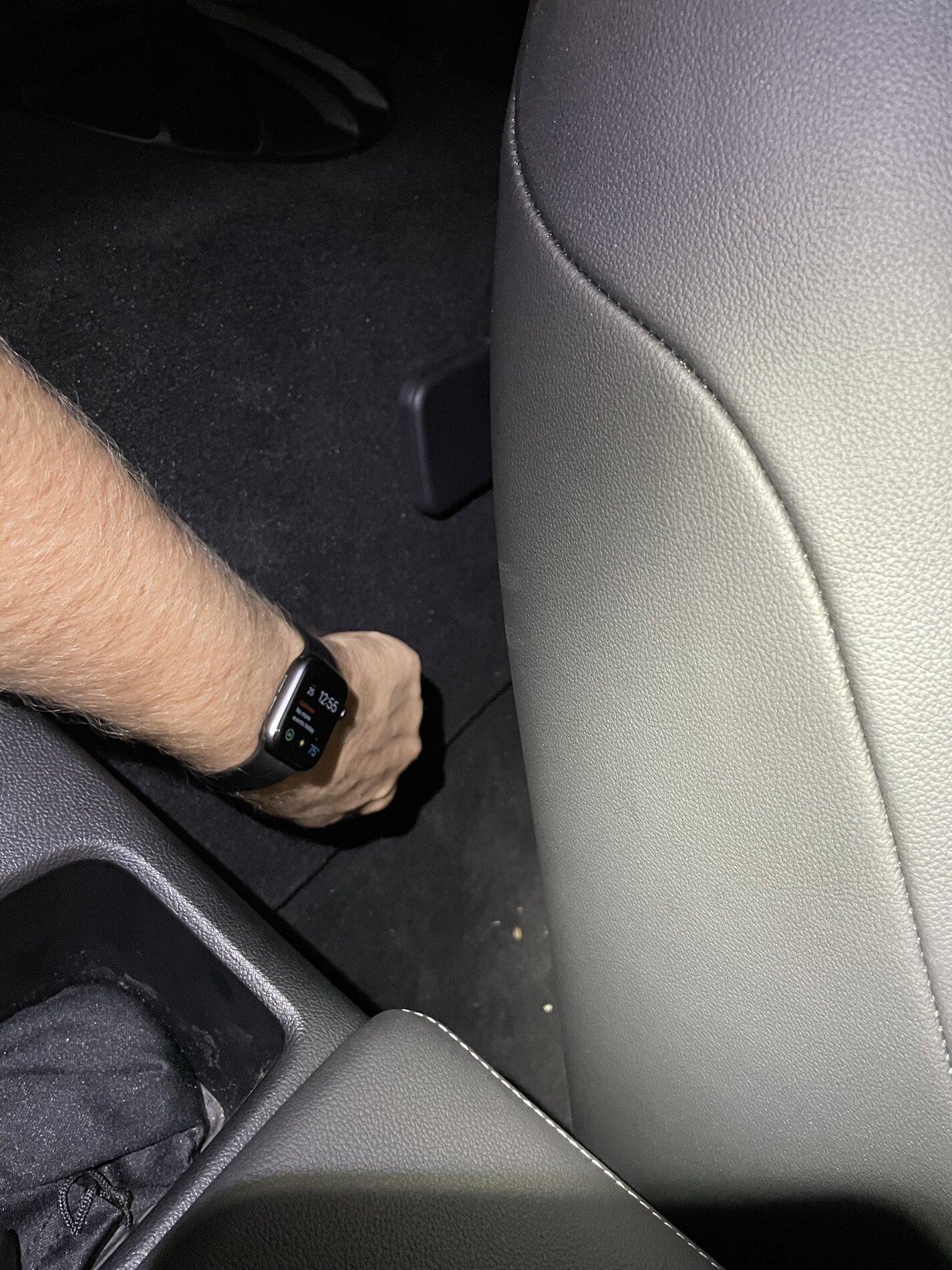

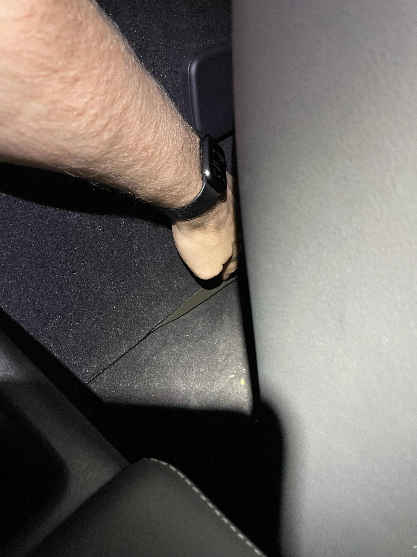

I had a really awful vibration sound coming from behind the driver side on bass heavy tracks, found the spot and was able to fix it. I've ordered the materials to do the full mod in this thread eventually too, but wanted to drop some info here as this as a really easy fix for an annoying issue.
Bad vibration/buzzing from behind the driver - turns out to be the big subwoofer trim/liner piece that I am touching in this picture. Any amount of pressure on it would resolve the vibrations. I noticed it is not very secure/tight at the bottom behind the seat.
Resolved the issue by adding a small strip of foam to tighten up the contact point / panel, see below. The passenger side liner seems about the same, but doesn't vibrate for whatever reason.
