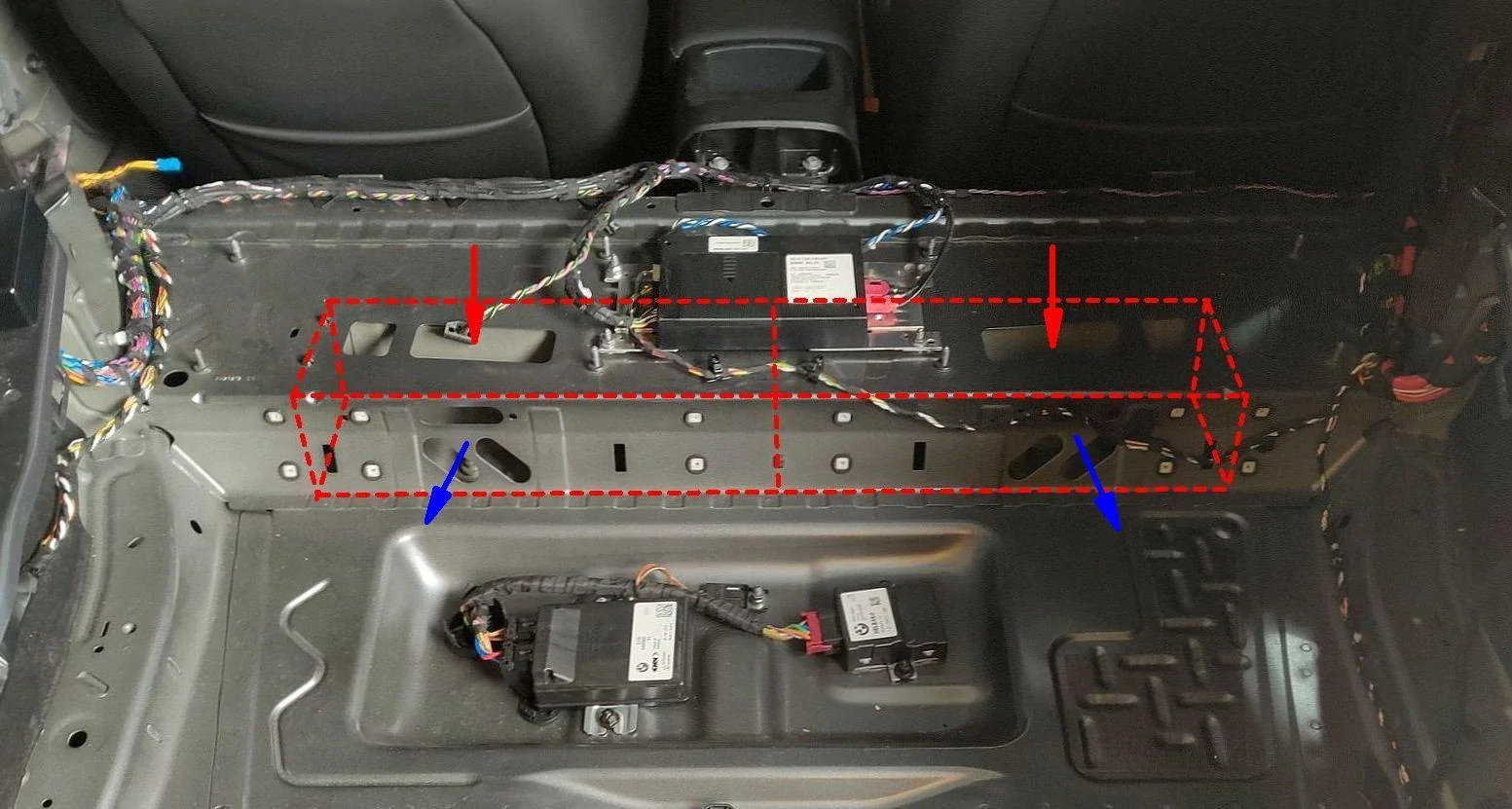

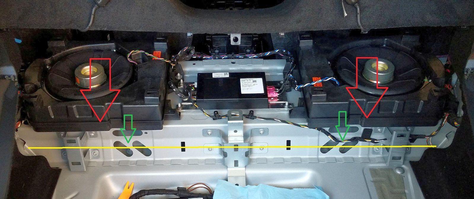

Secondly if so, Would anyone happen to have a blueprint on a sub enclosure to pull out and replace the whole factory sub enclosure area? Or, maybe someone knows where to find a diagram of some sorts of the specs / design of the factory enclosure and I can design myself..
My goal is to remove that whole sub system, build a new enclosure to close up the gap to the hatch a little more and to to fire to 8"s (Focal) backwards, to retain all my trunk space.
Thanks in advance!!
The actual factory subwoofer sheet metal enclosure shown below is not removable....
The subwoofer plastic mounting boxes on top of the sheet metal enclosure can be removed...
thank you @tadda , so my best but would be probably to build an enclosure to close off the metal, then build up from there. Again Thank you vey much!!
