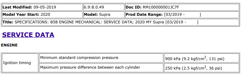

2020 2-port minimum compression is 131psi.
(I know OP mentioned his is a 6-port)

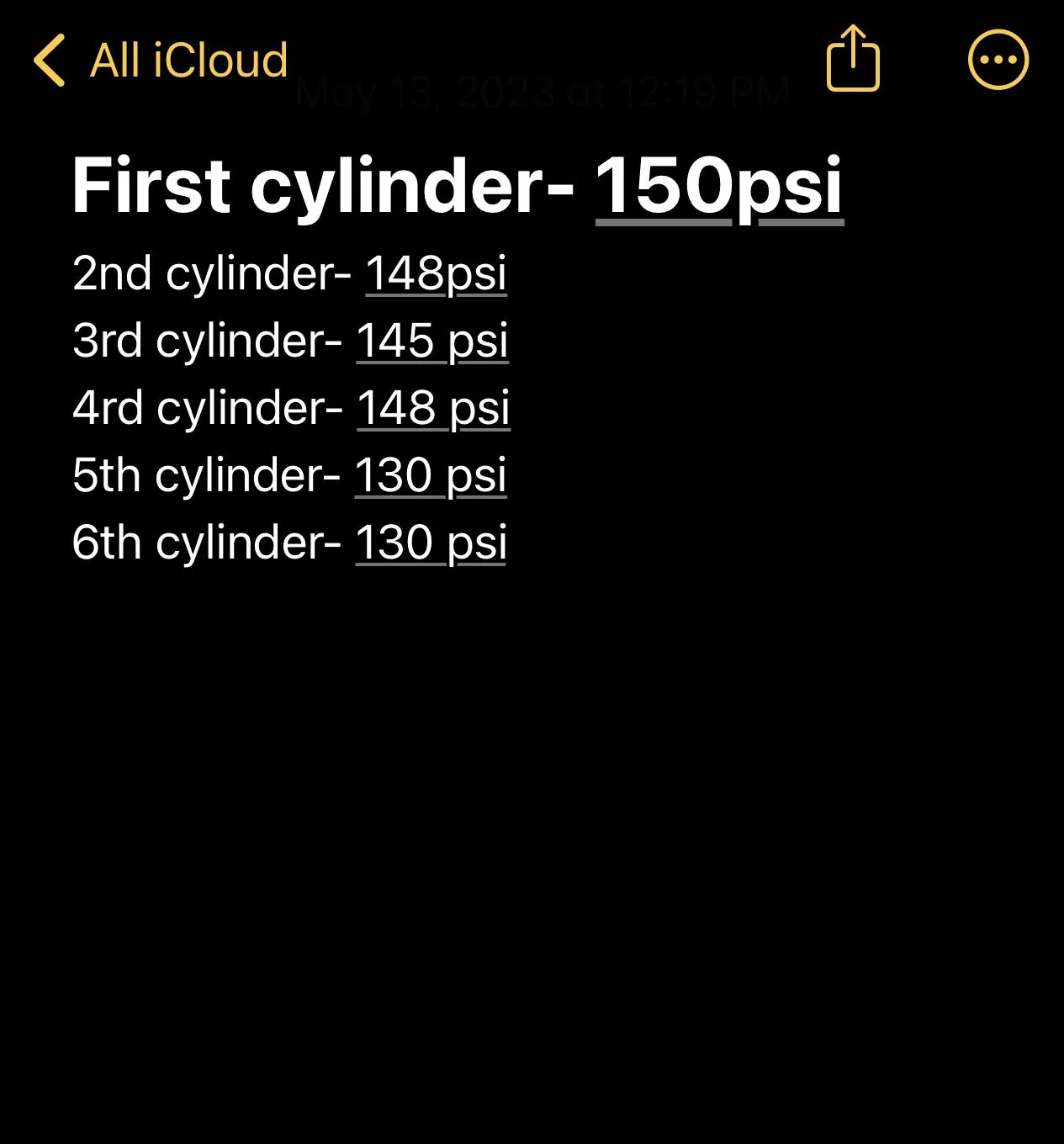

I ended up re doing compression and got 149-150 psi with all cylinders. Must of not done cylinder 5 and 6 how I was suppose to the first time. But to be honest I don’t know what’s technically the normal psi for a 6 port to be at. All my cylinders are at 150 psi but I’ve seen people have as high as 220 psi across all cylinders. So makes me wonder if mines is low lol

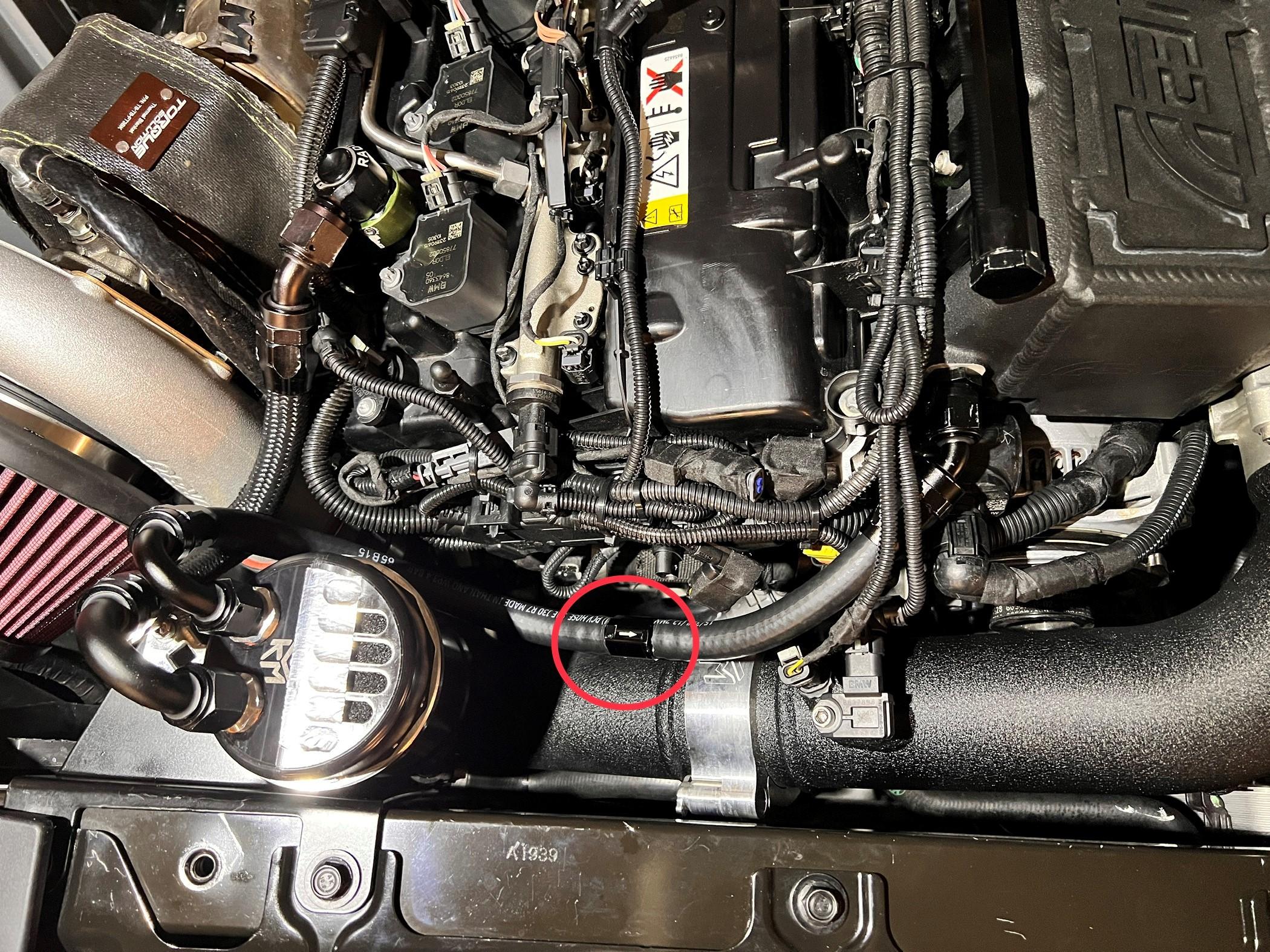

I ended up getting an oil cap breather and ran a line from the catch can back to the intake plenum with a VTT one way check valve. It'll pull the vapor under vacuum/idle and under boost keep the check valve closed allowing the PCV system to vent as needed through the catch can breather and oil cap breather. Have not had a single issue or bit of smoke ever since.

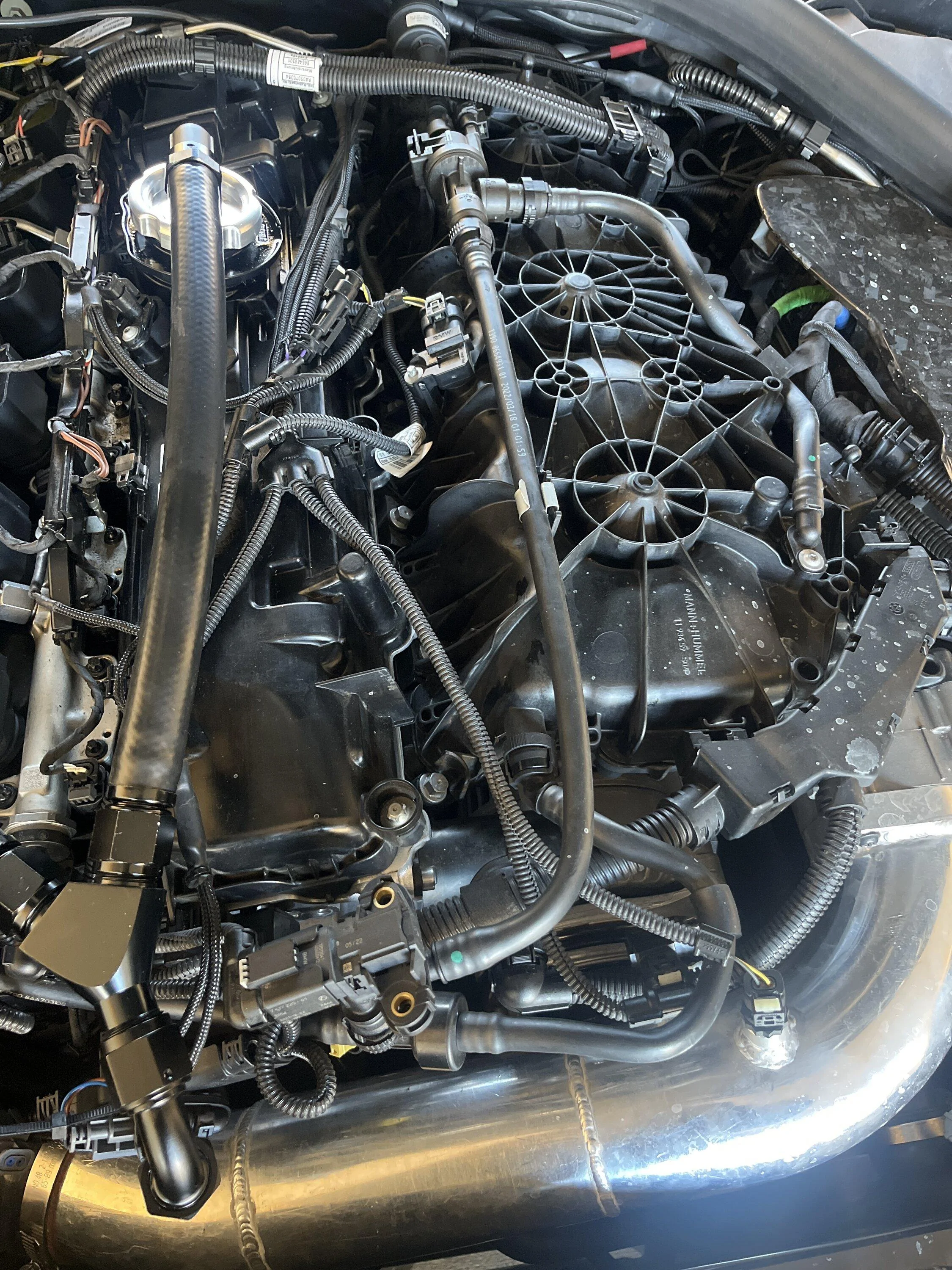

I have this same issue but it is in reverse. I do not have smoke during a pull or when I let out. When i stop at a light smoke out the exhaust. Smells like oil but white. Recently blew PCV replaced with new valve cover (used) installed block off pins. Still smoke. So i ran a radium catch can set. The CCV can i made the check valve a 2 way so if it was pushing oil it will drain bk and all the pressure from the crankcase would have somewhere to go. The PCV can i have mates with the KLM vented oil cap. Still have tons of white smoke out the exhaust when sitting still. Them nothing while driving

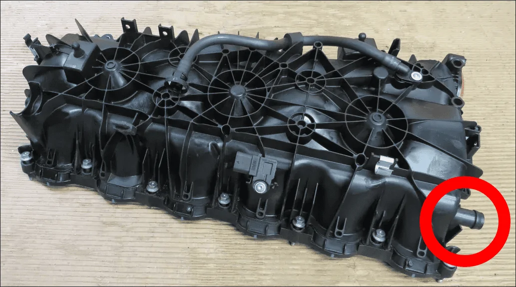

When you blocked off your PCV with pins, do any of your new PCV vents or cans attach to a constant source of vacuum? For example, running the valve cover to a t-tap on the large barb at the front of the manifold. The car will smoke at idle if there is insufficient vacuum for the crank case after doing a PCV blockoff.
No I do not have anything running to that. Actually all the stock hoses and stuff are still connected

White smoke at idle usually means insufficient crank case evacuation. Either because the car has a deficient PCV system from the factory, or the owner has made modifications to the PCV system that eliminate one or more vacuum sources on the case when there's nothing coming from the throttle.
Smoking under throttle typically means poor oil drainage from turbo and oil is pushing past seals, blown turbo seals altogether, or blown HG. The PCV system is still suspect here as well, but less so.
