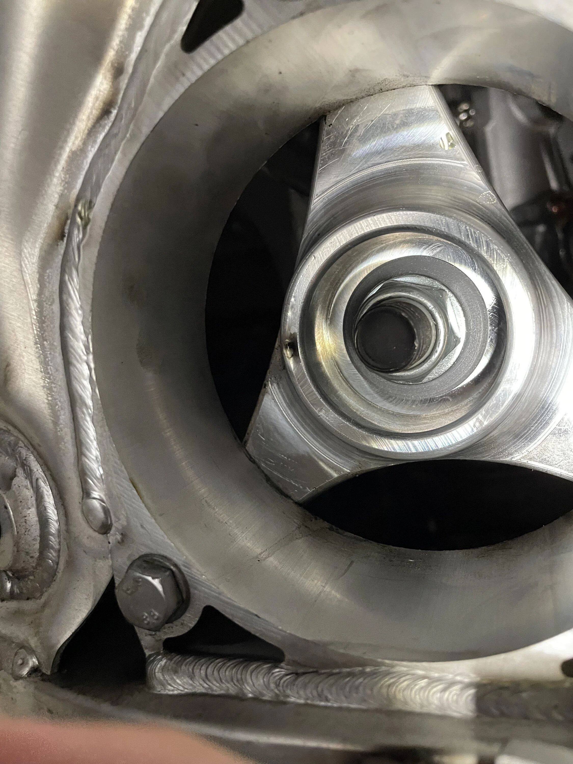

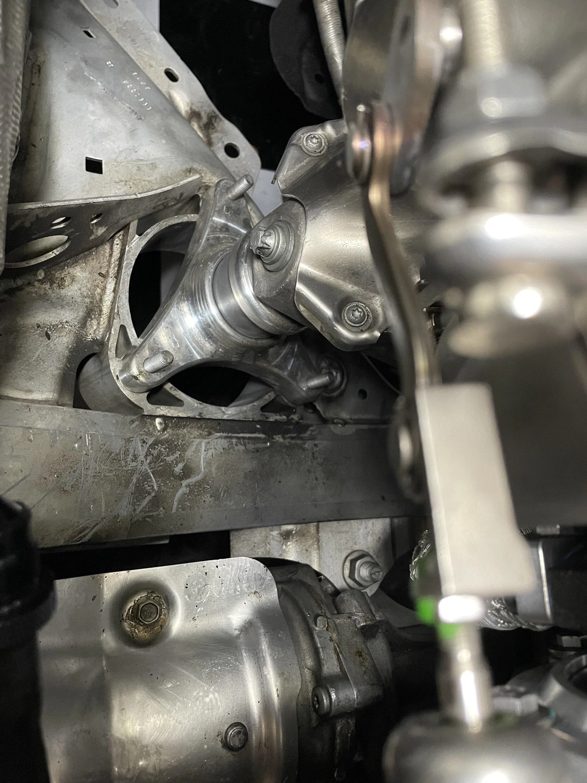

I have the doteki mounts and wanted to share a quick review. I went with the softer version but i can say it completely eliminated any engine rocking or movement. NVH is definitely a thing with typical shaky rearview, vibration in steering wheel, and drivetrain noise. That said, it improves the connectedness with the car enough that it doesn’t matter to me. Rich at Doteki is great and really passionate about the products he brings to the platform. I had a great opportunity to take photos of them installed this past week with the turbo out but i failed to take any.
Great product. Much recommend.

Doteki mount passenger side.
and from the underside.
