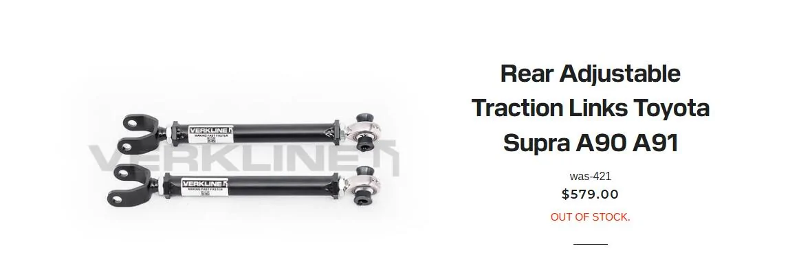

I have not - I like to start closest to the engine and work backwards :)
Also, ???
If you order from Verkline when they’re out of stock, they’ll put you in the front of the line with their next batch. I did that with their front end parts. One came in as a straggler. But it did come in.
As far as those rear adjustable traction links, that’s the only rear end piece I do have (yet). igi3Pete is right, they are fantastic!
Ahh I wasn't aware of this. Guess I'll be getting in line, thank you Mark!
