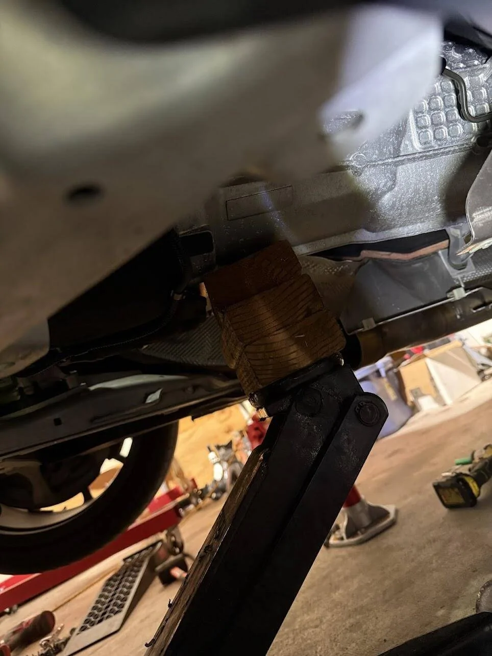

You can see my jacking point on the transmission here, I jacked the engine up until it wouldn't go any more. It was kinda sketch with the blocks of wood, but it worked!

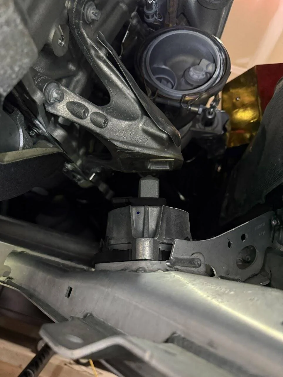

Here is the driver's side mount. With just raising the engine I was able to get enough clearance to to wiggle the driver's side mount out without removing the bracket.

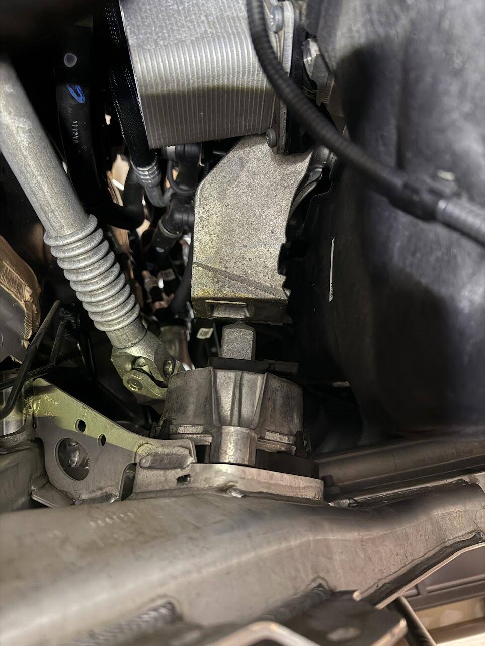

Here is the passenger side - plenty of room to wiggle the mount out without removing the bracket (downpipe was removed, unsure if I needed to remove it but I did it anyways).

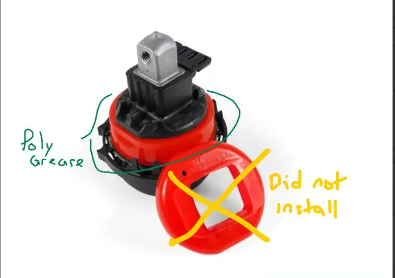

As mentioned at the beginning I only installed the lower half of the inserts, because I felt this would offer the most amount of stiffness with the least amount of increase to NVH. Also, the kit didn't come with any grease, but I am a big believer in putting grease wherever poly contacts metal, so I greased the outside of the insert with poly bushing specific grease before encapsulating it with the top of the mount.
