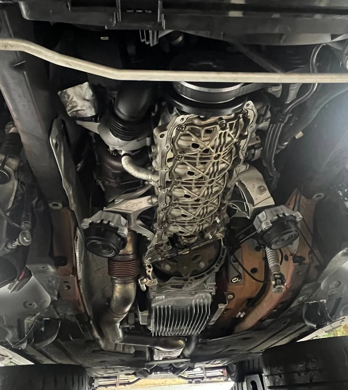

I must be doing something wrong, I can't get it high enough to pull the mounts out before the whole front end starts lifting. Is there a different procedure with a manual vs an automatic?
Can you see what exactly is making the front end lift? Is the top of the bell housing lifting the car by contacting the trans tunnel maybe? I do believe most if not all people in this thread having been changing these out on automatics, so maybe you are in fact running into an issue with it being manual... ?

From what I can feel with my hands the bell housing is making contact, don't need more than an additional 1/2" of lift to get the mounts out. I only see two ways to get this done. Either lower the subframe or remove the brackets attached to the engine. The rear section of the subframe would need to drop, not sure it would drop enough if only the rear bolts were loosened. Haven't decided which path to take., not enamored with either at the moment,
