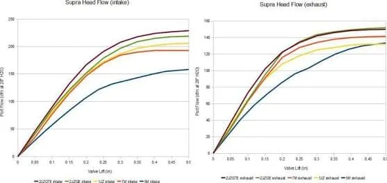

Nice to see it flows well too. Anyone that knows the 2JZ knows that the head does flow well at all. Handle a bazillion boost, reliably? Sure. Flow good cfm numbers? Yeahnah
I was told that was one of the benefits with going NA-T. Better air flow with the GE head.
MA617M
Aug 27, 2017
2,302
5,150
lots
I've got some flow rate curves for Toyota heads somewhere. IIRC, there was little difference between GE and GTE heads.
MA617M
Aug 27, 2017
2,302
5,150
lots
Can only find it in pleb spec resolution - but yes you're right- at higher lift, the exhaust of the GE in fact flows the most of all JZ heads :)
also check out that 7M on par with 1JZ for a bit, awwww yeeeaaaa
