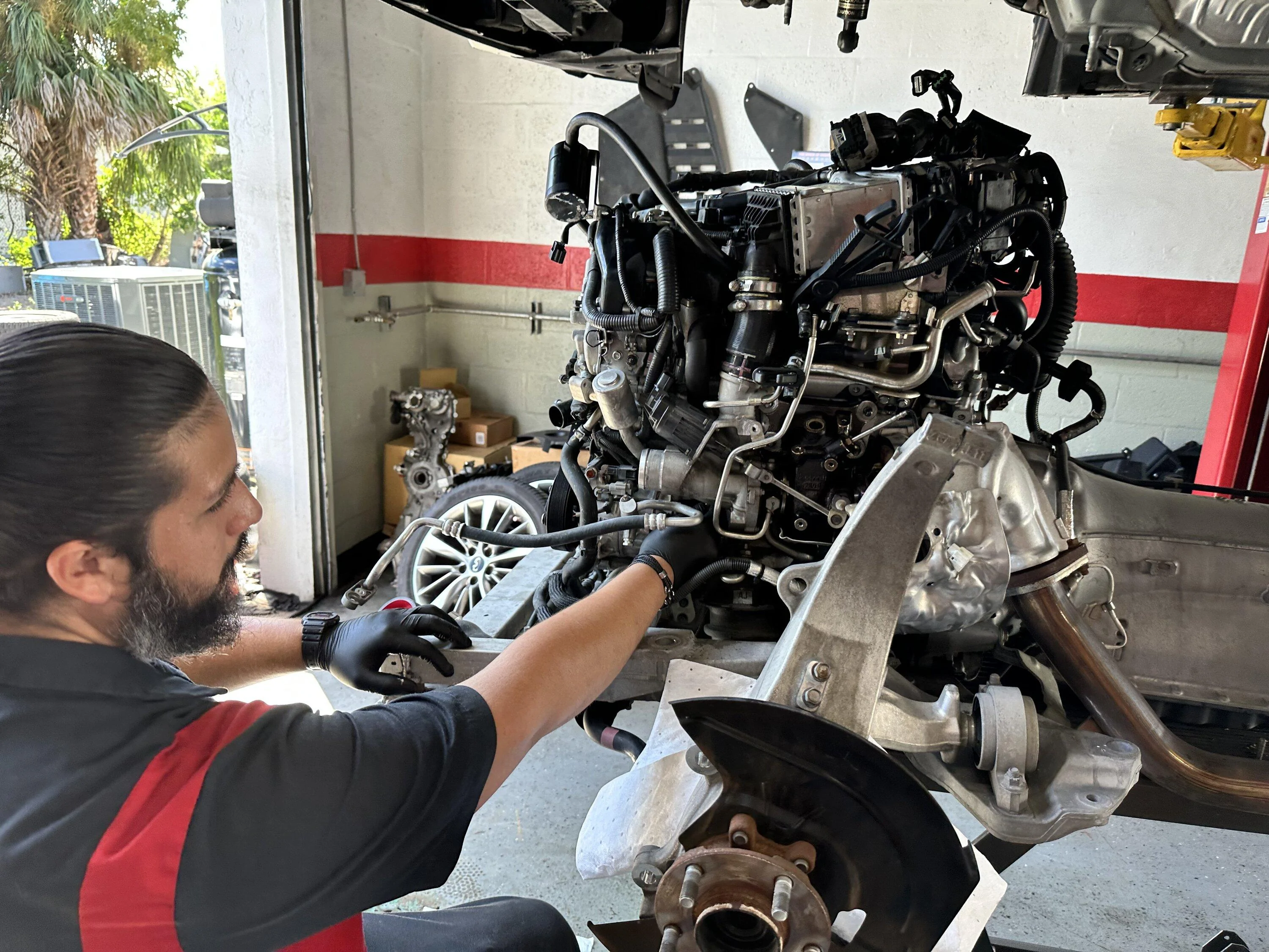

Took this picture just yesterday. Went in for an oil change and minor adjustments until I can make it to the race alignment shop (got new rear axels since no boot kit available yet).
*pic is of my buddy Ricky & owner at Fuji-San automotive.
