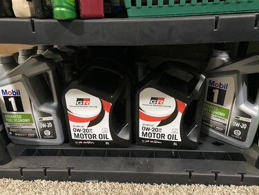

I got a nice supply of motor oil ready. Lol ?
I went to my local dealer to see if they had the Supra GR oil. I know the guy in the parts department, and he said he'd have to order some, I told him someone there said there's 3 quarts there. So he looked up on the puter and said nope none here. I told him to look in the back, and he found the three quarts. He said take them at no charge cause they were shipped to them instead of going to another dealer. I said what, and he said there not on the puter system, and take all 3. Was a happy camper since they charge $13.00 A quart.
I got my online through Daytona Toyota... Free shipping too..

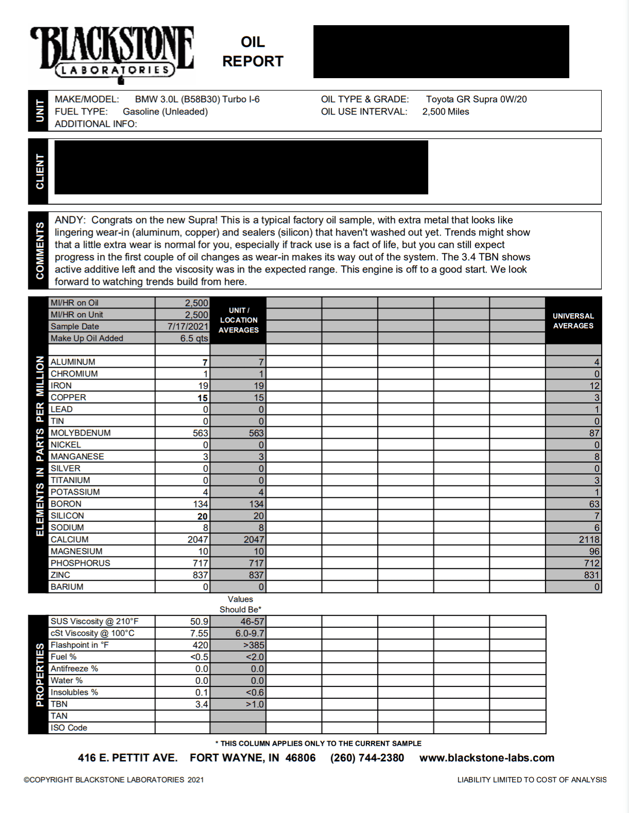

Here's my Blackstone report on my factory fill oil sample taken at 2500 miles, for whoever's interested. Followed the manual (for the most part) for the first 1200 miles, had a track day at 1900 miles, and a good bit of spirited driving on the roads mixed with regular cruising.
Filled up with more GR Supra 0W-20 that I'll be changing out again at 5k. Once I get the results of that sample I'll make a decision to stay on the Supra branded 0W-20 or move up to xW-30 at 10k miles.
