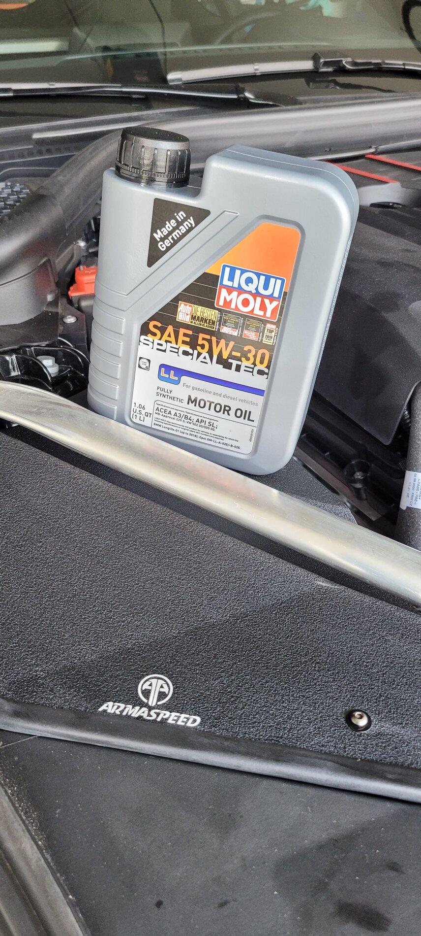

FCP Euro liquid Molly change kit with Mann filter. This car couldn't be easier to change the oil on. Dealer ain't touching my car, and not putting anymore of that brown water in it.

Thatā€™s the same oil I use in my Supra. It makes the engine run quieter and smoother.
-RJM
Glad to hear someone else say this because after my switch to 5w30 I will swear it runs quite and smoother, but wondered if it was in my head or if others thought the same.

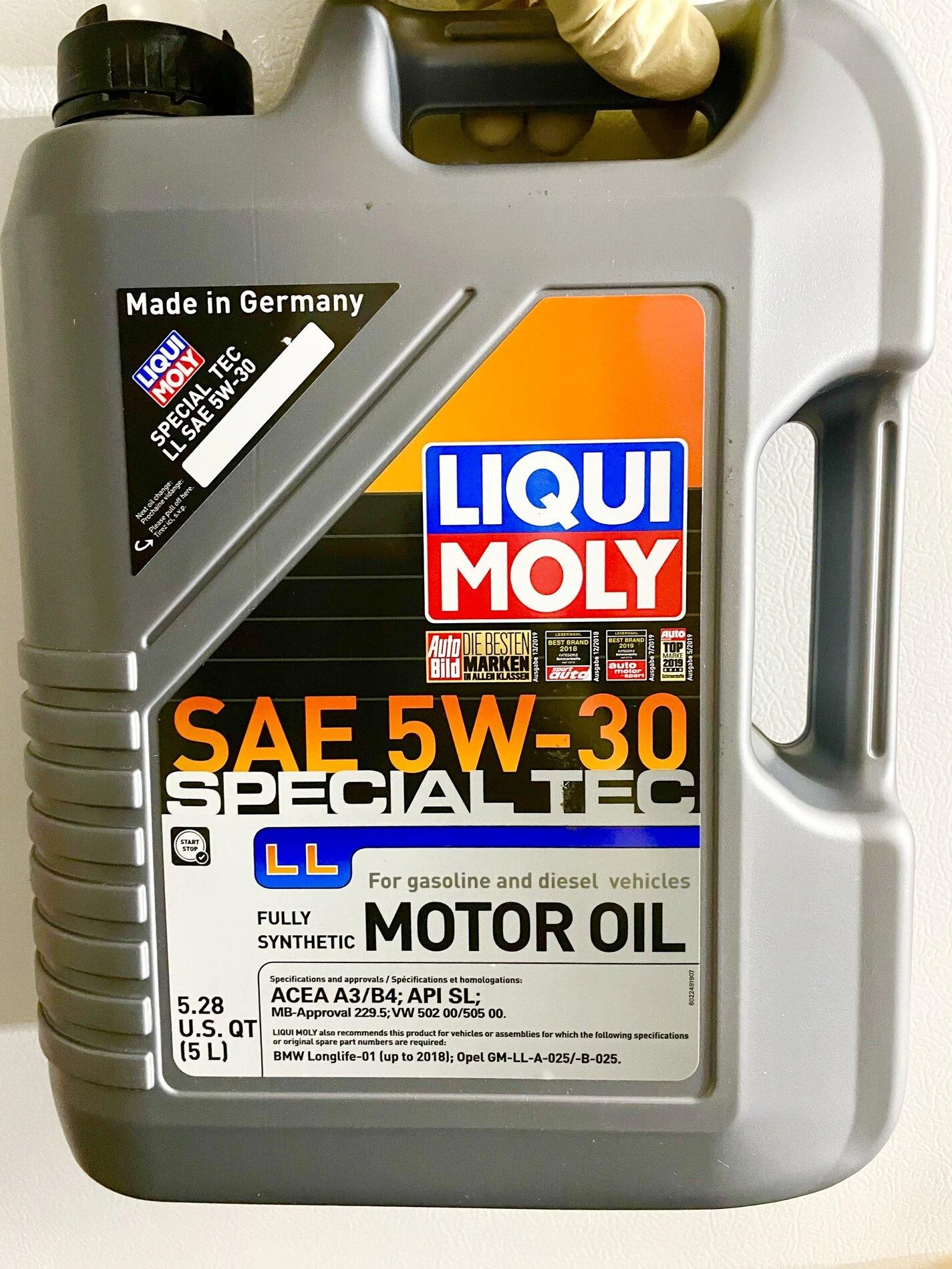

Generally speaking, no, there really isn't anything wrong with Mobil 1 fully synthetic oils. Honestly, it's a good oil, and is even generally well-regarded with the folks at bobistheoilguy.
That said - Mobil 1 does NOT currently carry any certifications from BMW. Some of their oils used to be LL01 certified, but they lost that certification a few years ago, for some reason.
I'm not sure how Toyota is handling warranty claims on engine issues, but BMW will deny a warranty claim in an instant if they discover you've been using an uncertified oil, and they have every right to do so, crappy as it may be.
On the other side of that, Toyota states that oils that carry the ILSAC certifications are fine for their cars, and Mobil 1 does carry those certifications - though the Supra does use a different oil than the entire rest of their lineup, so that may be a different story.
Really, though - if you're only concerned about your engine, Mobil 1 should be just fine. It isn't my preference, but I don't have any objective reasoning for that. If you're concerned about your warranty, though, you may want to skip the Mobil 1, and either use the OEM brown water, or something that holds one of BMW's LL certifications.
