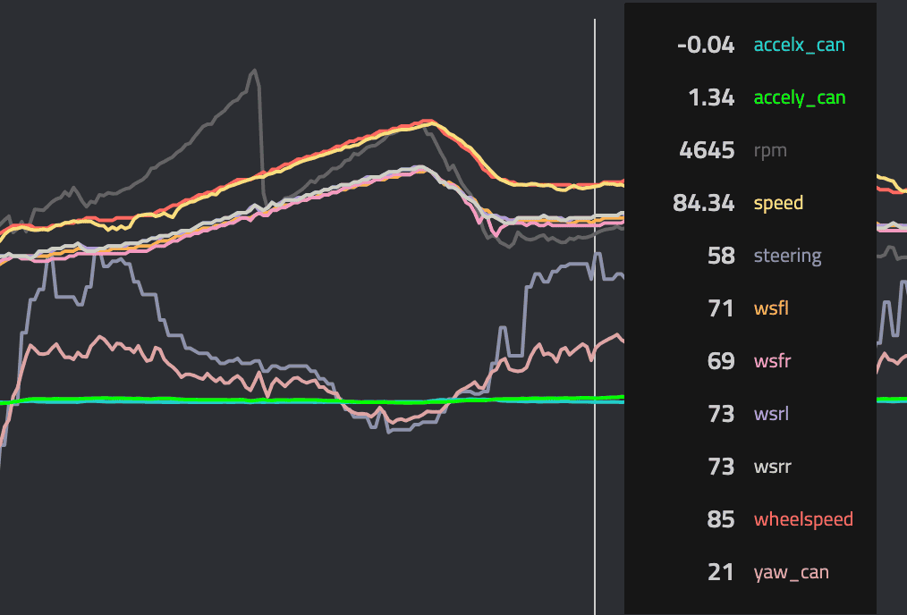

So I'm assuming you are bringing in the these CAN data points:
wsfl/fr/rl/rr are wheelspeed front left, front right, rear left, rear right
And with those data points you are creating 3D tables where the tuner can input amount of timing retard, etc based on the X/Y values?

wsfl/fr/rl/rr would be great to have in Ecutek, however it is not present, nor does Ecutek intend to make them available. For that reason the data comes through an external source and routes through the motiv reflex box which is why it's required. I dont see this as being much of an issue as most cars that arent running port injection wont have enough power to see a real benefit from the product.

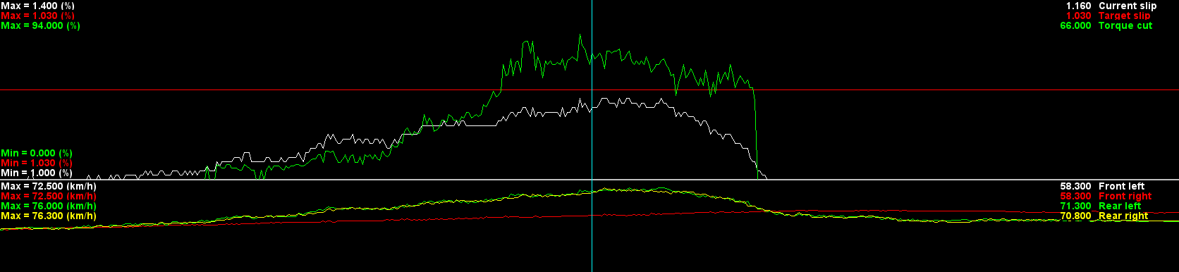

*Update: The data passed through to CAN for a tuner to use can be either a direct wheel slip percentage, or a torque reduction request percentage.

Yea that makes sense since you can't get it through Ecutek. I was asking about port injection because this would also be a GREAT feature for track cars that turn their steering wheels, even at lower power.
