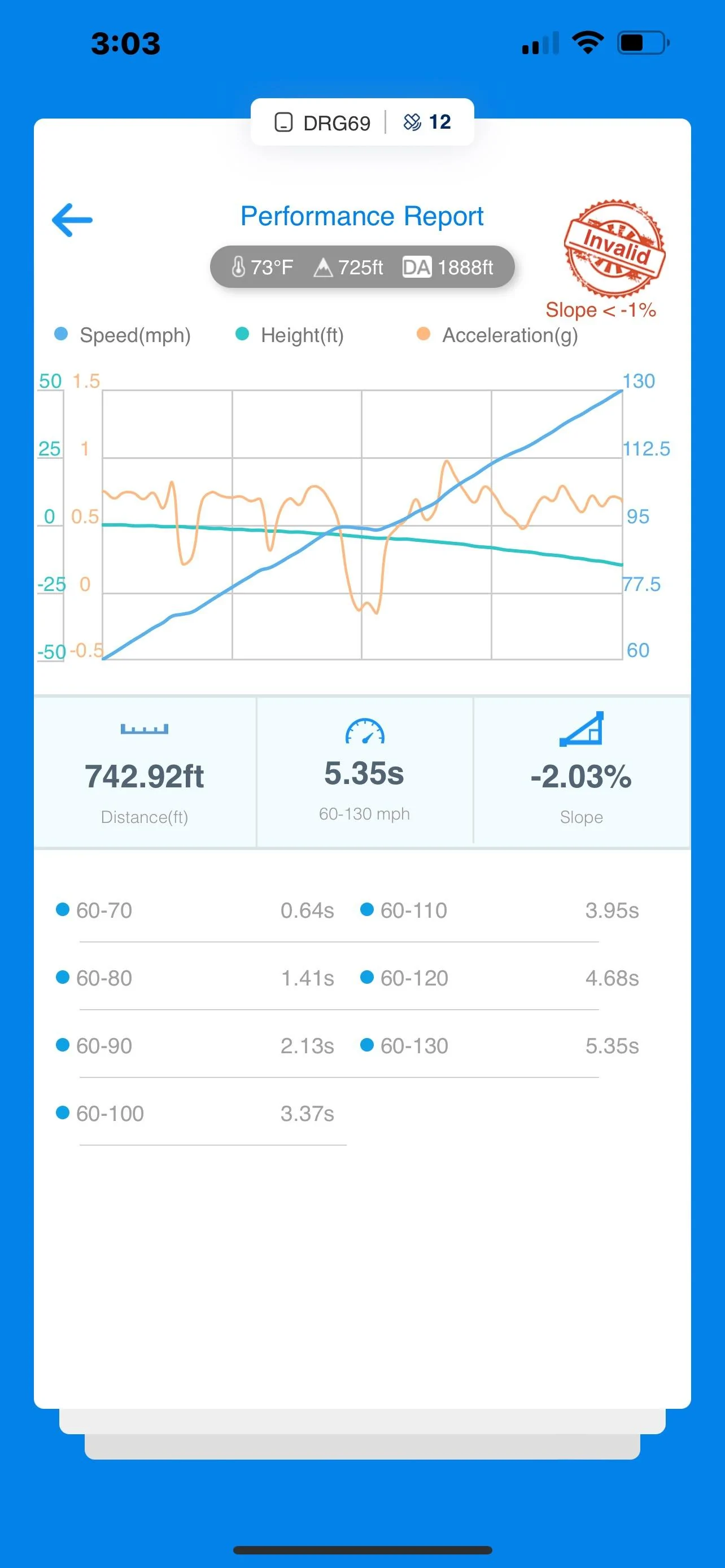

Here is an older example from months ago using reduced ignition timing to bleed off power slightly to keep wheel slip on target. You can hear it in the ATCS video where the power is dialed down when wheel slip is above target. The car in the video is making approximately 850-900whp on a asphault non-preped road. This car without ATCS sees approximately 20-30% wheel slip at actual speeds up to 117mph
I have a more recent video being made to display the ATCS advantage on a 600whp car coming soon (Wednesday).

Oh, that's cool. That car's an absolute rocket. Saved a whole second to 130. Big fan of draggy to show practical results. BTW - i think you copied the first video twice which might confuse someone for a moment.
