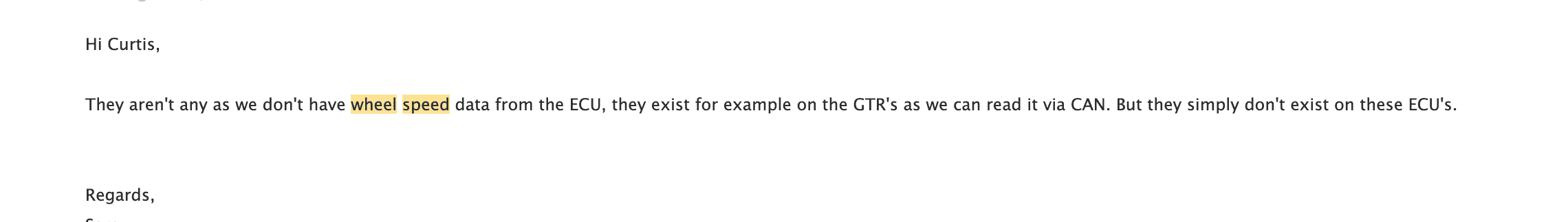

Unfortunately I’ve been told over and again from ecutek that there are no plans to add access wheel speed data. Otherwise I wouldn’t have bothered
@razorlab posted logs of wheel speed from the factory Supra ECU (via BM3 I presume) in this very thread. Maybe send that over to Ecutek to see what they have to say?
unfortunately based on their response I’m not sure they can or will.
I didn’t grok that from what our dialog was beyond the post in question. So let’s ask him.
@razorlab the screenshot you posted, was that from a Supra on bm3 or a log from a different vehicle?
