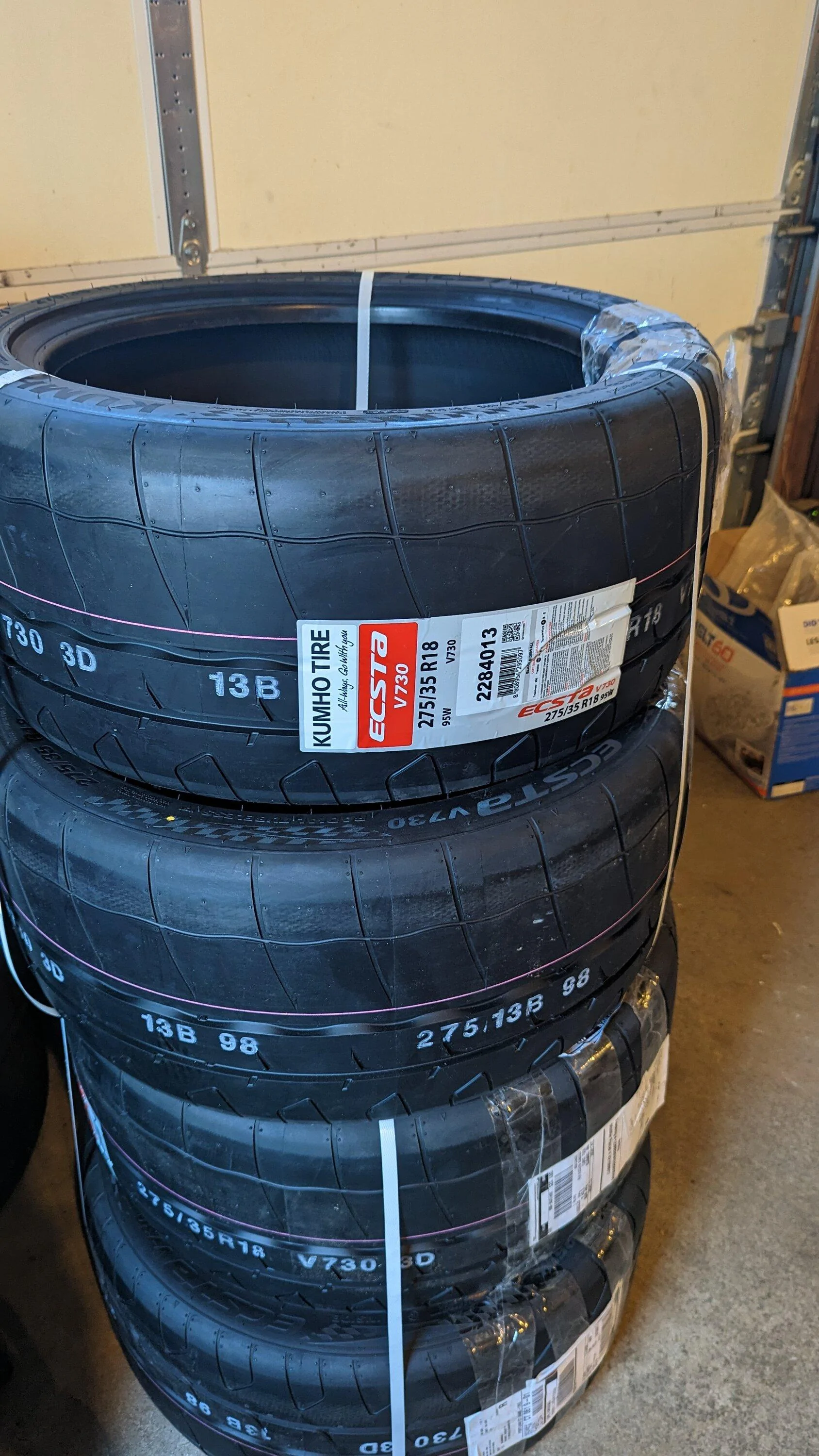

I used NT01's for about a decade. They where a great tire, fast to the cords. However, almost every single 200TW are faster than NT01's now. NT01 will last longer but you will be 2+ seconds off pace of pretty much any modern tire.
You still find Nankang CR-S is the best bang for the buck? If buying at retail. I know you get a killer deal. Any money saving I can get, all for it. Paying ~$250/tire for the Maxxis Victra RC-1. Great grip all the way to cord. I’m counting the weekends (track days) this go round.

Anyone have experience with the Falken 660's? I used them on my RX-8 and was a fan. I think the Nankang might be my next set based on price and reviews but definitely interested in those 730's as well.
8,828
17,320
Best bang for the buck are the Kumho V730's for sure. I pay the same price for the Nankang CR-S as everyone else. Since I pick them up, I get local price, which basically knocks some of the tax off, but not all of it.
I have never used the RC-1 but have heard good things about them, I just wouldn't want to get caught in the rain with them. I will try a set after I try this set of Nankang AR-1s.

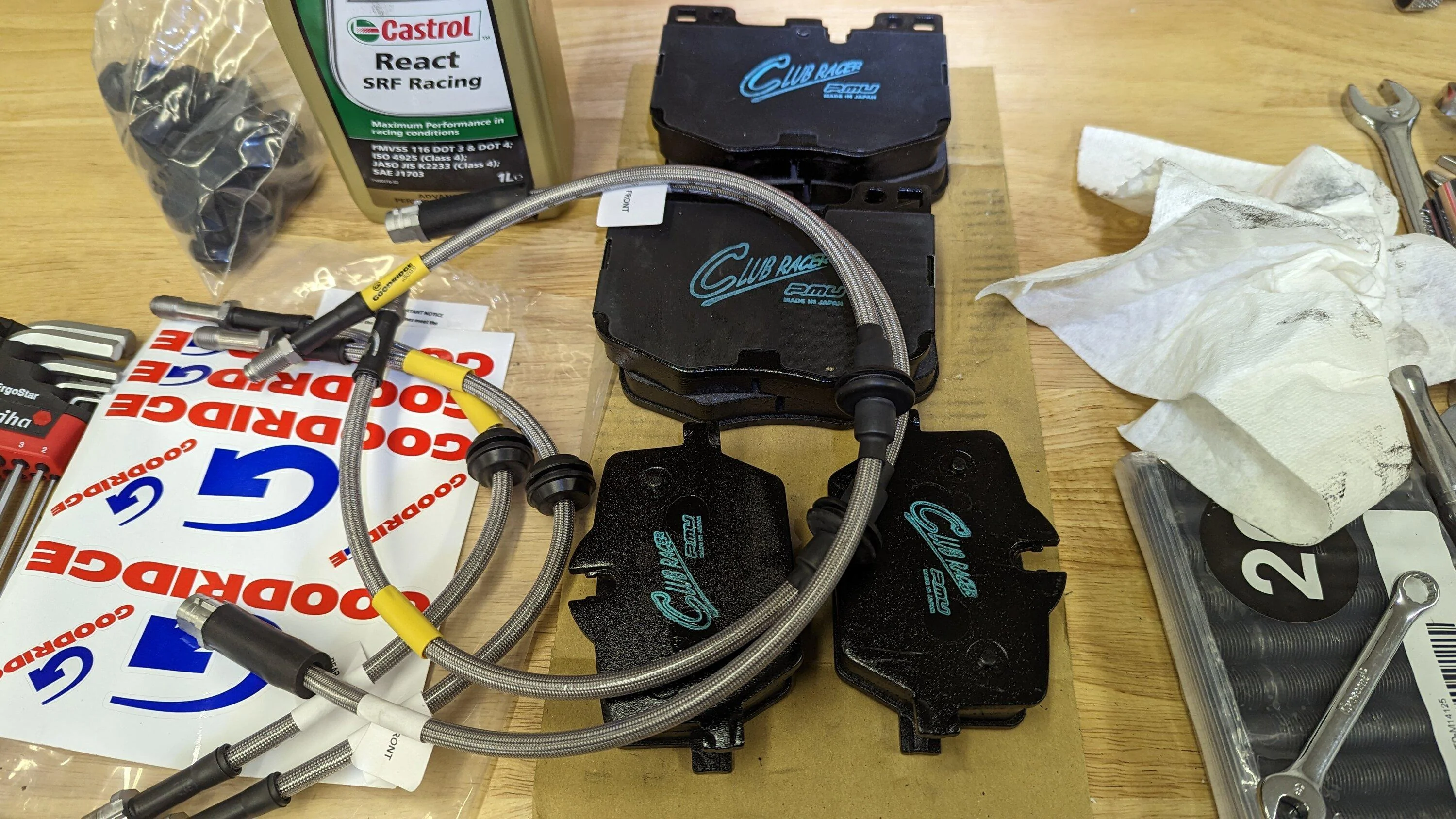

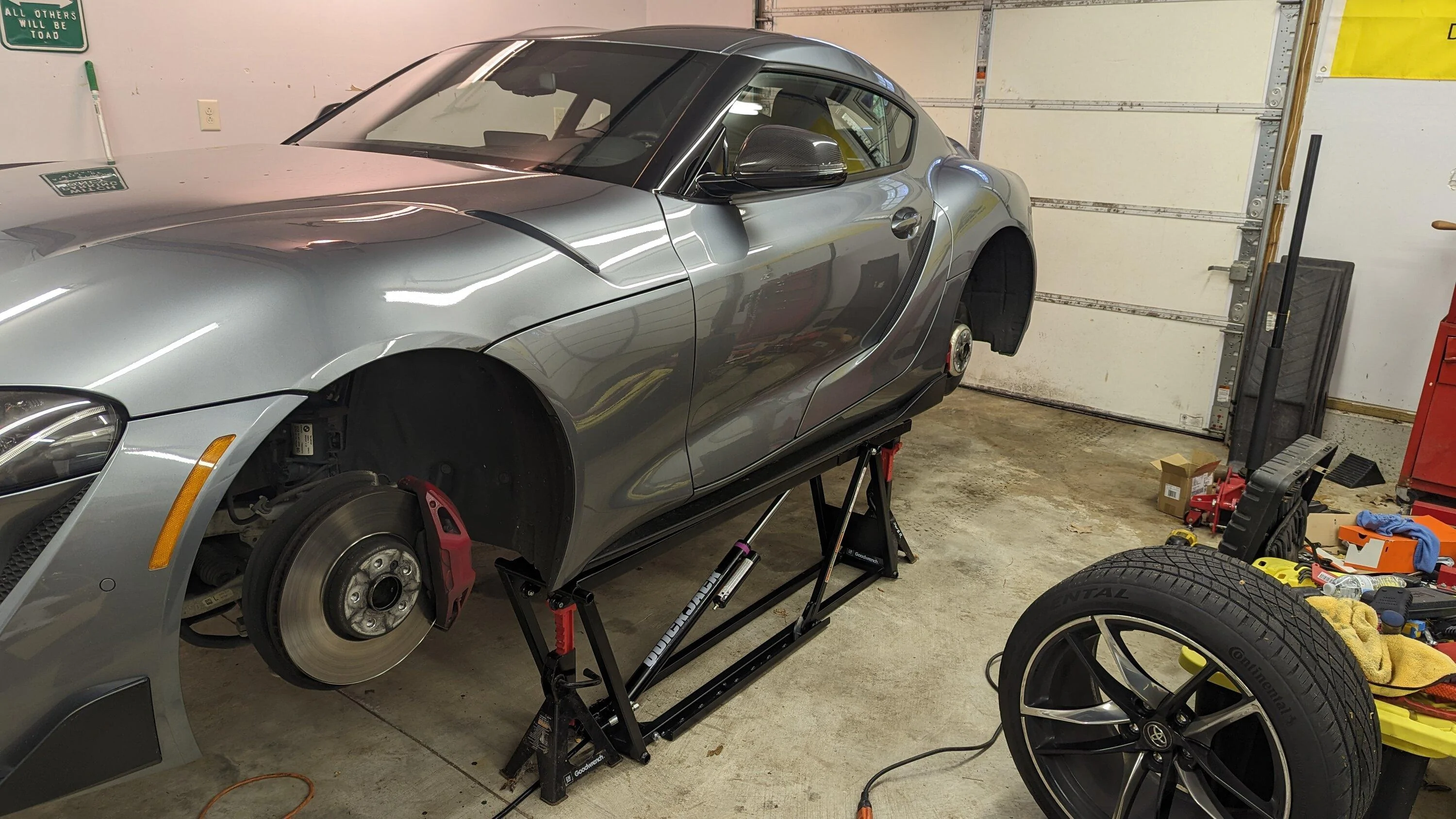

Got my ass in gear to start getting her ready for my first real track day in May.
Lots more work to do tomorrow and next weekend, but it's nice to finally get started on this project.

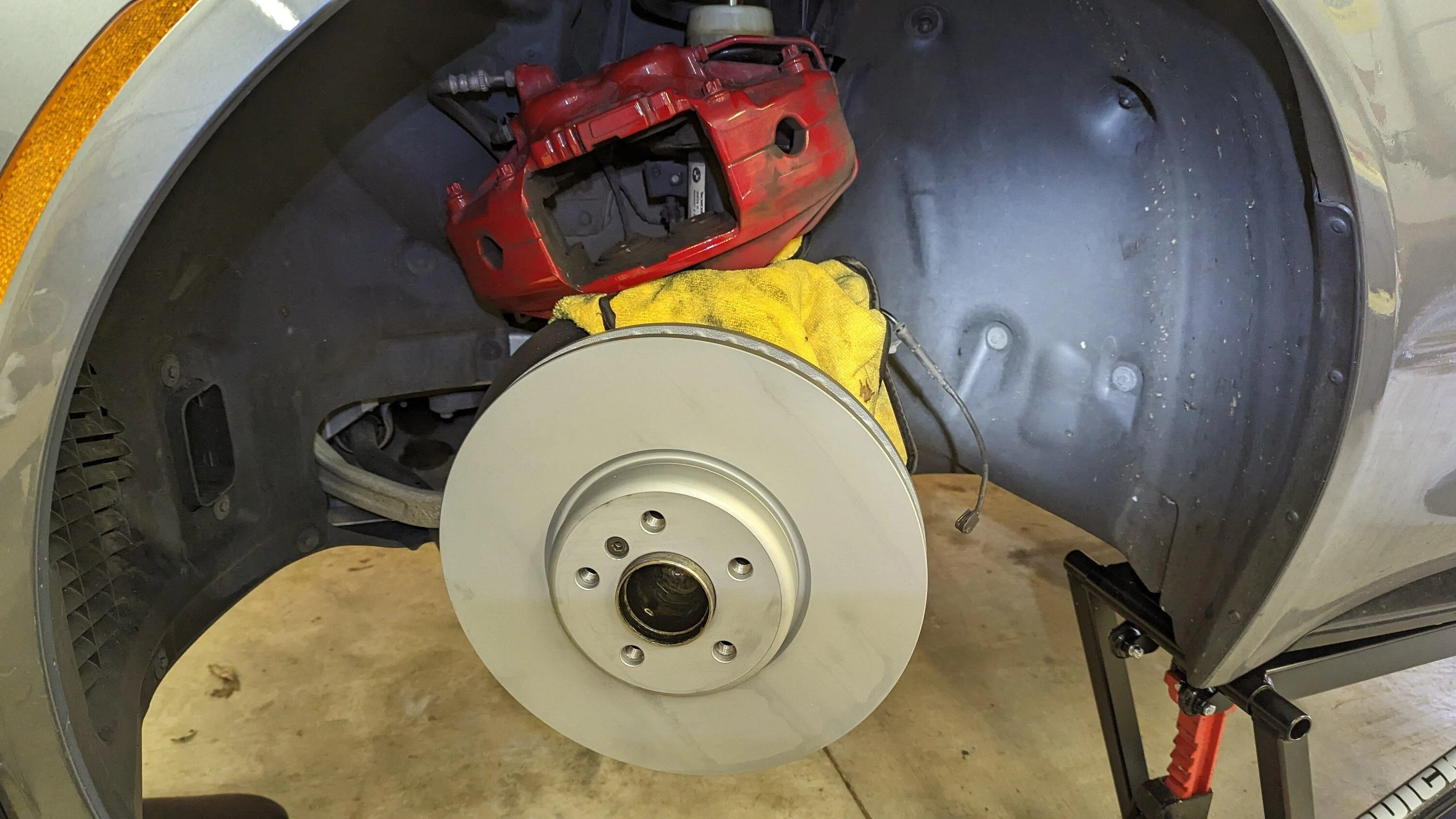

ETA: I got the front and rear pads and rotors changed out. I had some other items I had to assemble for my garage this morning that took up a few hours of my time.
Those front factory pads...wtf BMW? Glueing the pads to the calipers!?
Project Mu pads went in like butter. I'm going to change out the lines to the Goodrich SS, install my front sway bar, and maybe get the rear sway bar in tomorrow. Next weekend is SPL parts and a garage alignment with the Paco Hubstands.
