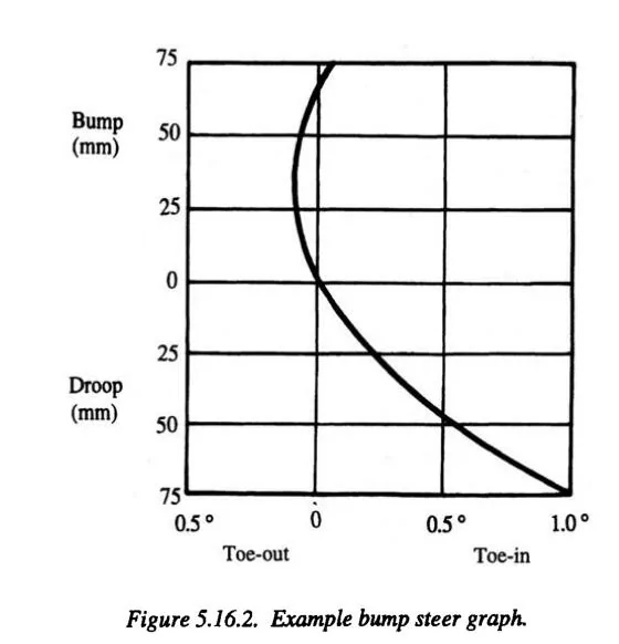

You can absolutely have bump steer in the rear. It's not connected to the steering wheel. It's the act of the car doing unintended "steering" (front or rear) when geo changes radically after disrupting the chassis from say, hitting a bump in the road. Basically, it's a change in the steering angle of the wheel (not the steering wheel) when the wheel is in bump or droop. Example, rear toe changing drastically when at full droop or under compression. Or front toe and rear toe changing drastically under hard braking. Front is at compression, rear is at droop.
That said, once I changed the rear toe and traction arms and put on MCS coilovers, all the oddness went away. I haven't touched the subframe. This is also on a 2020, which seems to have this more than 21+.
You can also tame this a little by just an alignment, if you know what is happening. Example, say, adding extra rear toe in to compensate for the suspension trending towards toe out under compression or droop.

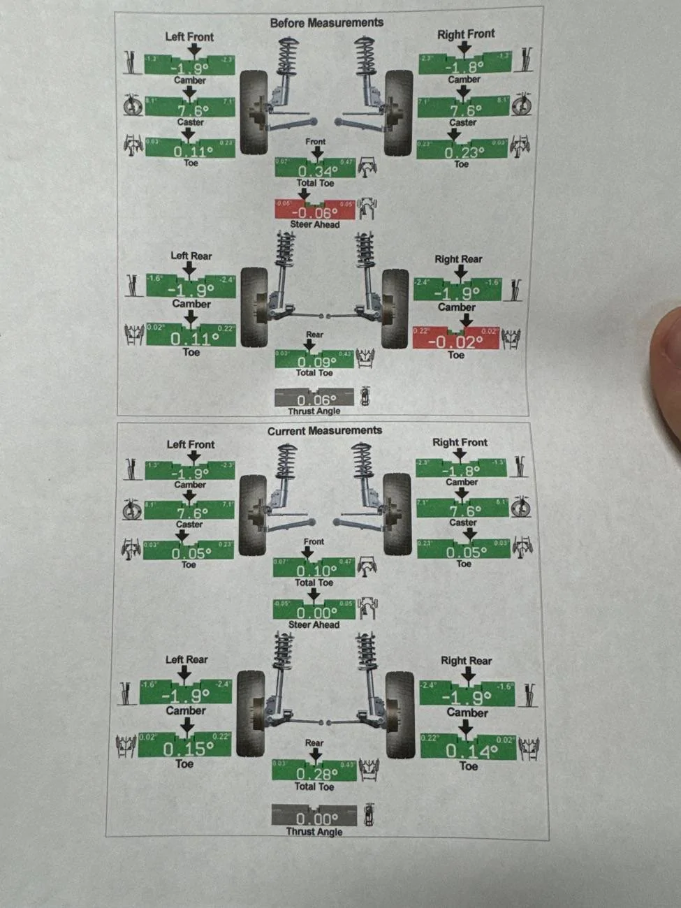

I never had an issue with bump steer but did just get an alignment done on mine finally a couple thousand miles after I got new tires on where I work.
We found that the rear end alignment was a fair amount out of spec and was basically tracking the whole rear end to the right on both rear wheels. Fortunately at the time I hadn't taken it to the track yet so I never really noticed much of an issue. We also adjusted the front toe enough to essentially get it to a point where it was much more flat or better for tire wear up in the front as well.
End results picture of before and after measurements
Also wanted quick add I was at the track this past weekend. Not sure the car could have driven any better except for more seat time/driver mod for myself. I wish I would have gotten two dry days but day 2 was very rainy and I only had part of a session where it was just kind of starting to dry up and then started to rain again.

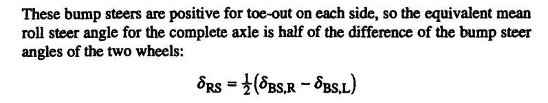

Bump toe can happen front or rear, and that leads to bump steer, front or rear.
There are countless documents on this.

Lowering the car messes up the rear toe curve, ie it changes the way that toe changes through the range of motion of the rear wheel (yes, this is called bump steer - your wheels changing direction under bump)
As @razorlab pointed out, the rear toe and traction arms can be replaced to correct both the toe and toe curve, respectively.
no need to touch the subframe or believe dumb YouTube videos to make a simple geometry change. Also, if you leave your car at oem ride height you won’t really have issues.
