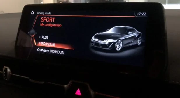

Ok I coded it but I don't think Supra is setup for it. The traction control light should turn on in Sport Plus since its in "traction mode" but it doesn't. So I coded it back to stock. I did eliminate the stability control popup though. Posted in other Coding thread.

S+ is at minimum Sport mode but not configurable, not sure why someone would go back and 'turn it off'. Gives you Sport mode to mess around with. I changed Sport mode to regular suspension and comfort trans so it pops much less
Yes S+ works with Button. Sport 1 press = sport+, sport press 2 = Individual, Sport press 3 = back to comfort.

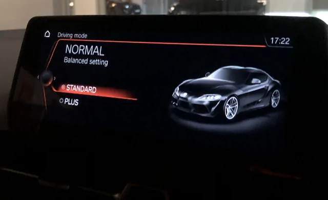

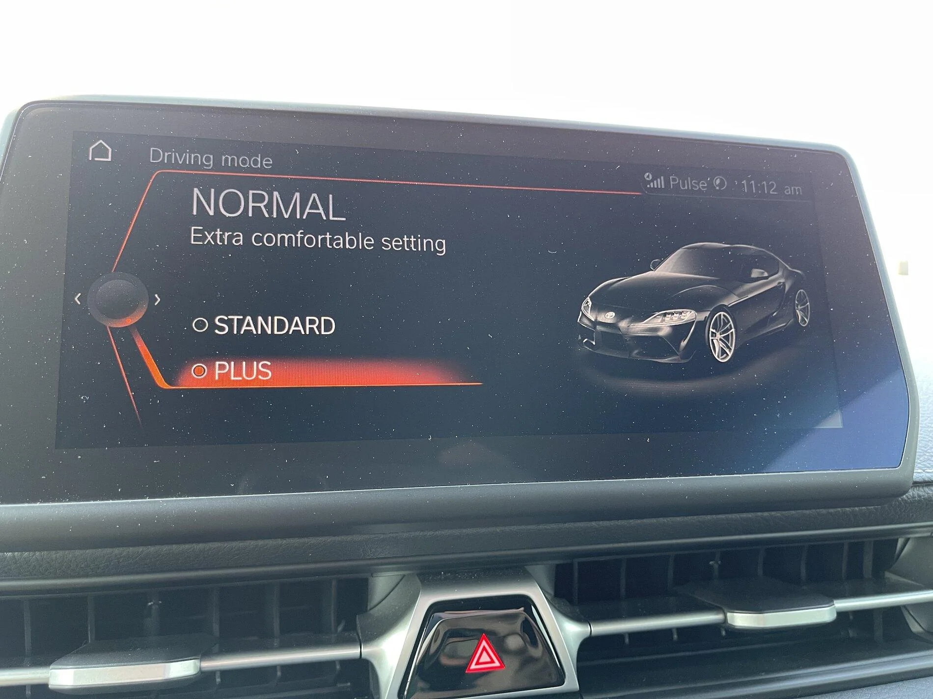

I coded Normal (Comfort) PLUS with similar codes below. I can't say I notice a difference from regular Normal mode. Let me know if you guys try it & feel any difference. I'll be making a video about all these codes but not sure if I'm going to include the comfort plus mode.
FeatureECUMenuSubMenuSetting
NORMAL (Comfort) PLUS ModeBody Domain Controller3221 PfFesMasterFesComfortWorldMode1ComfortPlus
Headunit3008 FESFES_COMFORT_PLUSaktiv
Motorknut
Jul 26, 2020
213
103
NA
2020 GR Supra RZ, BMW G20 gone:BMW F30, E85, E46
I’ve coded both Sport plus and Comfort plus . I can now access Sport plus as a non-configurable mode, and have the additional setting available under Sport individual for engine and transmission.
Sport button toggles between:
  1. Sport plus
  2. Sport individual
  3. Normal (standard)
But I can only access Comfort plus under the Normal menu. The Sport button won’t toggle between Normal sub-modes. Guess it’s labeled “Sport” for a reason!
Comfort plus transmission setup seems similar to my old BMWs normal mode, noticeably how it moves off in 2nd gear. There’s also steering and attenuation coding to be done.

^^^ Same I can only access Comfort Plus through center screen. I didn't notice trans starting in 2nd gear, it was same as Normal. I was hoping suspension would get more compliant but didn't feel a difference.
