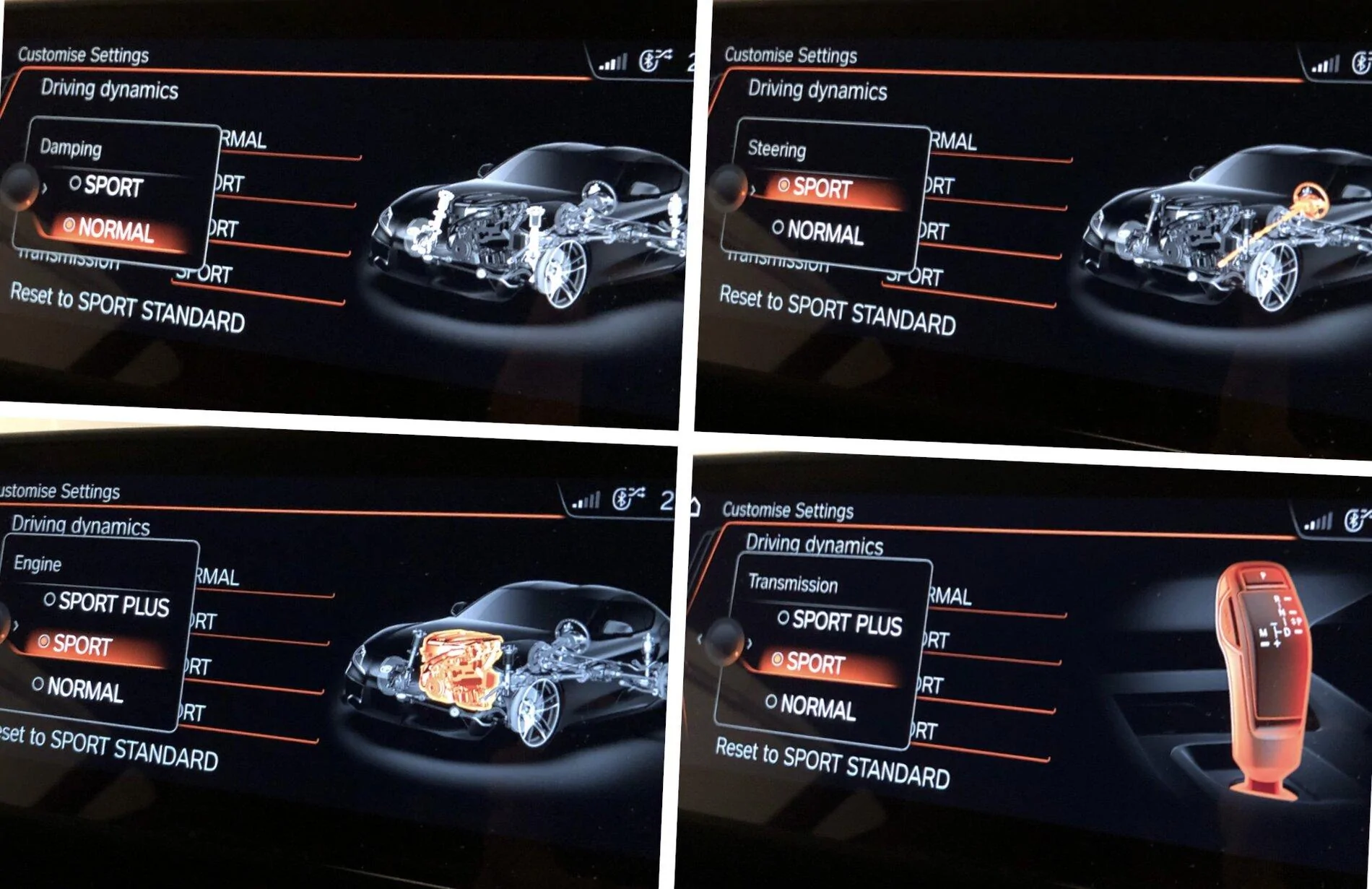

Fascinating, thank you guys for doing all the exploration! I hate how code updates to the head unit always wipes out so many customizations.
To confirm, you guys still only see the added adjustments to individual settings for Engine and Transmission and not steering and suspension.
e.g. steering and suspension only has Normal and Sport selectable modes?

Yeah unfortunately coding the headunit erases your presets & some other things. Correct only Engine & Trans get Sport Plus settings. And no additional settings when Comfort Plus is coded either.
Finally drove mine today and snapped these for reference.

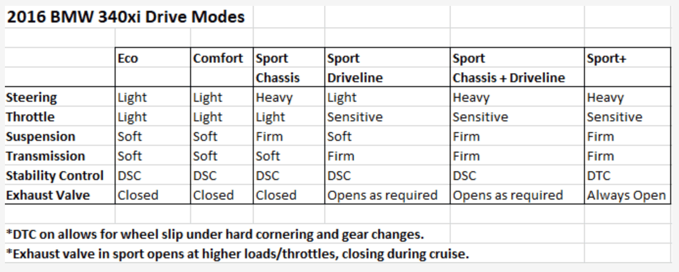

Well, I went out for a quick drive this afternoon to see how Sport Plus differed from Sport.
I was stuck in "weekend leisure drivers" traffic most of the time, so didn't notice much change.
However, I did feel the throttle a bit touchier in Sport Plus than Sport. Also, the gears seem to hang a bit longer in Sport Plus vs Sport.
I like having an additional option as I prefer the heavier steering in Sport mode and configure Individual to 'Normal' for every other setting. Then have Sport Plus as the dedicated Sport mode.
Anyone else notice the same or anything else?
I noticed some BMW guys put this chart together. I wonder if anyone could similarly summarize the different modes in the Supra.

gcmak
Mar 6, 2021
238
260
San Francisco
2021 Supra
I went out on a spirited drive today along with the same traffic you mentioned. I'll +1 your comments.
I did enjoy having the sport mode be Sport+. I thought it would have been too touchy (cause it is in traffic), but actually it's just very lively. I keep all the safety nannies on and they did have to step in a few times, partially due to how sensitive the throttle is - so corner exit I have a harder time modulating the throttle to not give it more beans than I have grip. I'm also still learning the car and can do more testing at Laguna Seca next weekend.
