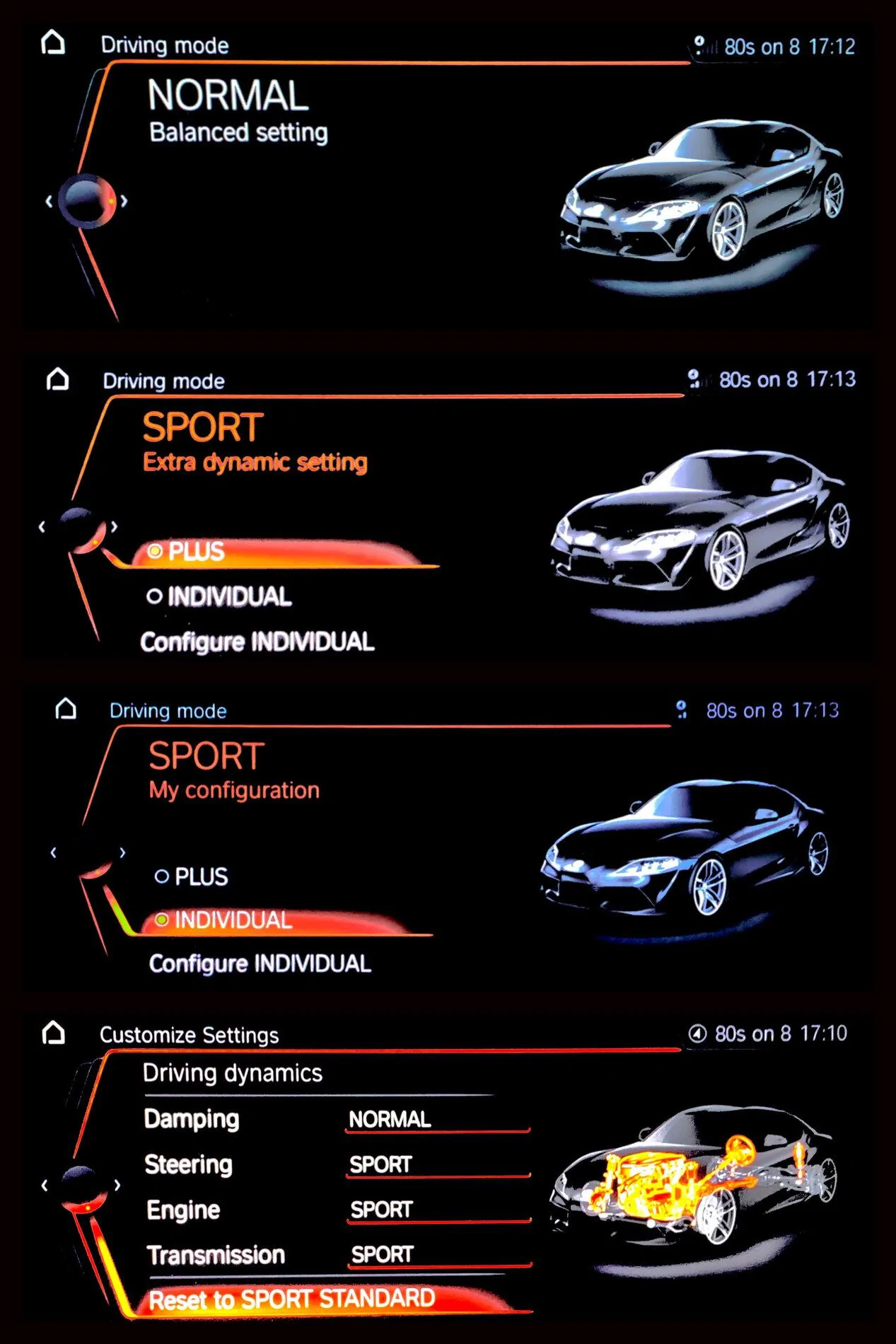

Finally got to go on a longer drive today. Have it configured as the photo attached. The order of which the Sport button is pressed goes from Normal -> Sport Plus -> Sport/Sport Individual.
Normal (default) = everything normal.
Sport Plus (default) = Damping-Sport, Steering-Sport, Engine-Sport Plus, Trans-Sport Plus
Sport/Sport Individual (as I configured) = Damping-Normal, Steering-Sport, Engine-Sport, Trans-Sport
I left the Engine and Trans in Sport rather than Sport Plus as I felt the throttle to be a bit "touchy" and the gearing held a bit too long for daily driving. I would sometimes notice extra pops from the engine in Sport Plus vs Sport, but that may have just been me.
I prefer the Sport steering regardless of setting and the suspension works better in Sport for daily driving anyway.
Anyone else find a good combination to stick with yet?
a90 Paven
Paven
Sep 18, 2020
toronto
2020 supra,
For daily driving I only put the steering and engine in sport and everything else in normal.
