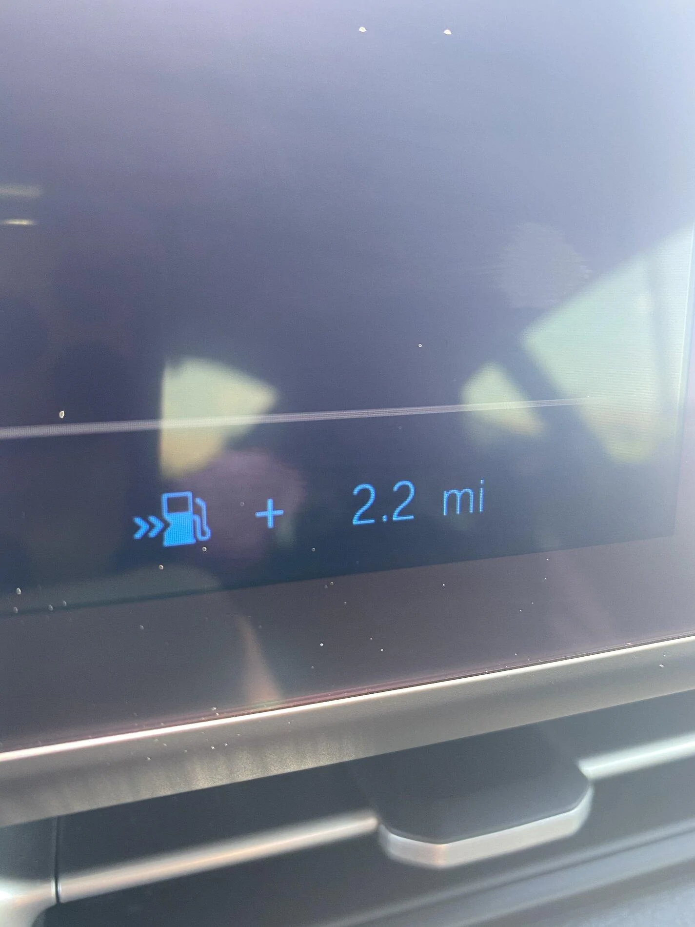

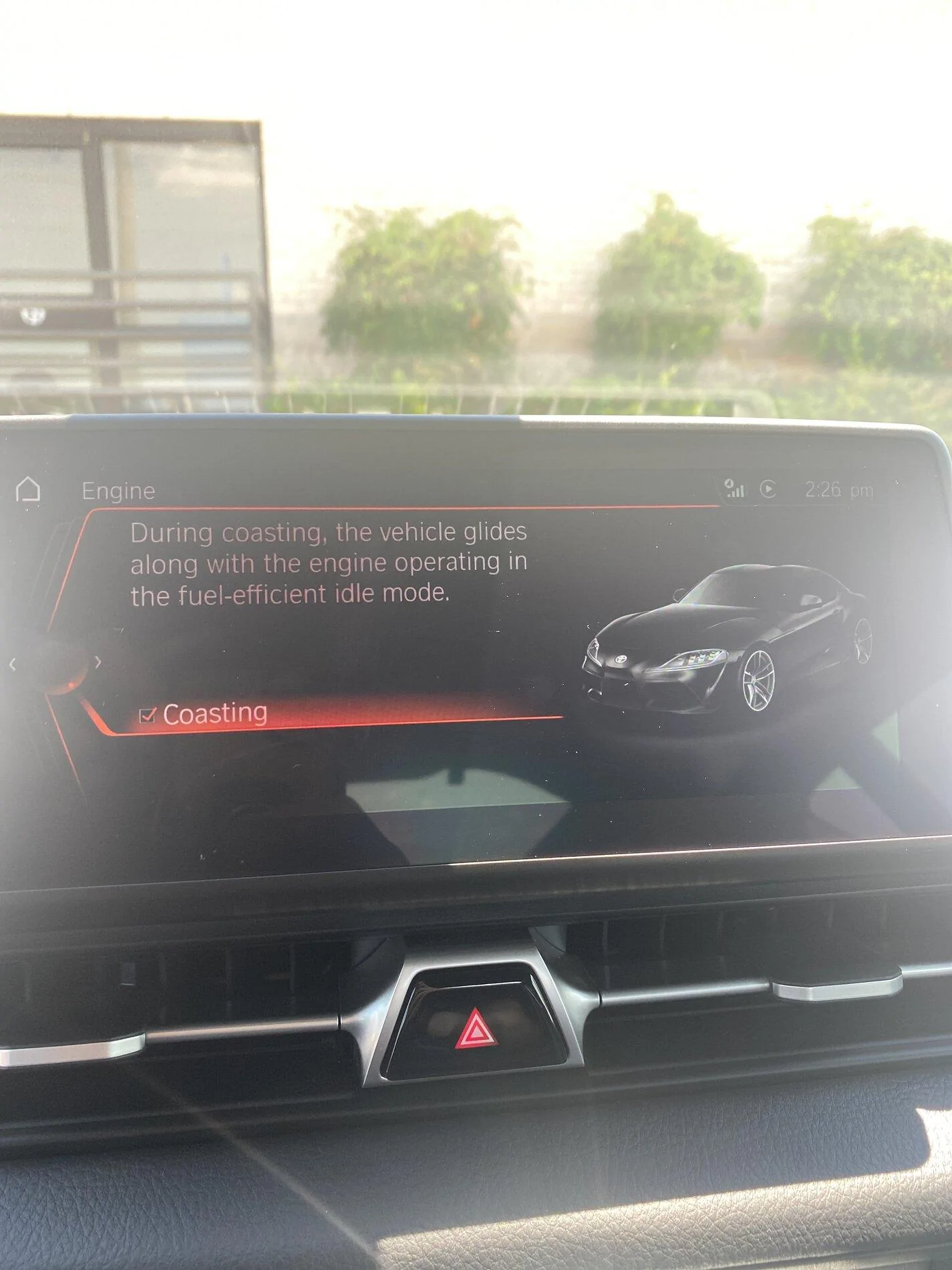

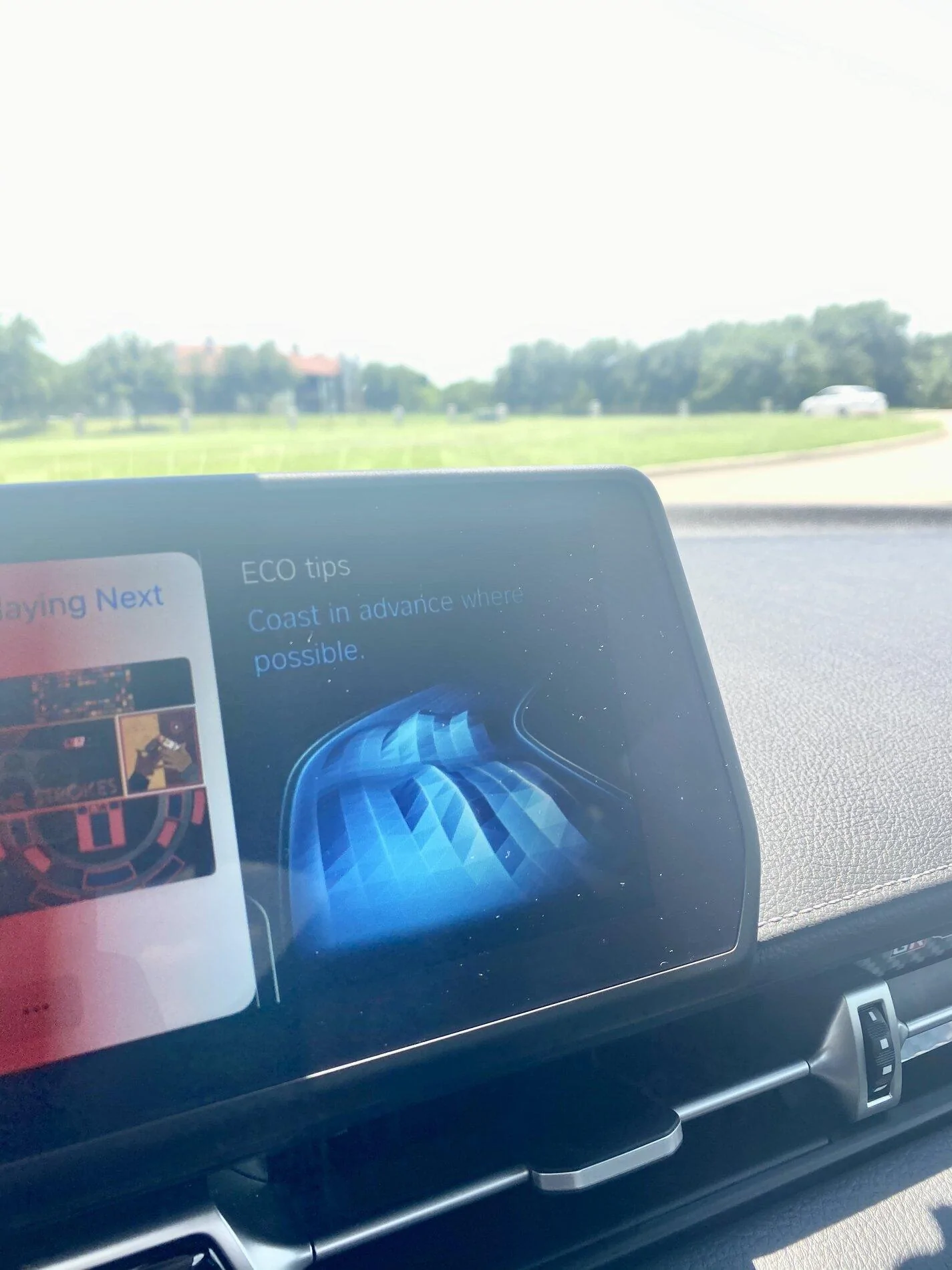

Tried this recently and got it to work. Can definitely feel the coasting/sailing feature at work when off the gas, similar to if you’ve driven anything MT and you’re just rolling in neutral. Maintains the speed your at a lot better vs all the other driving modes which is a plus for highway driving, but you basically have to floor it from a stop to get up to 40. I’m in an area thats pretty busy 24/7 so not that useful to me but maybe for some of y’all who daily highways/backroads! Gives you tips on your driving too with a little indicator showing your overall miles gained.
Can you explain how you did that? And how you choose the Mode? Or its only possible to have this Mode as start option and when you change the Mode while driving than you have to restart the car?
Any news on this one? I tried to enabled it today but seem to be missing a code somewhere. I am able to see the tips and configure eco settings, but when the car is running tips say that they will only work on eco mode.

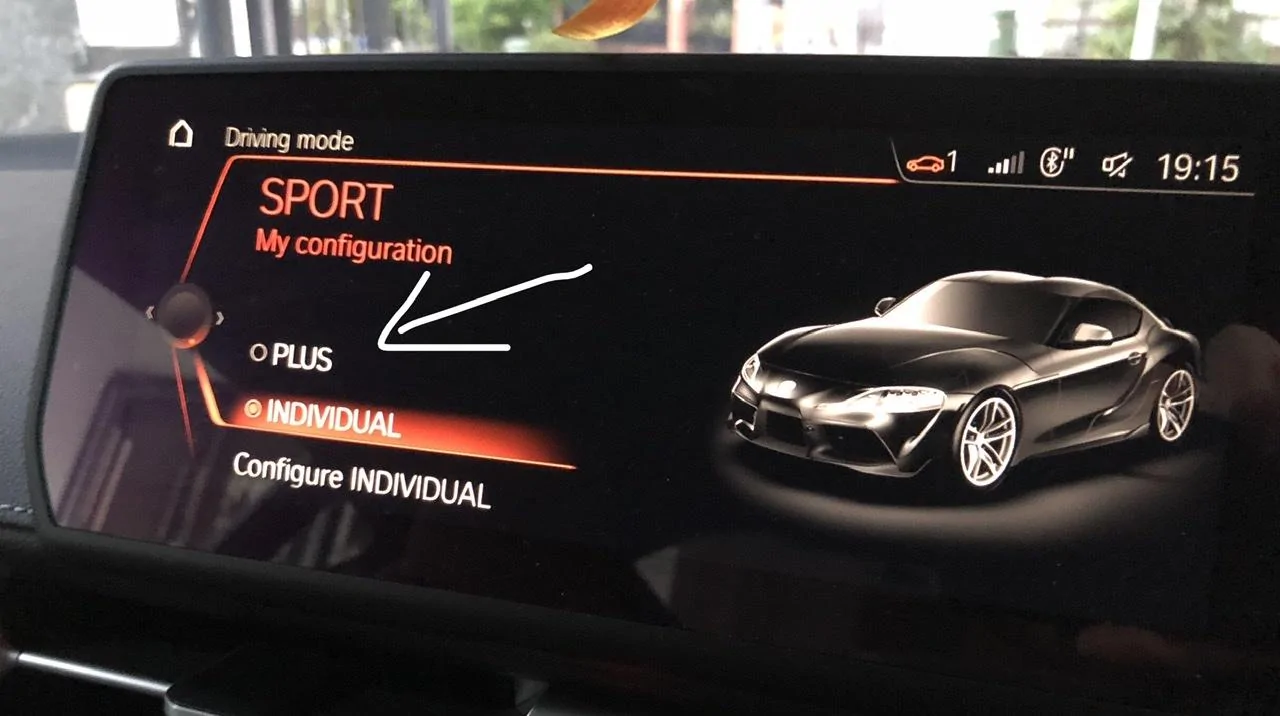

So I’ve been trying to revert my BDC coding to achieve what you described... but I got stuck with the Sport plus profile showing on the screen, but it’s not selectable. (See pic)
sport plus options still available on my sport individual config page.
@Evolution - do you only see “Individual” on your sport mode screen?
I actually drove the Supra to work today so give me a few and I will go take a picture of my screen. I am pretty sure it only says individual on mine though.
