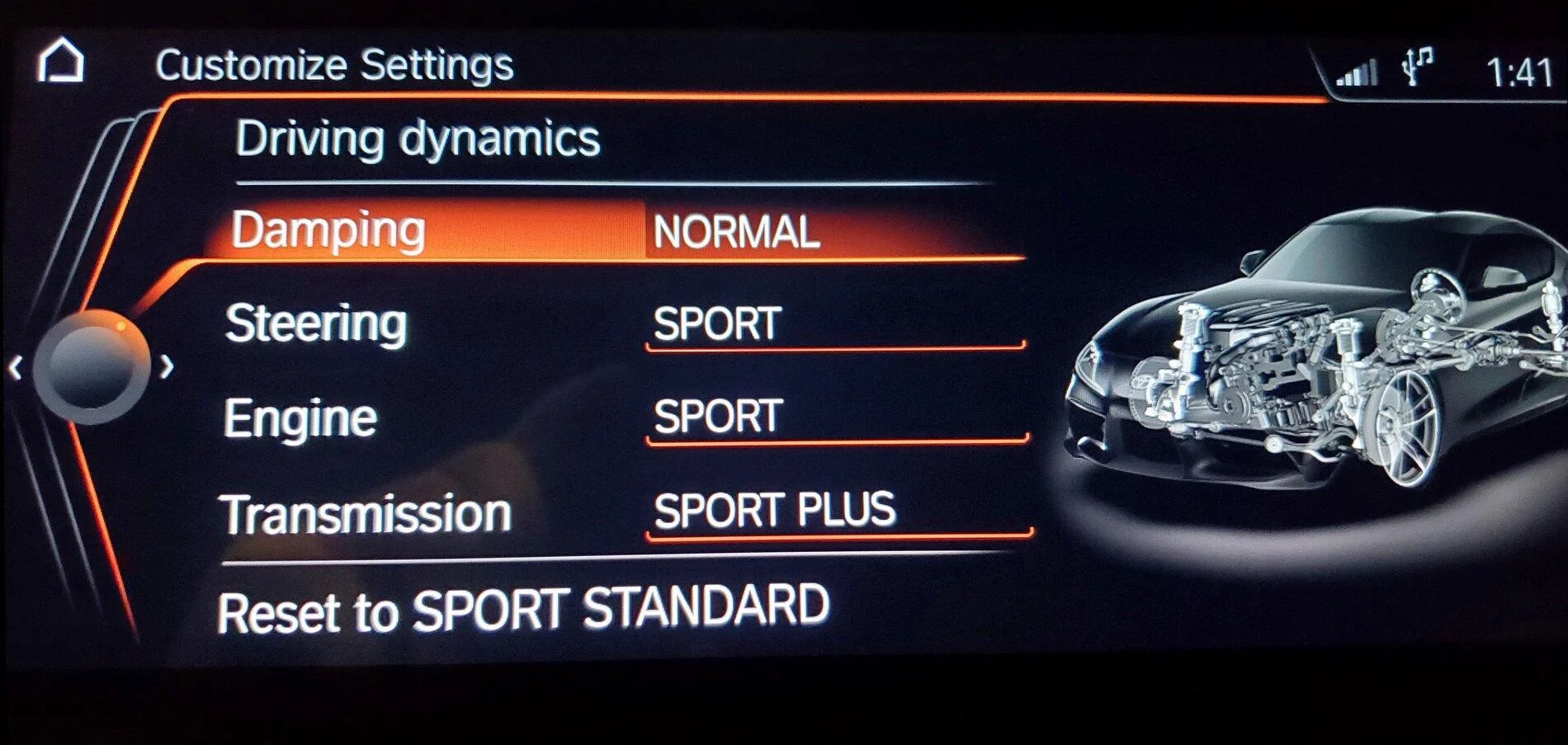

Just got around to doing this after the latest recall wiped all my Bimmercode settings...Spent the morning recoding everything back...
I added Sport Plus and now have the car starting in Sport Individual mode....These settings below seem to work best for me...

Well, I've had a few days with Sport+ mode and here are my impressions:
I don't think Sport+ is practical for those who like to use cruise control often as it remains / hangs longer in lower gears and really sucks up gas! And honestly, I find the throttle response to be a bit too sensitive to my liking...
Example: On a 20 mile trip I averaged 22.5mpg in Sport+ Mode...On the same 20 mile trip in Normal Mode I averaged 35mpg.. I did this just out of curiosity and was not surprised!
I did end up changing driving dynamic settings such that my car starts up in "Sport Individual" mode and I have "Damping" and "Transmission" set to "Normal" and have "Steering" and "Engine" set to "Sport"...
Sport+ is fun if your driving around town though!
That's exactly how I have mine set up and it's a great compromise between responsiveness and efficiency IMO. I agree on Sport+ as far as fun as well. It may not be much different than the default sport settings, but if you're going to burn the gas and put some wear on the thing anyway... might as well turn it to eleven! :thumbsup:
