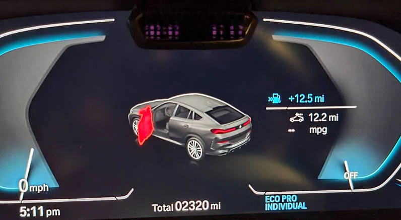

I have ECO Pro on my new vehicle. Does exactly what this article says and what @rotary heart mentioned:
https://www.bmw-me.com/en/topics/fascination-bmw/efficient-dynamics/energy-management.html
There's a superficial gauge that shows how much it's saving compared to normal mode. In junction with adaptive/active cruise control, it does wonders to fuel economy. I've not reset the trip gauge to see how much mpg on a route I'm saving, but the Eco gauge shows savings over the lifetime.
If you're DD'ing Supra and not always pushing it to the limits, you can surely benefit from this.

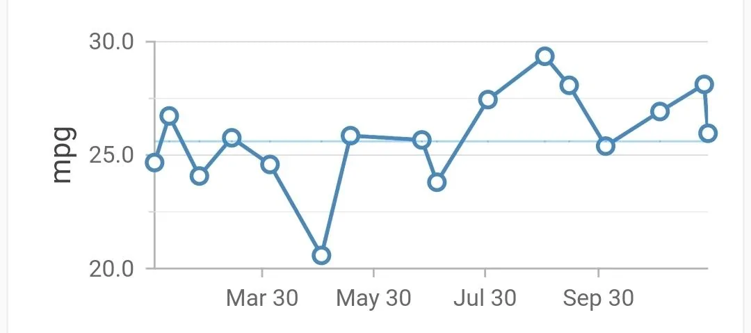

Just as how @XtremeMaC said, I'm using eco pro on start. On the iDrive I have all the eco settings turned on. But I have dampening and steering on normal. You can definitely feel the difference and my fuel efficiency has improved a lot, here you can see the data of when I turned it on, (Ignoring the track day there)
