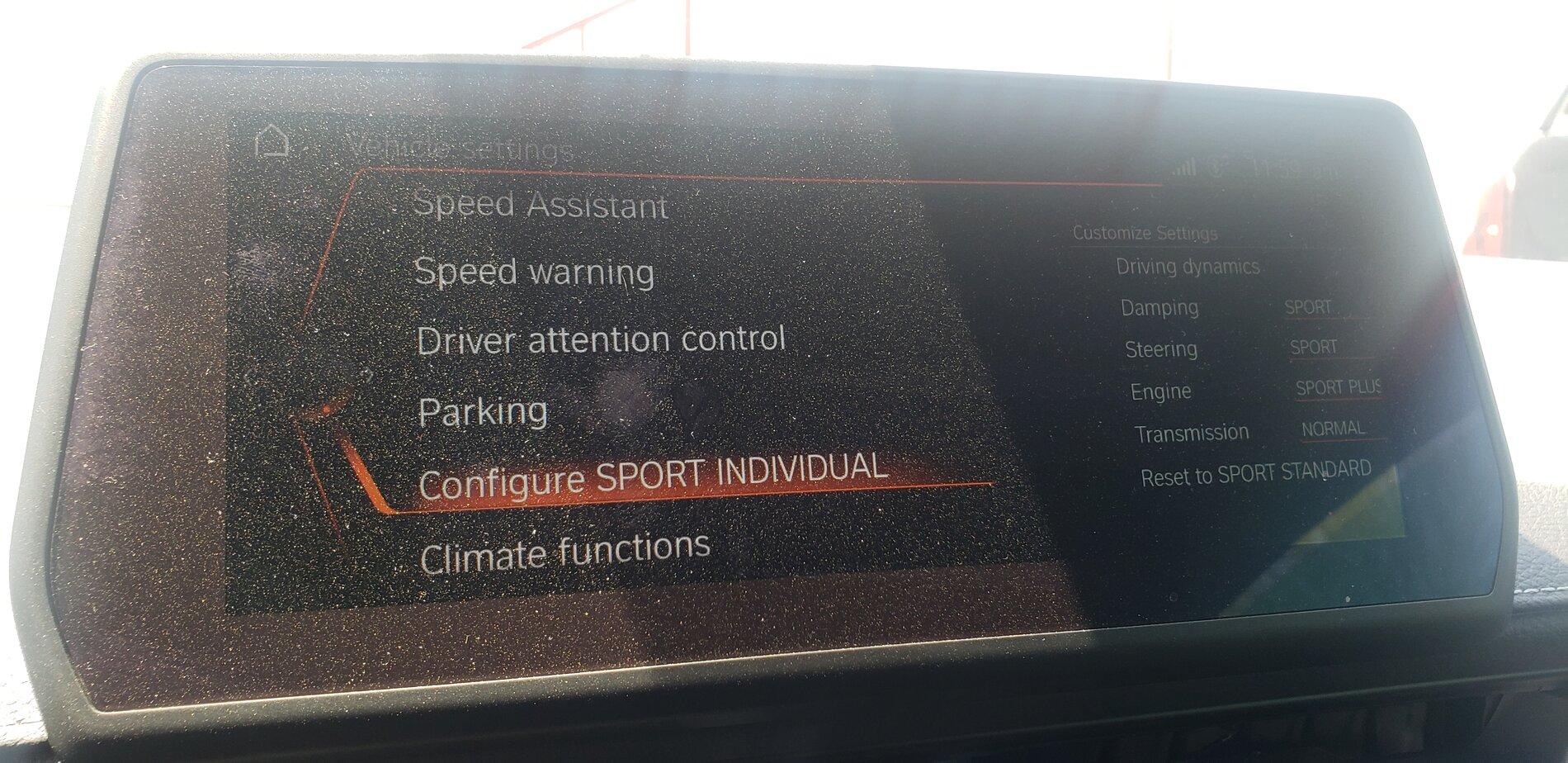

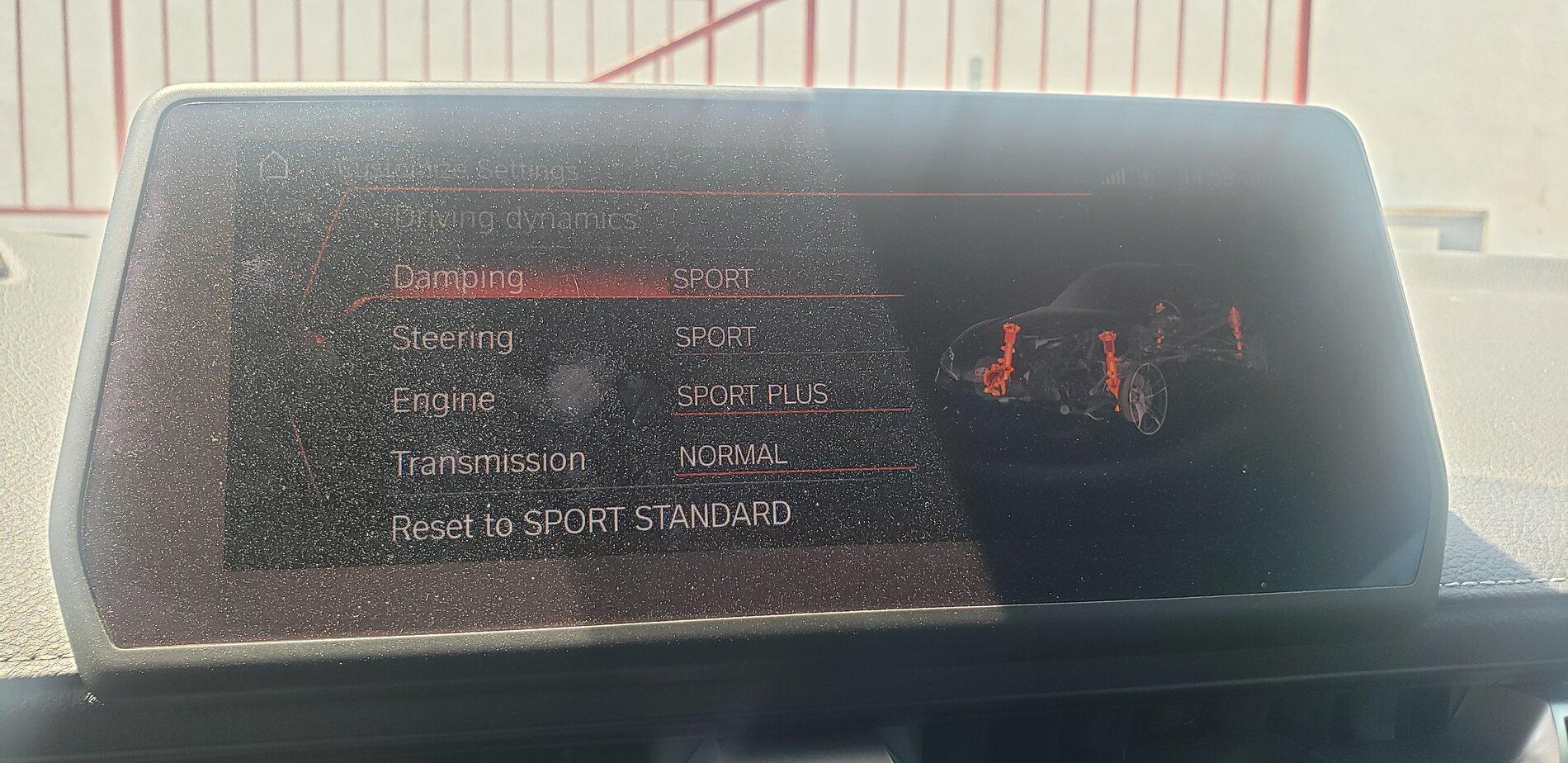

@Motorknut
I cant even find that same screen you have. If I go to my vehicle, then to configure sport mode, it goes right to the menu where you can select each individual mode for the trans, engine, suspension....
From this screen
To this

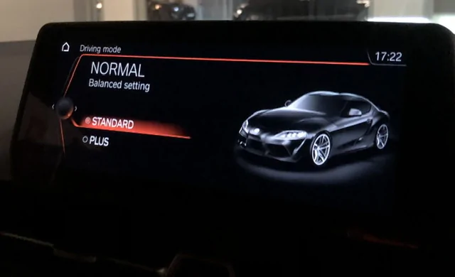

@Evolution - if you coded in both options there should be two changes... one being what you show in your pics (options for engine and trans under sport custom).
The second change should be three options when you push the sport button - normal, sport custom and sport +. Depending on the other options it may be a different order... for example I have mine coded to always start in sport custom... so one push of the sport button puts it in normal mode, and the second goes to sport+, and a third would go back to sport custom.
You can also enable eco modes which show up as Normal+ (or Balanced+) I believe, but I don't think they do anything on our cars.
As near as I can tell the difference between the plus modes is just a little bit more of peak holding of gears and a bit more burbling... maybe it shifts slightly harder (faster) as well, but since it shifts so fast already it's impossible for a human to tell the difference.

oh that’s odd - when I hit the sport button, I get the sport individual screen I posted. Second consecutive press puts me back into normal , and the screen also changes to display that
but I recall that this screen can be disabled. For my car, it’s enabled by default. Note that I’ve enabled comfort plus, so I have the additional comfort mode shown in the pic.

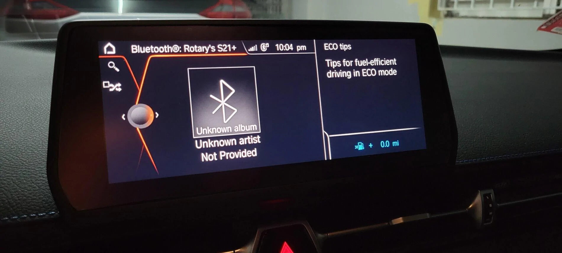

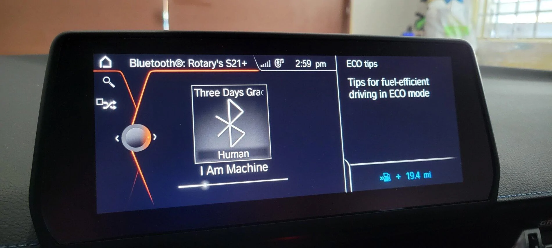

Any news on this one? I tried to enabled it today but seem to be missing a code somewhere. I am able to see the tips and configure eco settings, but when the car is running tips say that they will only work on eco mode.
Seems like I've finally activated it! I will be testing it out tomorrow, I wish I could tell what exact setting I had to activate, but I just went through all the BDC FesMaster eco options and kept testing different settings. I think that the one that worked was eco mode 0 to 3 setup to use eco. (Enabling eco pro/plus/etc) and finally setting the car to start in eco pro individual.
My previous eco tips just said that they are only available in eco mode

Well, to end up the thread hijack I can confirm that it is working perfectly. Went to a 125m trip and you can totally feel the difference. Really good to have this option for those family rides.
