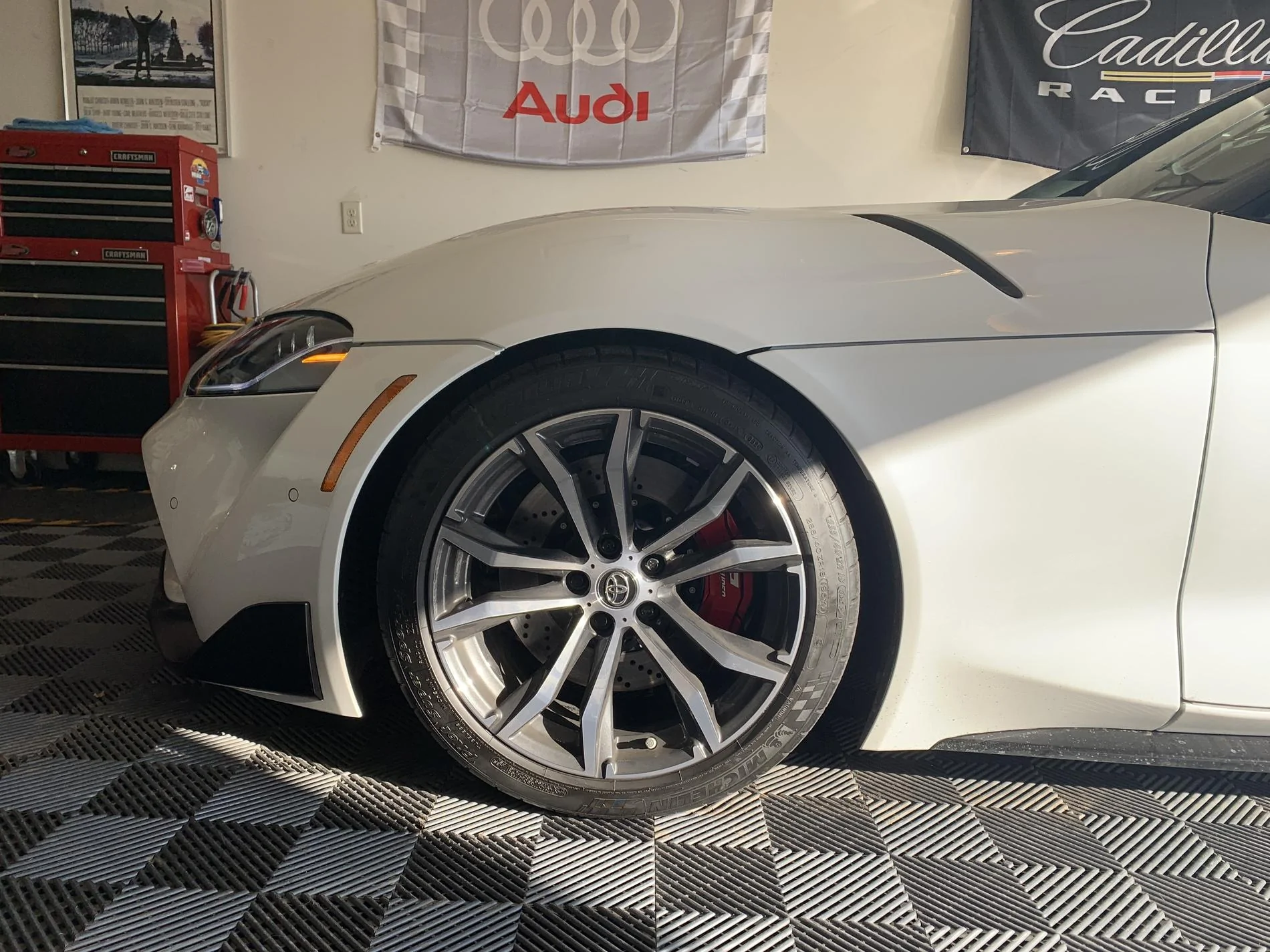

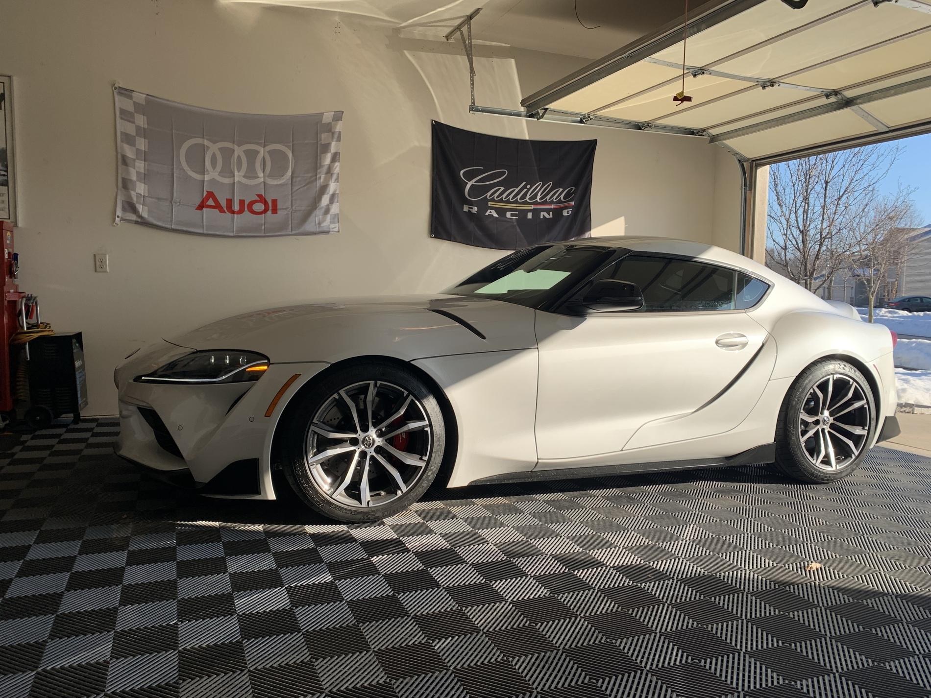

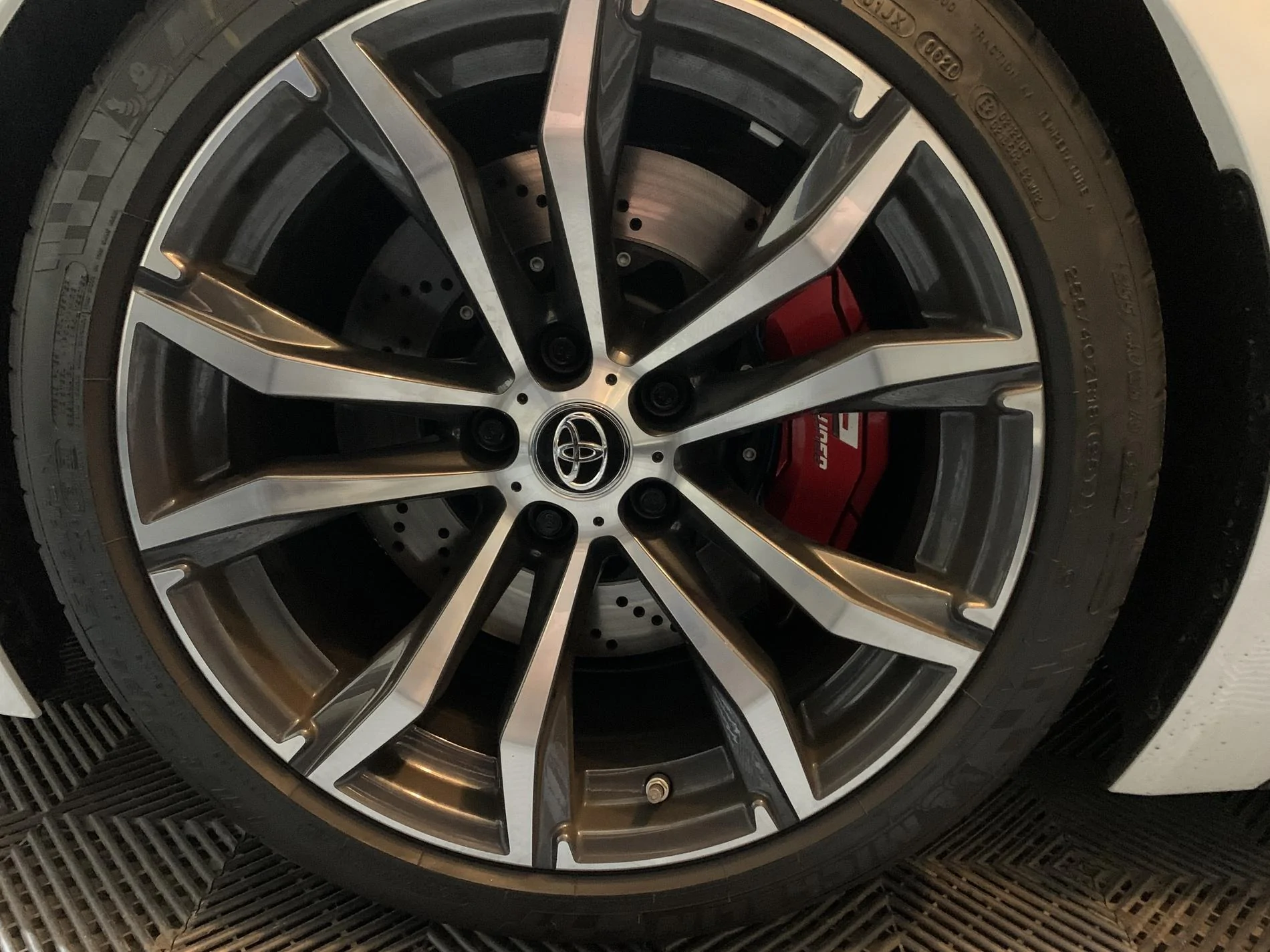

Not the greatest pics but whatever...
Got the car back from the shop. I had the following items installed;
- P2uned BBK
- H&R Lowering Springs
- SPL Endlinks
- SPL Traction Bars
- Function Werk Catless Downpipe
- Alignment

Lowers Front approx. 1.0", Rear approx. 0.75"
Looks better when you're standing next to the car.

- The new P2uned brakes bite far better than the stock single piston versions.
- The weight difference is most likely going to be negligible between the 2.0 US versions and the P2uned BBK. I still have to weigh the OEM stuff, but I'll post up once I do. I had too many spare parts to take with me and it all wouldn't fit in The Supra.
- Springs have all but eliminated the body roll
- The catless DP (even without a tune) has provided a noticeable bump in; throttle response, spool time, mid and upper HP increase (according to butt dyno). **Surprisingly still no CEL even after at least 20 key cycles and over 150 miles driven**
- Traction bars have eliminated bump steer....but I also haven't launched the car or driven too aggressively yet. Temps and roads here are still too cold.
- Yes, still mainly a garage queen...Probably my slowest one to date.
