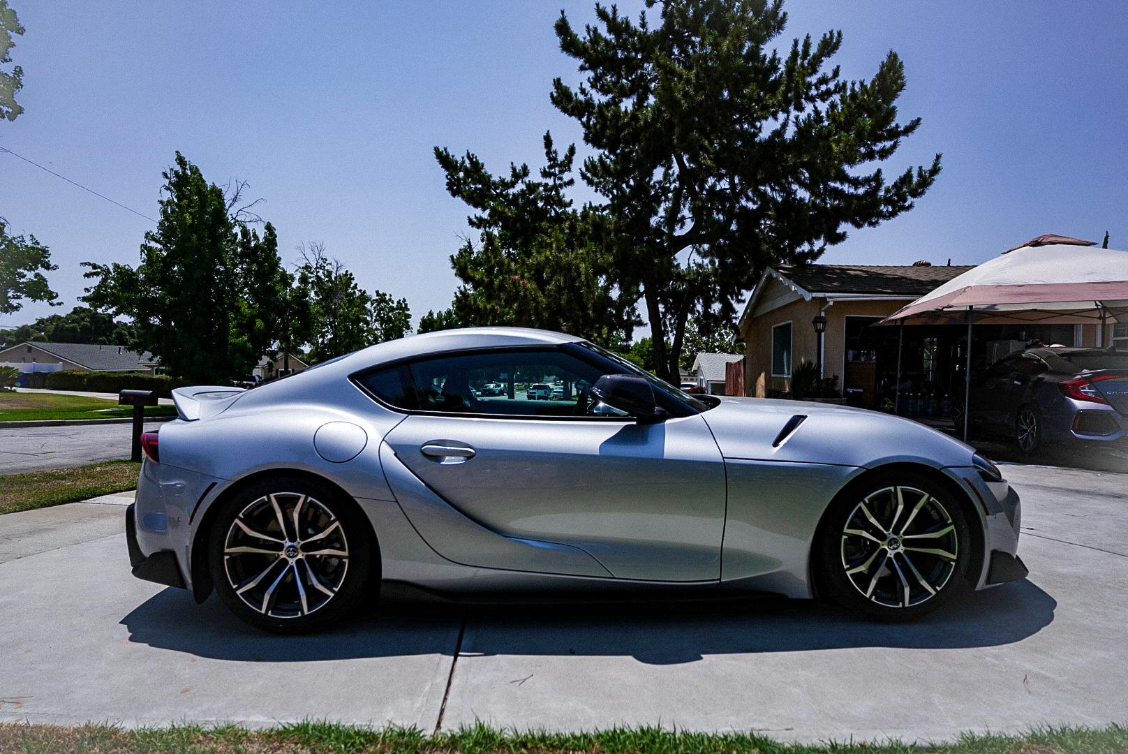

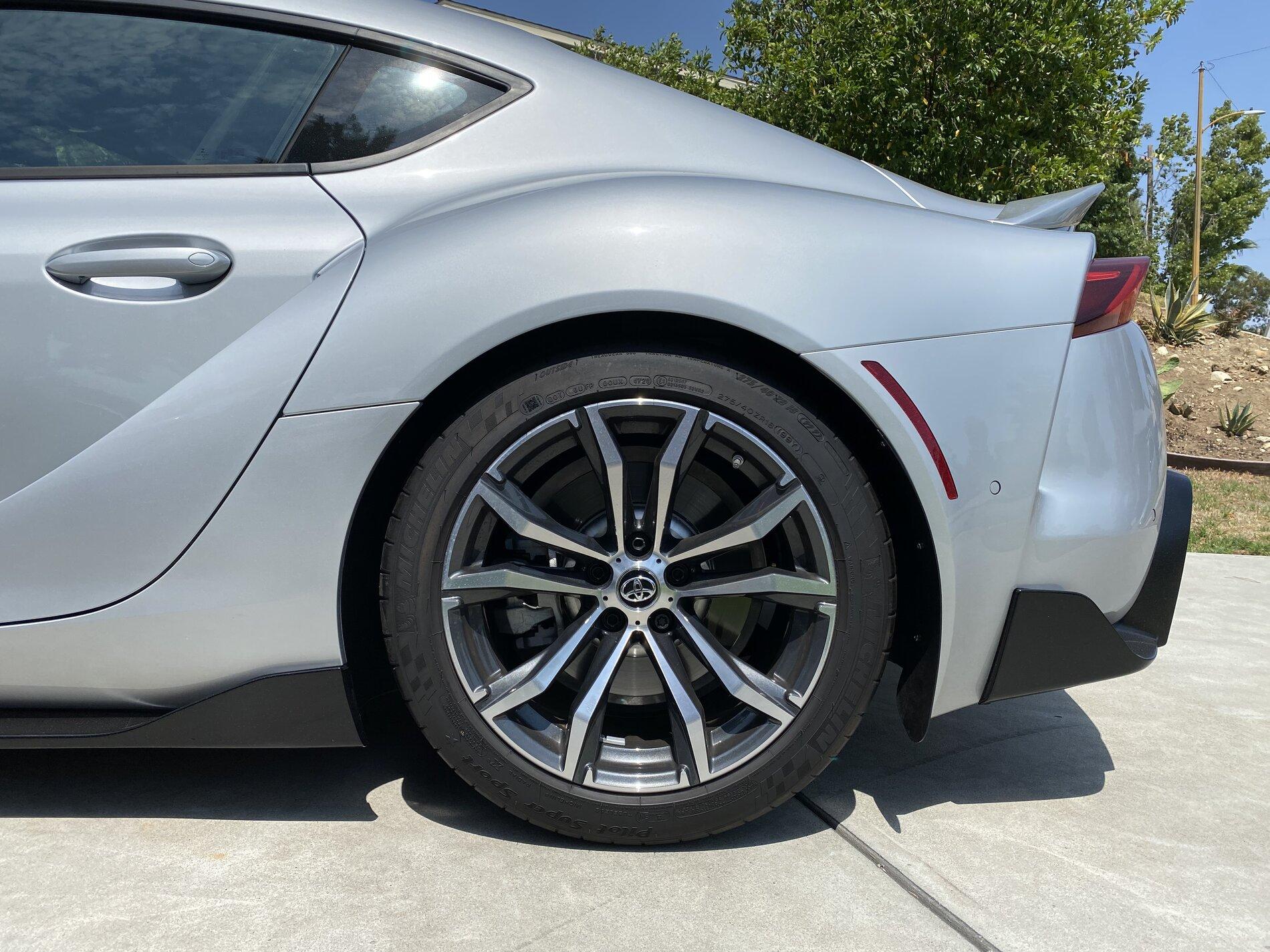

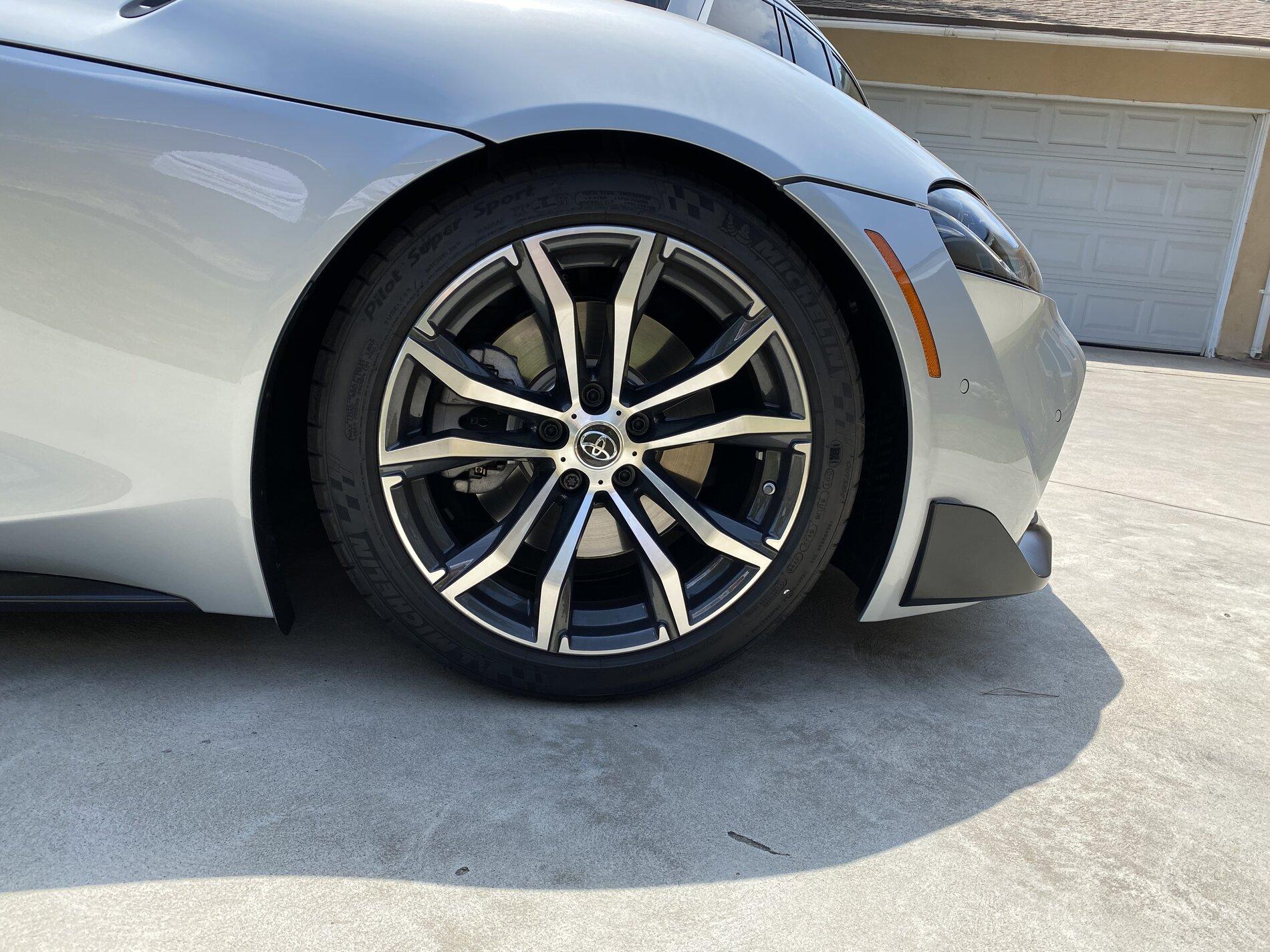

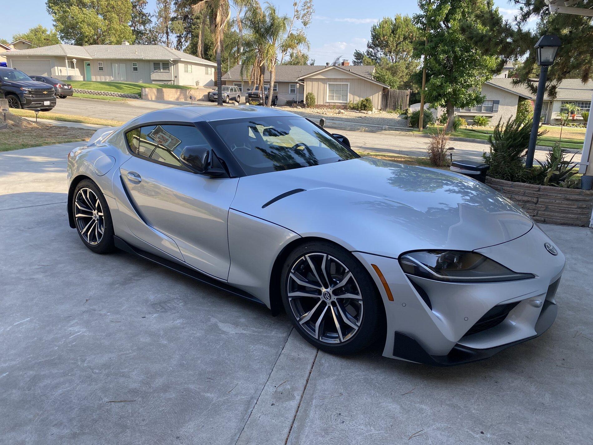

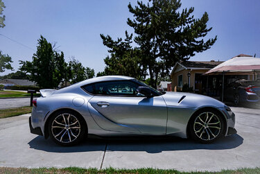

do you have any photos of how much lower you have it? Not sure if you know the amount drop. I was gonna get BC as a cheaper option, but it said minimum drop was 2 inches and I didn’t want the car to be slammed at bare minimum so it bottoms out at track days or what not
Here are some pics. The rear is pretty much maxed out but the front still has a lot of adjustability up and down.
back is maxed as in its max low or that’s max up? It doesn’t look as low as I thought it was going to be. I’d maybe like to up the back a little bit more than you have. But front looks pretty good and knowing it’s adjustable from there up or down is good. Putting wider tires in the back so I just don’t want to rub.
