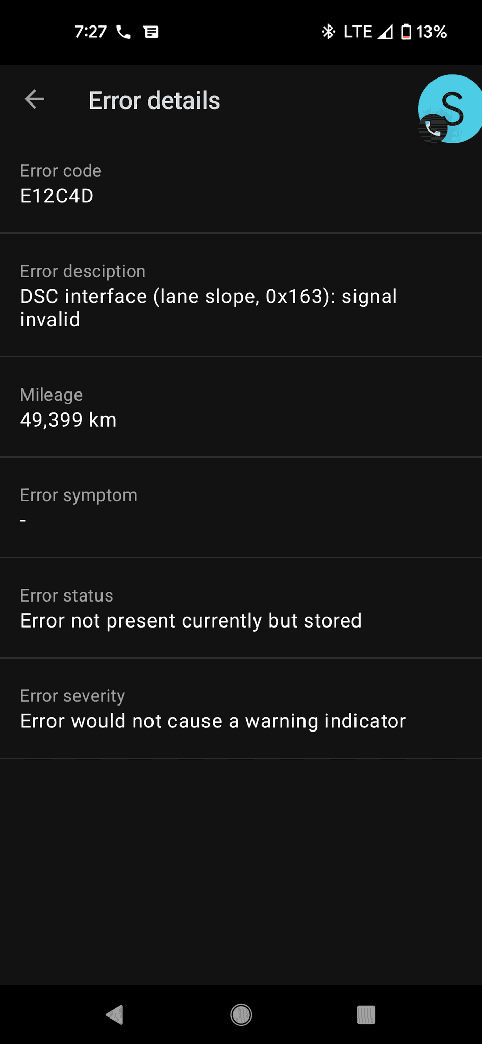

Hey all, I don't have a solution but I believe I was able to find some progressive evidence. I have also occasionally had throttle hesitation/limp mode/no response, whatever you want to call it. Always from a complete stop, never in the middle of driving, usually on some kind of hill or grade.
I had this happen on my car yesterday while pulling out of my house, immediately stopped and pulled error codes via BimmerLink.
What I found was this error: E12C4D
"DSC interface (lane slope, 0x163): signal invalid"
To me, this says the Yaw sensor was freaking out for some reason and the car cut throttle as a result. This would be a normal response if say, the car flipped over. Here the car seems to not know it's orientation for a bit and defaults to disabling input. Not entirely sure what would cause the sensor go awry or how to resolve this, but definitely a starting point. Screenshot of my error attached
