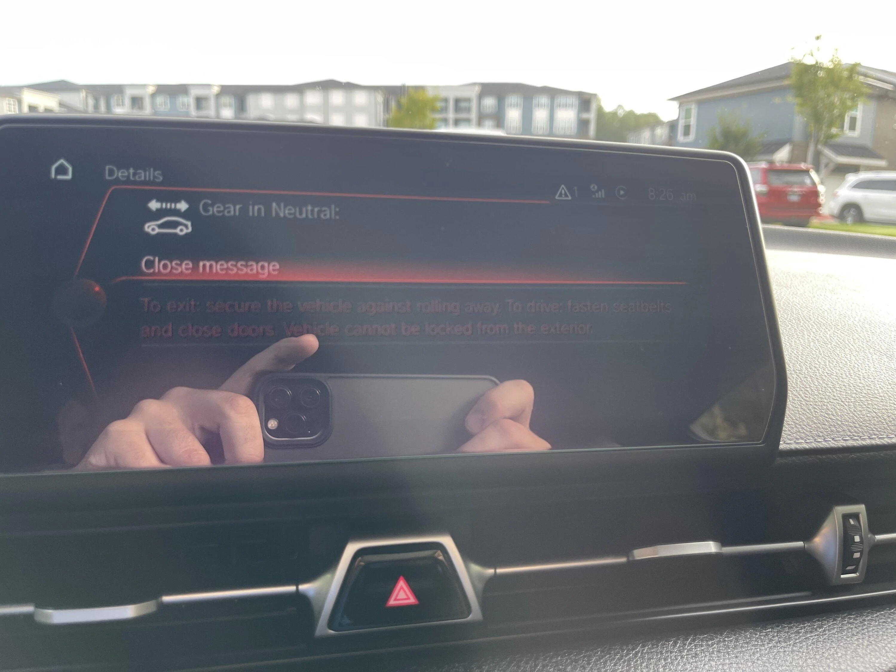

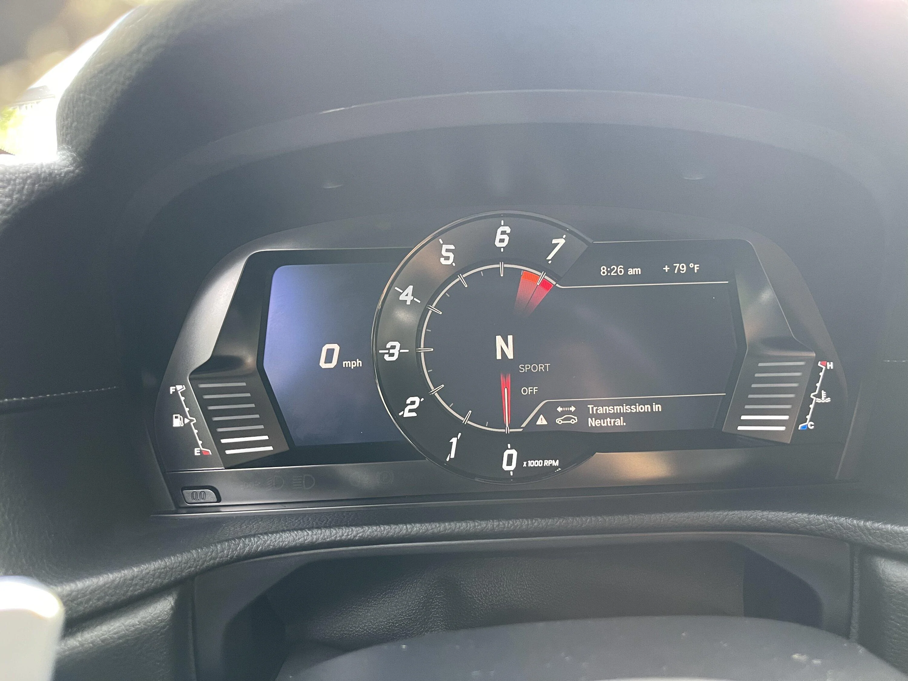

Started the car up this morning and waited for the rpm’s to drop before pulling out. As soon as I was pulling out the car started shaking and stalled and went into neutral. Started the car up again and tried again to pull and the car was about to stall again until I gave it gas. As soon as I was about to pull into traffic the car didn’t wanna go until I kept giving it gas, after that it worked fine.
Do an italian tune up on your car... lol. but yeah that doesn't sound fun. sorry to hear. keep us posted!
Was TC on or off?

Turn TC off at startup. Don’t forget to turn it on later. Let us know how it goes.
