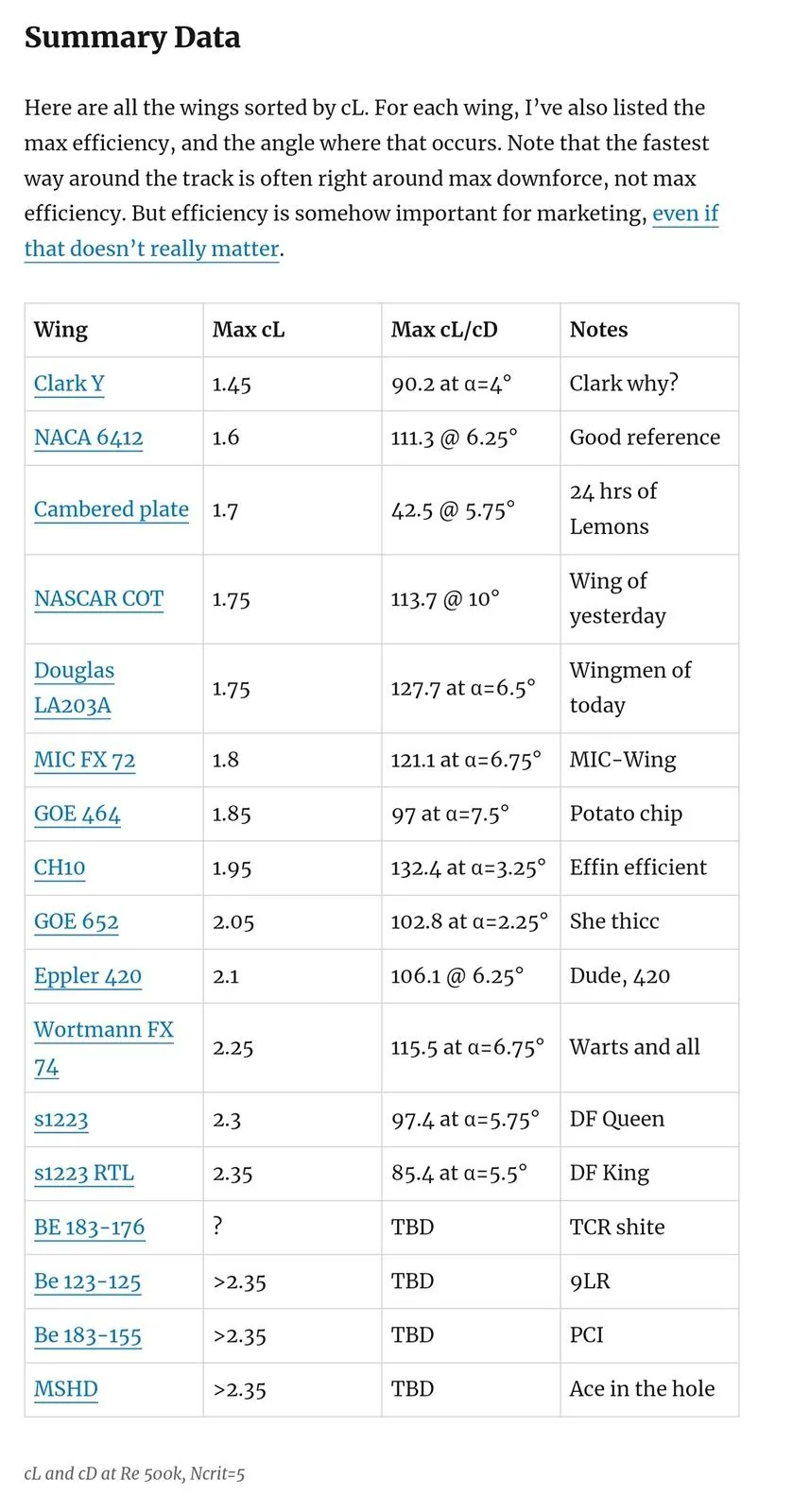

the v1x lift coefficient confusion thickens. i double checked occams racers blog post on motorsports wings and only a handful of motorsports airfoils are able to crack 2.3 CL. two of which I've already mentioned, the s1223 and the 9LR wang.
https://occamsracers.com/2023/08/08/car-wings-examined/

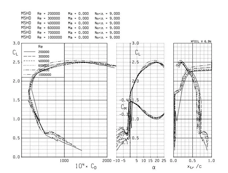

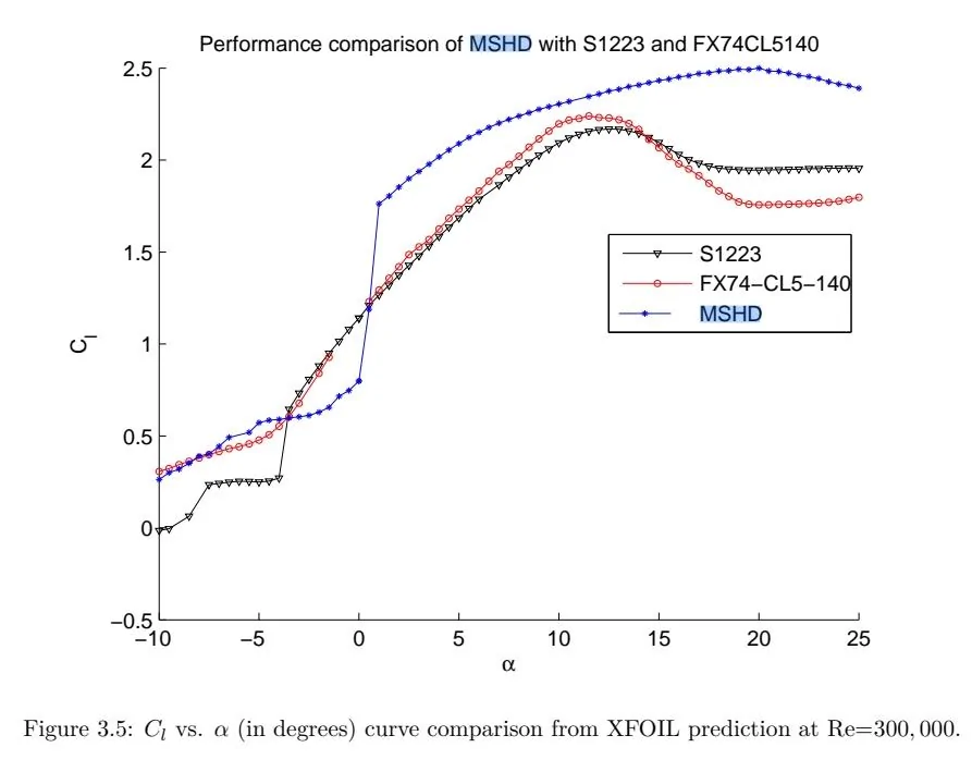

The top performer, the MSHD, was some guys masters thesis and he could only BARELY get this profile to crack 2.5.

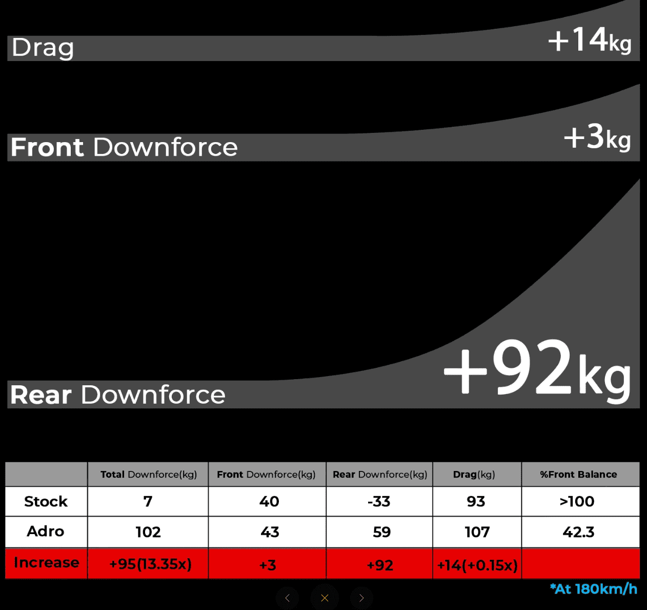

I found some data on ADRO's wing (it's one of the last pictures in their gallery).
According to their own CFD data, it's actually only 203 lbf (92kg) @ 110~ mph.
This seems to contradict their description stating over 250 lbf @ 110 mph.

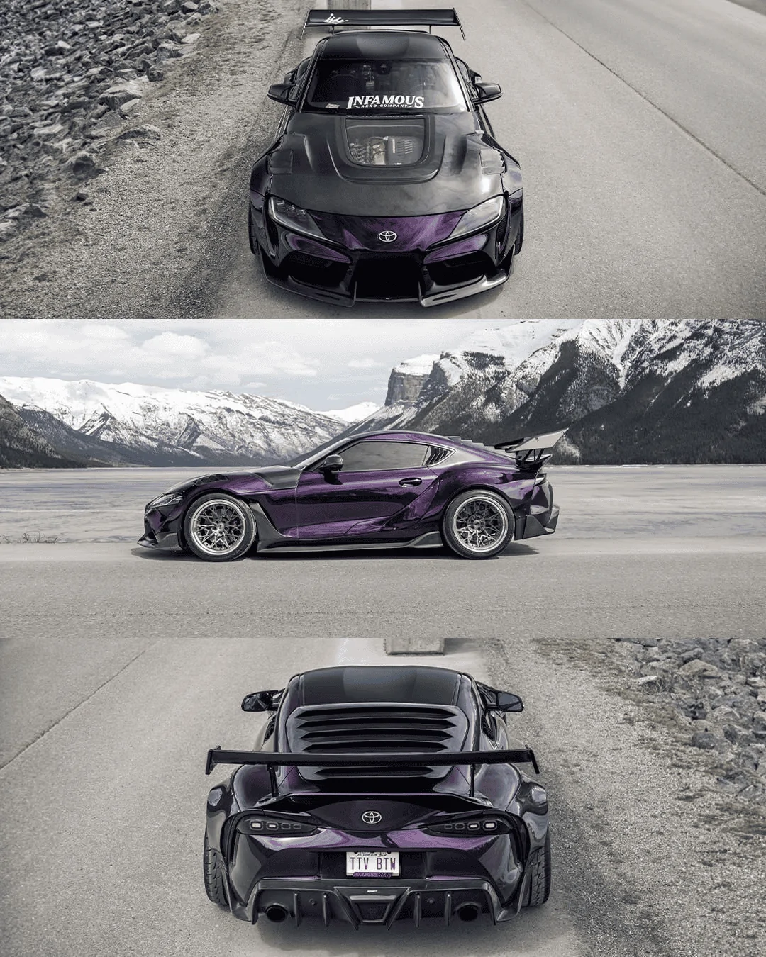

Where are my fellow big wangers at???
I am running a 326 wing with custom wing stands that fit underneath a Infamous Ghost Tail duckbill spoiler
It is loud and not for everybody ?
ty @outxlove for telling me about the wing, hope u dont hate me for not being slammed <3
